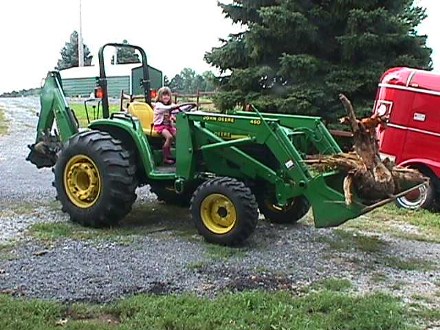

Here's the real stump puller.

How did you know that's what I had? Don't why I ask as you know everything!!! Mean that good. It's the original one that Sony came out with John, the digital mavica 10x model # MVC-FD7. I originally bought it so I could take pics of my x-rays and send to the radiologist via email. He could give me an answer in 5 minutes as to whether or not there was an abnormality. I've since bought a better one for that and use this one for all of my other stuff. I've had it a long time now and not one problem.
   / Removing Stumps #30
Never underestimate the power of a little girl! It takes you hours with the backhoe and a FEL to move that stump - but she can wrap you round her little finger in an instant!!!
Nice picture.
Patrick
