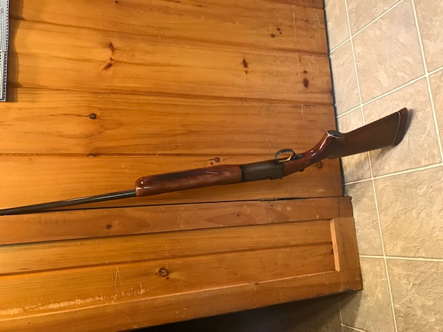

I just purchased two older firearms that have surface rust.. I'm thinking a copper sponge and oil will remove the rust. Anyone else have a better idea?
1960's Western Auto 107A 22mag (Mossberg made), it's a nail driver.
1973 Winchester 37A 410 made in Ontario, beautiful wood and receiver scrolling.

I don’t know if this is actually better but I would let the metal surfaces soak for a day in Kroil ( or something similar ) and then lightly go over with scotch brite
(p/n 7445 the white pad which is equivalent to 0000 steel wool). There are several grades of scotch brite; only use “white” on fine finishes.

Use fine steel wool and either: PBlaster, Kroil, Rem Oil, or best Birchwood Casey Barricade (formerly Sheath). Use that last one for storage. It's really quite the same as a developer we use after cold-bluing, such as DuraCoat Post Treatment Solution. Scotch Brite will scratch chrome (silicon carbide grit :eek:) We 'card' between applications of cold blue after rinsing with steel wool each time. Use what won't scratch what's left of original bluing. ;)
I bought a Marlin 336 that looked like it lost a pillow fight with a burlap sack full of cinnamon. I've got pics of before & after, but they're on a chip & I should upload. (Will sooner on request.) Didn't have to touch up bluing just smooth & seal the surface. Mistakes can be made when experimenting. We've eliminated that for you, why you asked, right?
It doesn't need reblued, just cleaned up. KISS ;) t o g

So I went ahead and used the copper sponge and rem oil, it took most of the rust off, then I took a copper brush to the scrolling and got most of it nice and clean, I was very careful, looks decent.. I have some ot 4 but I was afraid of scratching.. Oiled everything up, looks good..

Uh, both vinegar and phosphoric acid will remove bluing, the Phosphoric acid almost instantly. :eek: It's an ingredient we use to remove rust and bluing before a complete re-do. Blueing is a stain-like residue from an etching process. Acids in general will etch that away more quickly that we can restore it. (I use three brands of cold blue, but results are consistent.)
I concur with everything said in the linked Brownell's video. (fine steel wool and oil, don't overdo it, .. I could have spoke up for that sooner. ;))
