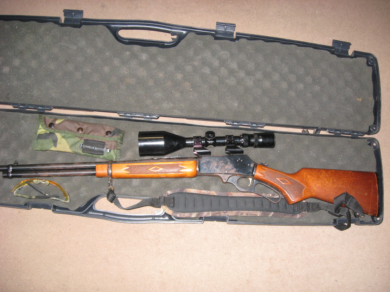

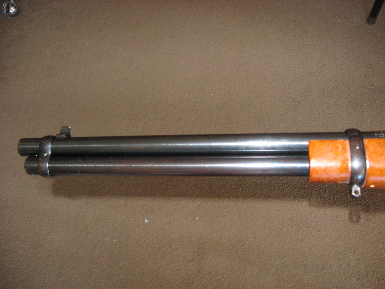

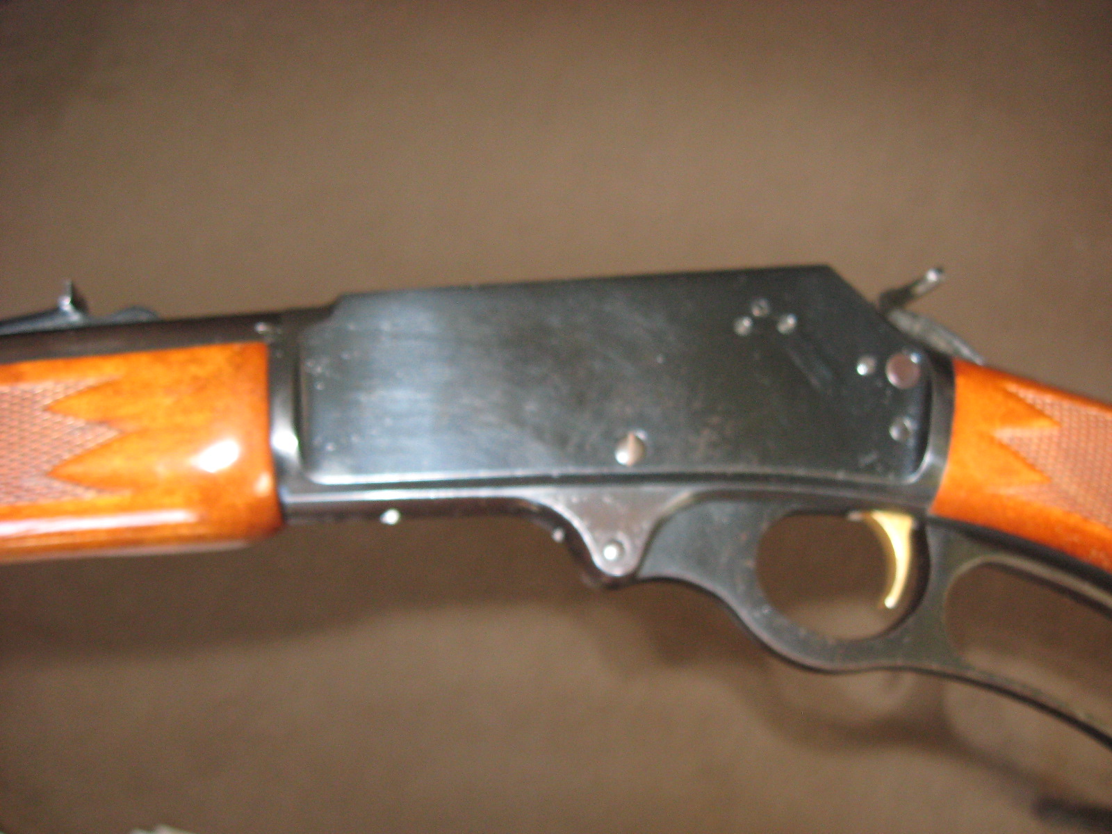

I wrecked one pretty good when I was 15, didn't want to do that again.. I could get a little more rust off but it looks good and I'll keep it oiled up and away from humidity..

Looks decent, it's tough to get it all off without wrecking it in the process, This 410 Winchester didn't look that bad so I able to do it with the copper sponge and rem oil.. I'm happy with the outcome.
