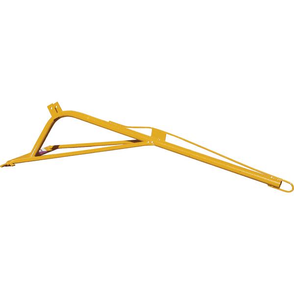

If you a have a boom pole and a piece of chain or nylon pulling strap...works good, last long time.
/ Removing t posts #36
Yep, that'll work... same idea as the yoke for a PHD... such a device has numerous uses.
One benefit over using an attachment right at the 3ph is that the lift is vertical for a longer time..longer arc... so less sideways pressure and more straight up pressure...
Let us know how water helps in your situation, jimg.
That's exactly how I do it with my home made boom pole. It can pull out 6" wooden post buried in the ground for 40 years with ease. T-post is much easier.
