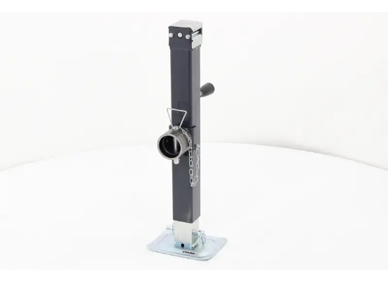

Pretty sure 7-8k are way overkill, but they have the right "heavy duty" look to them to match the rest of the trailer, and the price difference isn't large between the wimpy looking (but sufficient) 2-3k units and a 7-8k unit (factor of two in price perhaps).
I'm thinking of using a swivel mount jack, with two mounts - one for when the jack is needed, right up by the tongue, and one where the jack will be more out of the way for "travel"/trailer-in-use.
This bulldog unit has a drop leg, so you can get a bunch of extension just by pulling a pin and extending it, and then crank the last bit - useful when the mount is about 35" off the ground in the first place. It goes from (bracket height) ~13" to 41":
(https://www.etrailer.com/Trailer-Jack/Bulldog/BD190758.html)
It's "only" 5K, but the entire water tank is squarely over the axle and doesn't figure into the tongue weight - unless you're pointed downhill, then you get some of it. Still, 5K of lift capacity is significant overkill (and the static capacity is greater yet - 8K). This is the bulldog brand so should be pretty solid.

I really like that swing away two position design, especially for off road trailers.
Do you have the M149A2, with the stainless tank?
