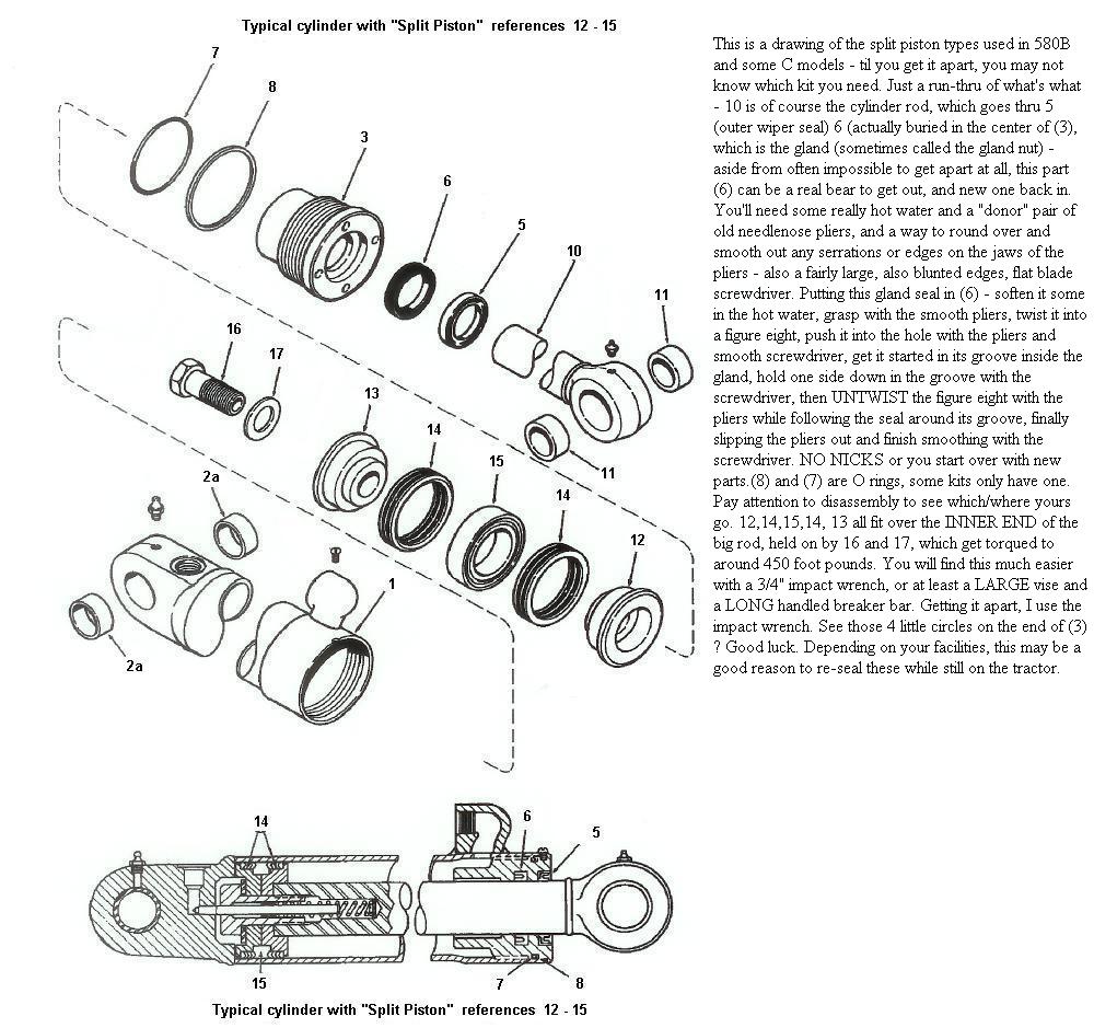

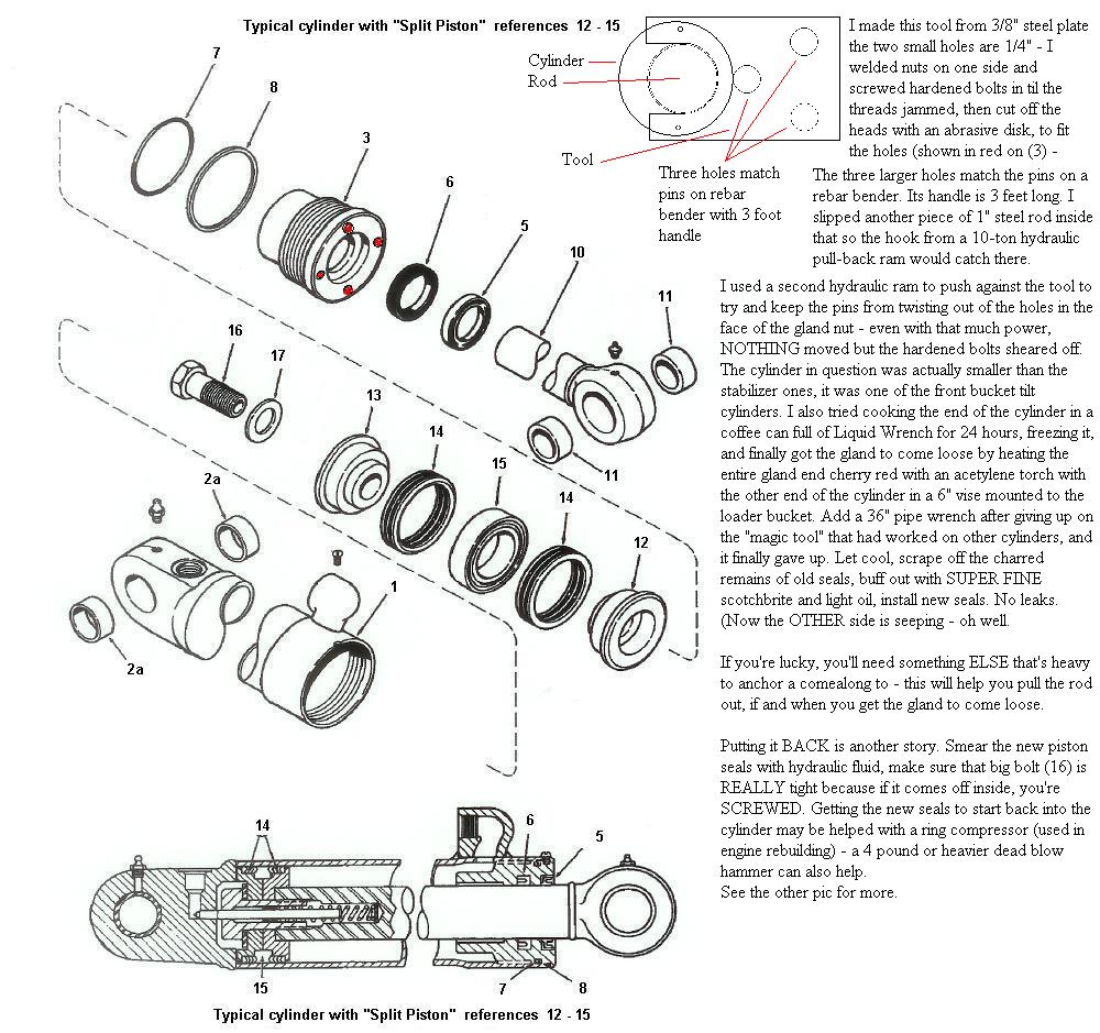

Here's some stuff that may help you in addition to the good stuff you've already gotten - Plus, everyone can now refer to item #'s so we're all on the same page... Steve
They went in backwards - right click on the right image first, open it in a new tab, then the left one. Click the + sign on each one and the print should be legible.
By the time you get the other three cyl's done, you'll be a pro...

BTW, the comments (mine) on the diagrams represent the WORST case I've run into - most of my cylinders were MUCH easier in a lot of ways.
However, when I redid the stabilizers, BOTH of the cylinders had dings in the cylinder body right where the gland nut threads into the cylinder - by the time I got them apart, the threads on both glands were rolled over. A local machinist cleaned up the surfaces and threads for about $35 each, IIRC.
Basically, you won't know how hard your particular beast is gonna fight you til it's over... Steve
