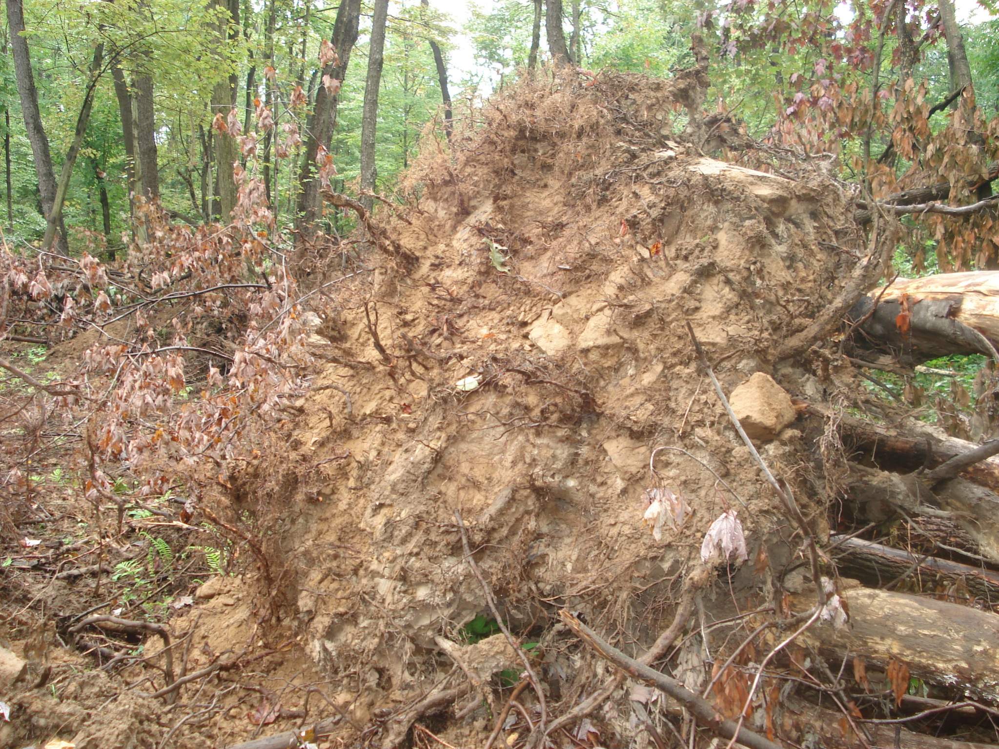

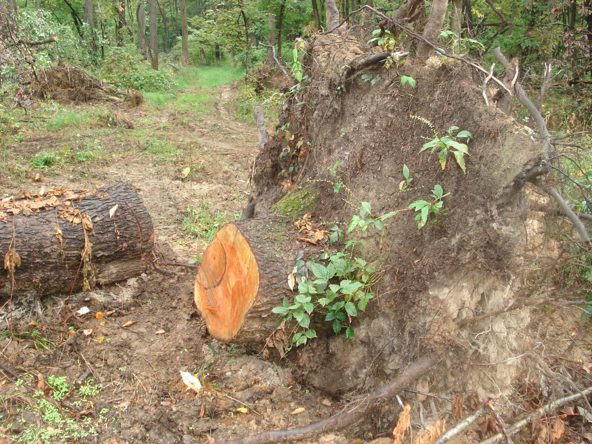

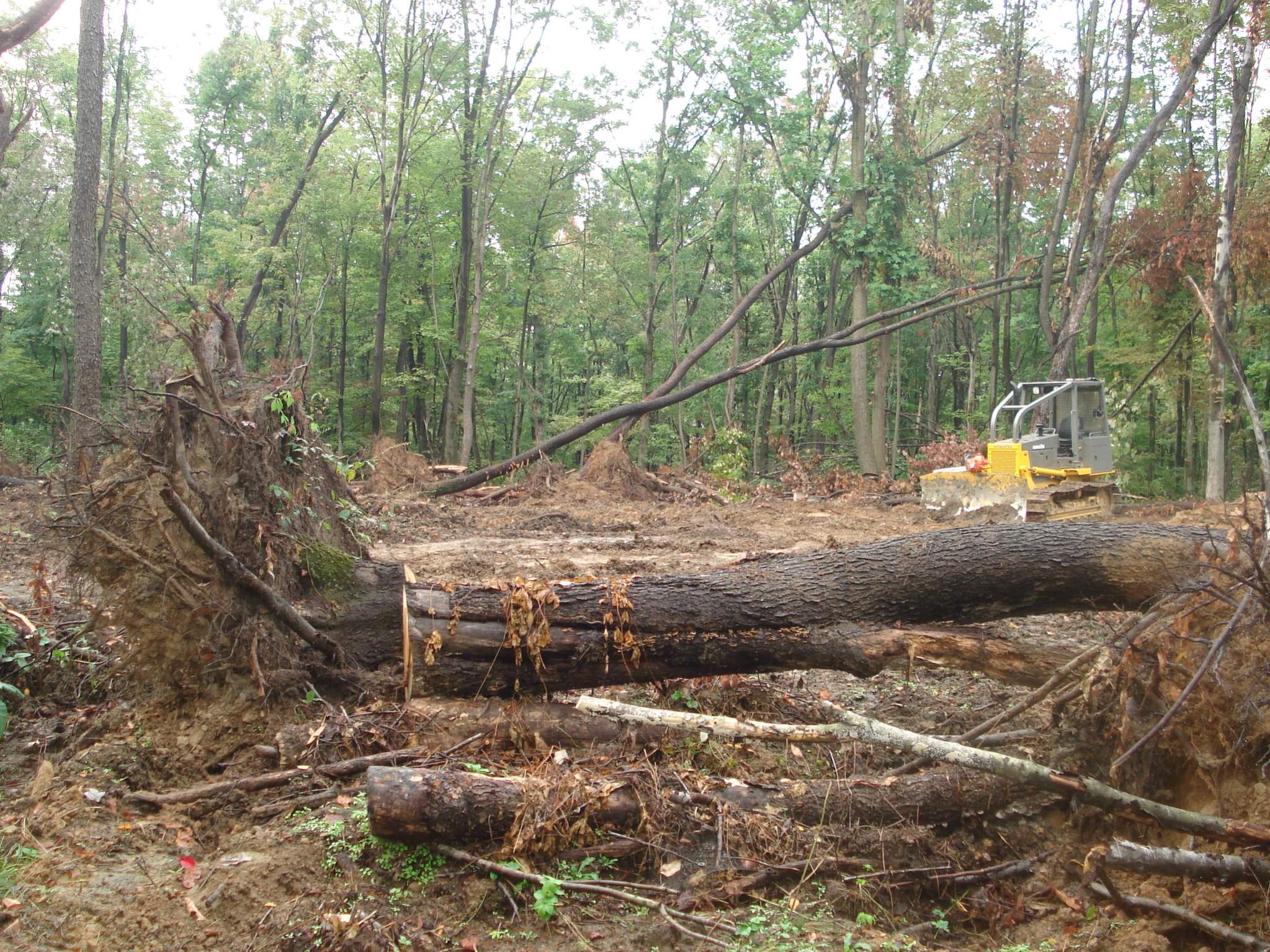

I also support Eddie, Obed and Egon's position. I recently started clearing out some land for a home in Ohio. Did some research on getting the trees down, and read some posts on pushing them over versus cutting down/removing stumps. I bought an 18,000 lb. dozer and have pushed over numerous trees thus far. (Not too mention lots of great seat time)
A few thoughts - If you're clearing out 1 acre, the dozer might be a better choice assuming you want a level/graded food plot....the dozer can knock the trees over, refill the holes, and push the trees/stumps to a central location for cutting/burning, and grade the plot. Maybe have him dig out a burn pit to stack the stumps. Perhaps you can cut off the stumps after he knocks the trees over. Pushing the stumps will remove some of the dirt, but probably not all of it.
An excavator is a better choice for pure digging, guess it depends on quantity and size. Was your 30" max tree size circumference? I have some pics attached for reference, trees are cherry, oak, poplar, and walnut.
I just looked at a 28,000 lb excavator yesterday, I need to get one for the property because before I bought it it was logged.....so I keep running into stumps. (lots of em) The dozer can remove them, but with a lot more effort and time. (and wear and tear if you own it)
Another option if you have the time/inclination is to rent a dozer yourself...get some great seat time, and these new dozers are pretty simple to operate. If unsure, hire the operator, and watch him for the next time!
For the leaning trees, a STRONG & LONG rope tied to the dozer will get em down. That is, if the dozer cannot get an angle to push the tree in the desired direction.
Eddie makes some great points if you do hire it out - check the guy out. Walk the area, and be as specific as possible. Write it all down. There are several posts on here that are tales of woe between owner/contractor.
Whatever you do - take your time, be safe, and have fun! (and take pics)
