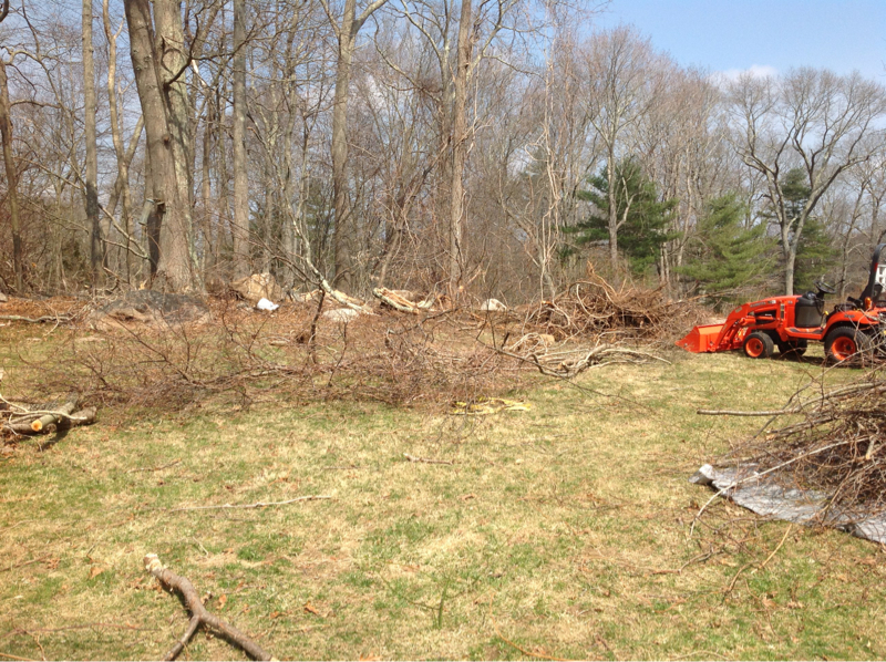

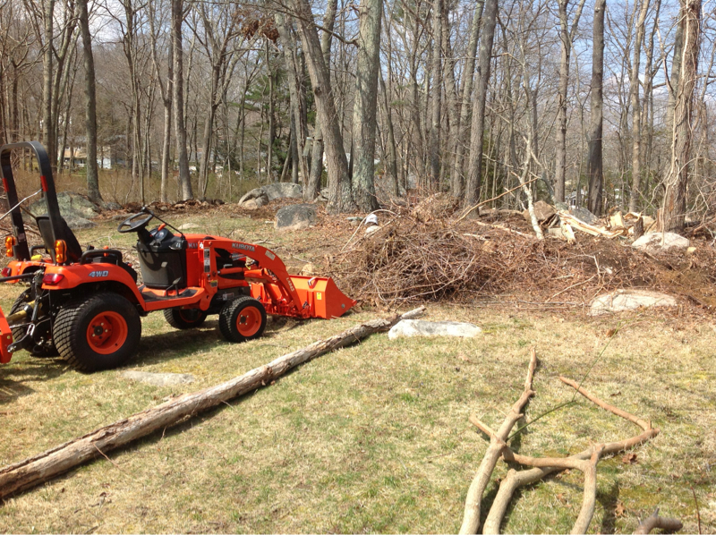

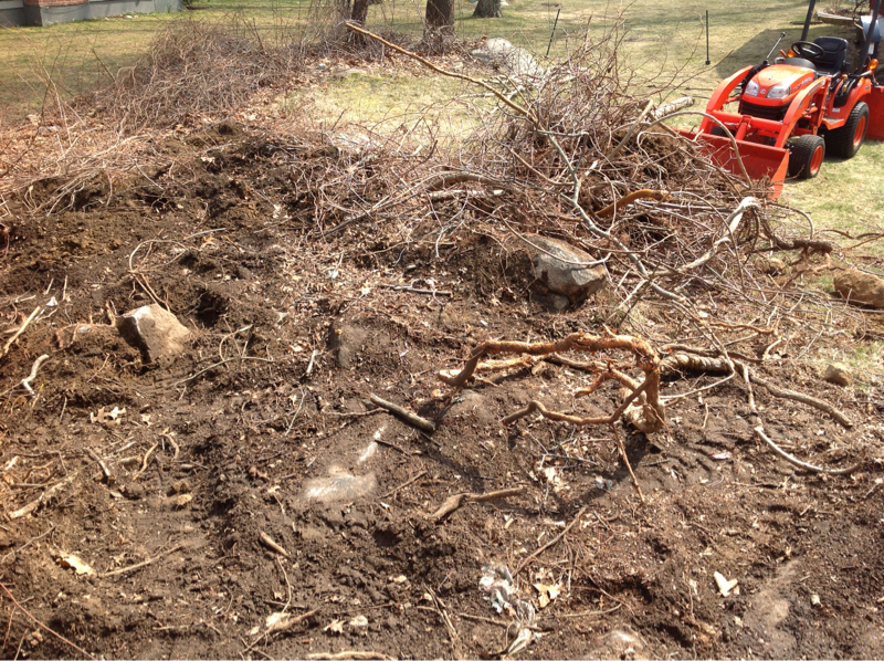

Day One
When I am done I there will be a small retaking wall and level soil ready for seed.

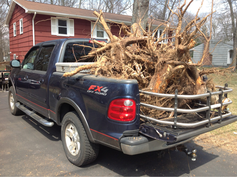

Day Two
Hauled off the stumps and moved some boulders around the yard.

Looks like an ambitious project!!!!! How big of an area are you working on?
Eddie
/ Renovating the Backyard
Eddie, my house sits on 3/4 of acre. I cleared 16-4", 2-6", 2-10' trees. All in about a 30x15" are

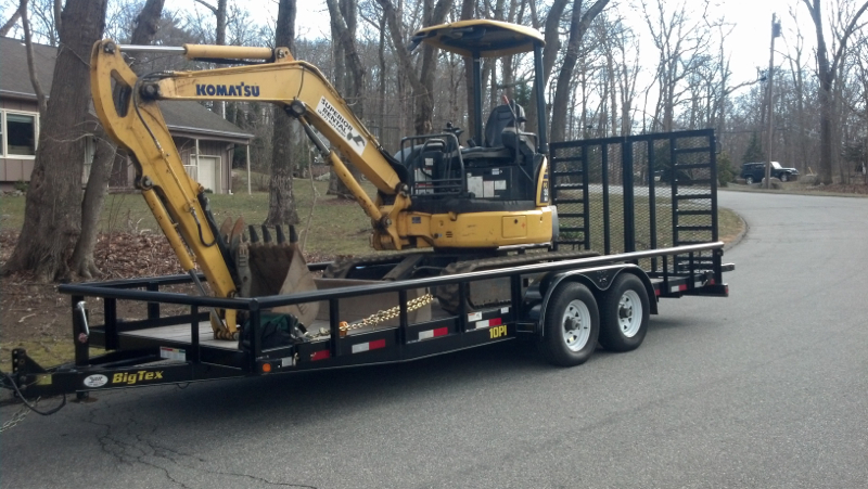

Started working in two areas at once while I had the mini-ex. The first area is the back left corner of the property (behind the shed), the path into the woods was to narrow for my BX to navigate. The second area is the back right corner of the property. This area was largely overrun by vines, unwanted trees and boulders. In the pictures you can see where I pushed to boulders back to form a rock wall. The retaining wall will be 36" high and about 60-70' long.

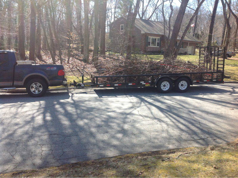

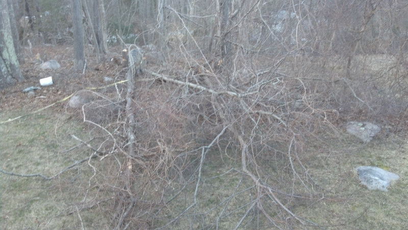

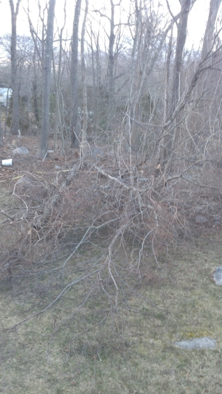

Wife is home today, so I can get back to work. This is my second trailer full of brush.

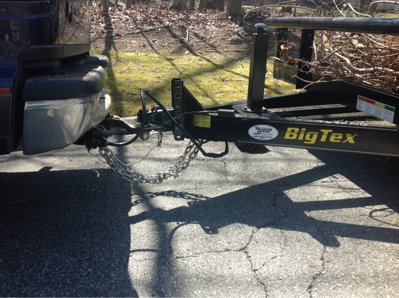

I never know how much slack to give the breakaway cable... I will post more in the transportation forum.

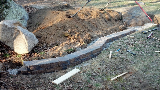

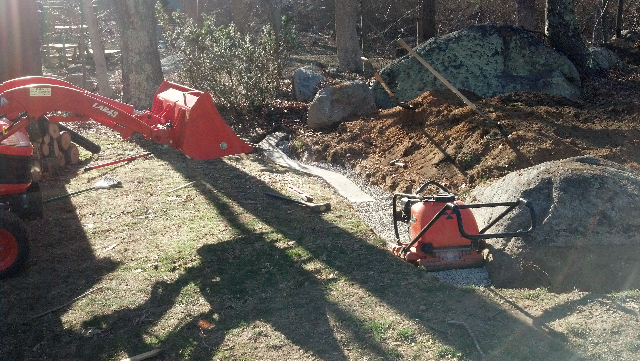

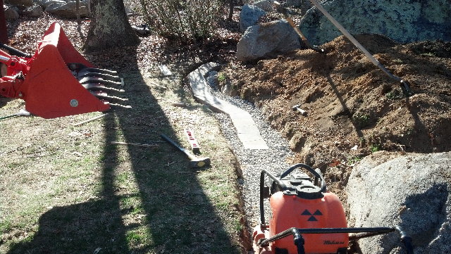

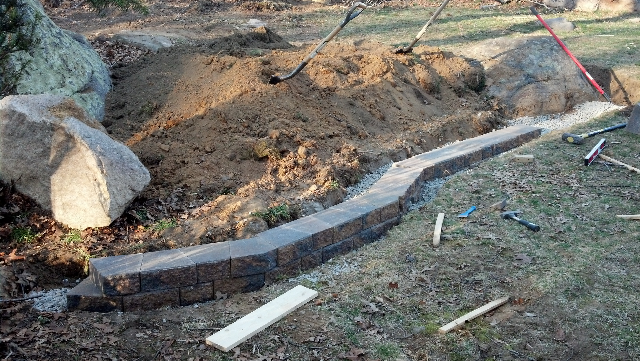

4th day of work. 1st day of learning how to build a wall.
I am using Niclock Serafina Oyster Blend stones.

I like the serpentine layout. Some nifty stuff can be done with the cast concrete products.
/ Renovating the Backyard #9
Nice job.
How tall are you making the retaining wall?
In most cases you want to slant the wall towards whatever you are retaining. It is probably ok for 2 or 3 layers (including the base layer), but any higher than that, and you definitely want to slant it back towards whatever you are retaining. The slant helps keep the wall from being pushed over by the dirt behind it. That is why this style of brick has the little nub at the back to help hold it in place, and get the slope right.
This wall will be less than 3' tall. Newer small retaining walls are going to a "no lip" style block. But I was concerned as well and then called around to some local hardscapers. (3 of them) They all agreed less than 3' I am good so long as I glue the blocks together using PL Premium.

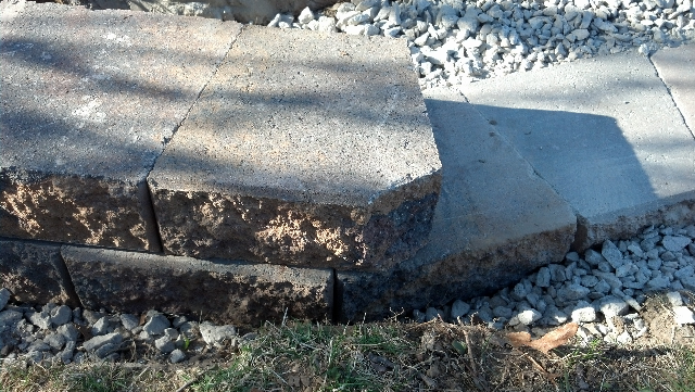

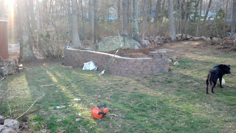

Day 4.

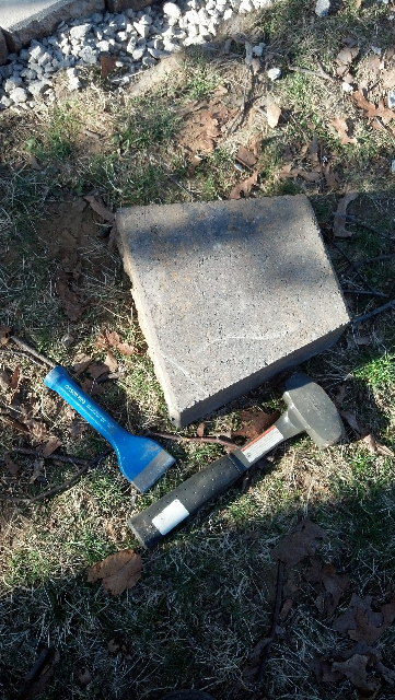

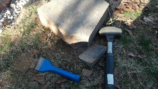

Most of the wall is completed. Now I need to rent a saw so a can cut the end stones and finish this project off.
/ Renovating the Backyard #12
Nice!
I bet if you put a masonry wheel in a 4-1/2" angle grinder, and score the cut on four sides, it will break clean. Angle grinders are as cheap as renting a saw.
/ Renovating the Backyard #13
I have a masonry saw blade for my 7 1/4 circular saw. Kind of what Dave said, but you get a bit more cut and it's easier to control. A decent diamond blade will last for years and is about $40
Eddie
/ Renovating the Backyard #14
Yep, that works good too. I used to have a "scut" Black & Decker circular saw that I used for those things. I had masonry and metal cutting blades. The shaft was a little wobbly, but it did okay. :laughing:

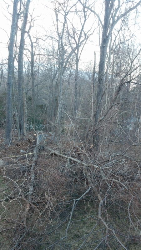

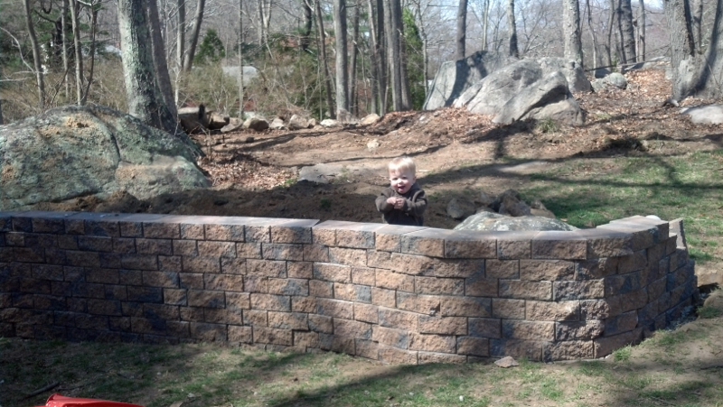

The wall is complete. Some backfilling required.
You can also see how I pushed back the woods a little bid.
