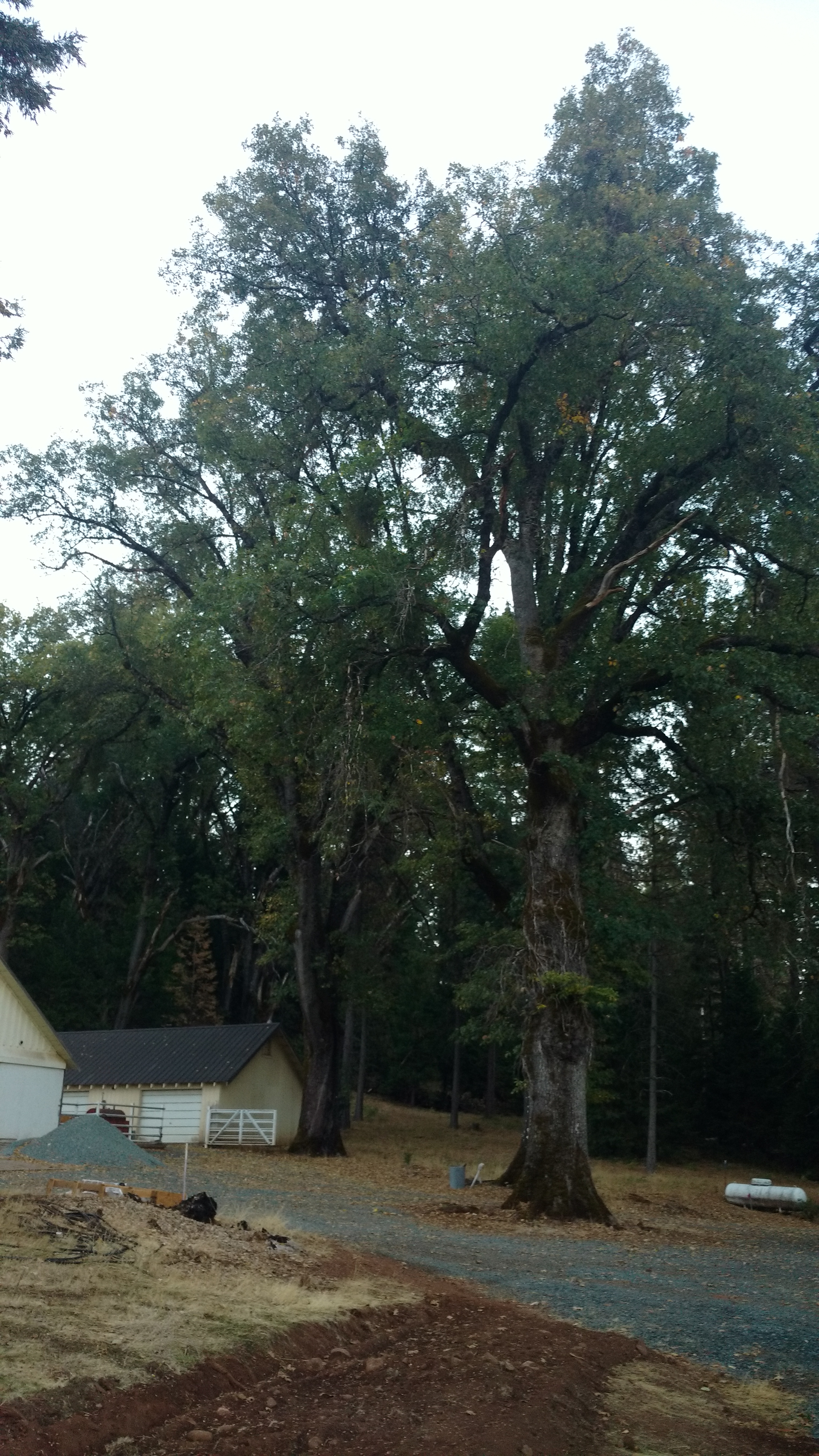

Took this picture this am before it got very light. Maybe another later when it is more lit up.
For reference, the building in the picture has a peak height of about 16 ft. There are probably 9-10 oaks in this vicinity, and they "march" all the way up the hill. I'm only trimming the ones near structures.
The disturbed dirt in the foreground is the RV pad I am working on ... trying to level out.

Wow. Magnificent trees.

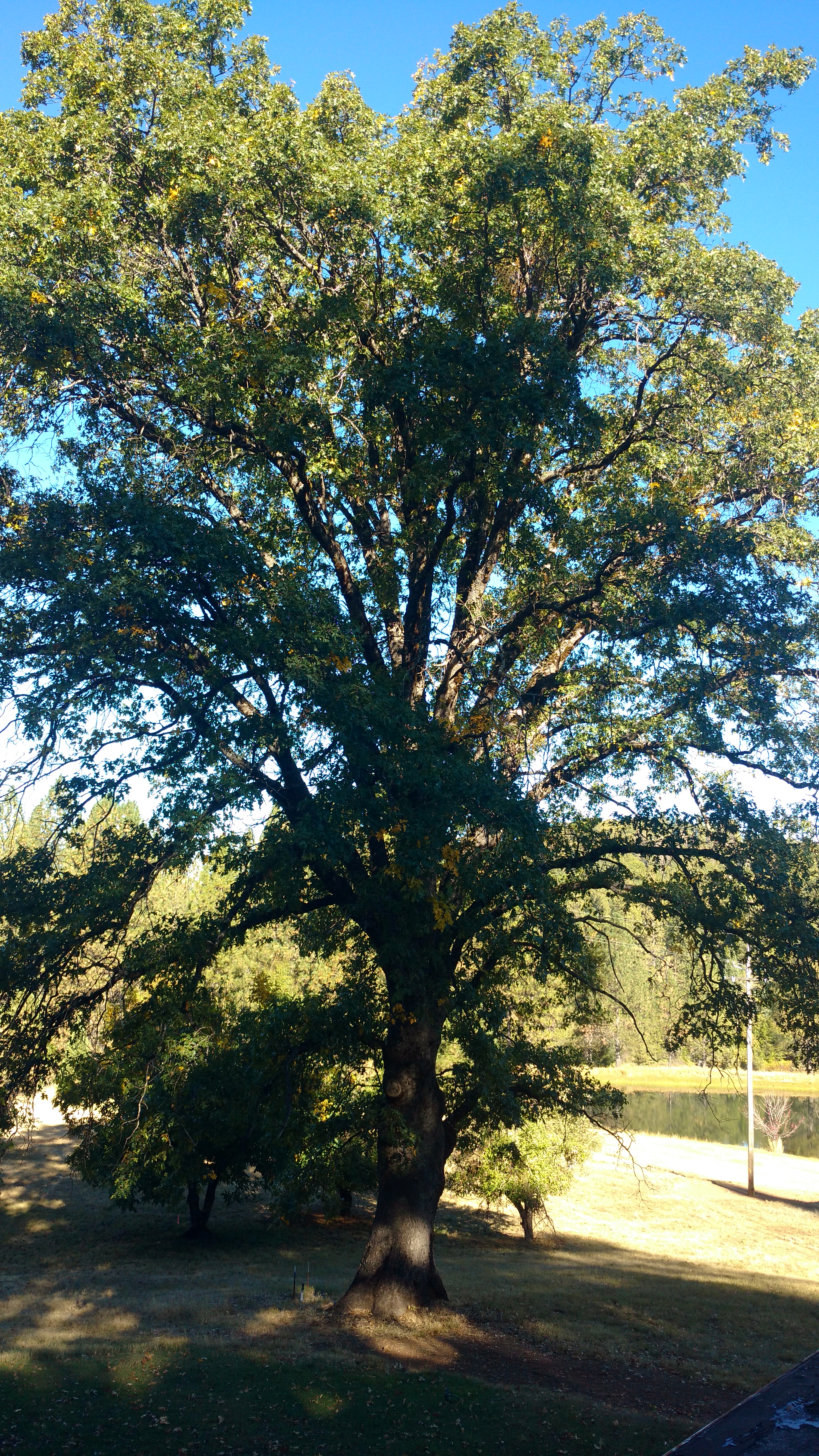

Here is a pix of one of our nicest shaped oaks. I took this standing on the 2nd story of the house. It's hard to get the full tree in the pix as they are so large.
This one is kind of by itself, but in line with the row of oaks in the earlier picture. There must be underground water flow or something to support so many large trees-- which I'm sure need a lot of water.
   / Rent or buy a chipper-- I need to decide soon #29
Those are nice trees. Removing the appropriate branches should make them healthier and safer. When anglos started coming to California the Californios thought they were fools for camping under the big valley oaks, because the branches break off.
