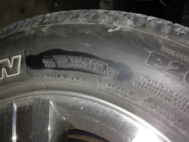

Yes, that is my sticker. I agree, I would benefit from LT tires. They were an option with the HD package but it would have forced me into a 6.5' bed with the SCREW cab. These passenger tires to cover my axle ratings at max pressure. Here is my sidewall. These tires cover me up to my 11,300 towing capacity. When replacement time comes around, I will probably opt for P tires again for my needs.

So do you run those tires at 44 psi or the Ford recommended 35?
Those tires are not gonna take your axle rating at 35 psi for long. Looks like Ford is asking for another Explorer/Firestone class action suit by cheaping out in important areas...
