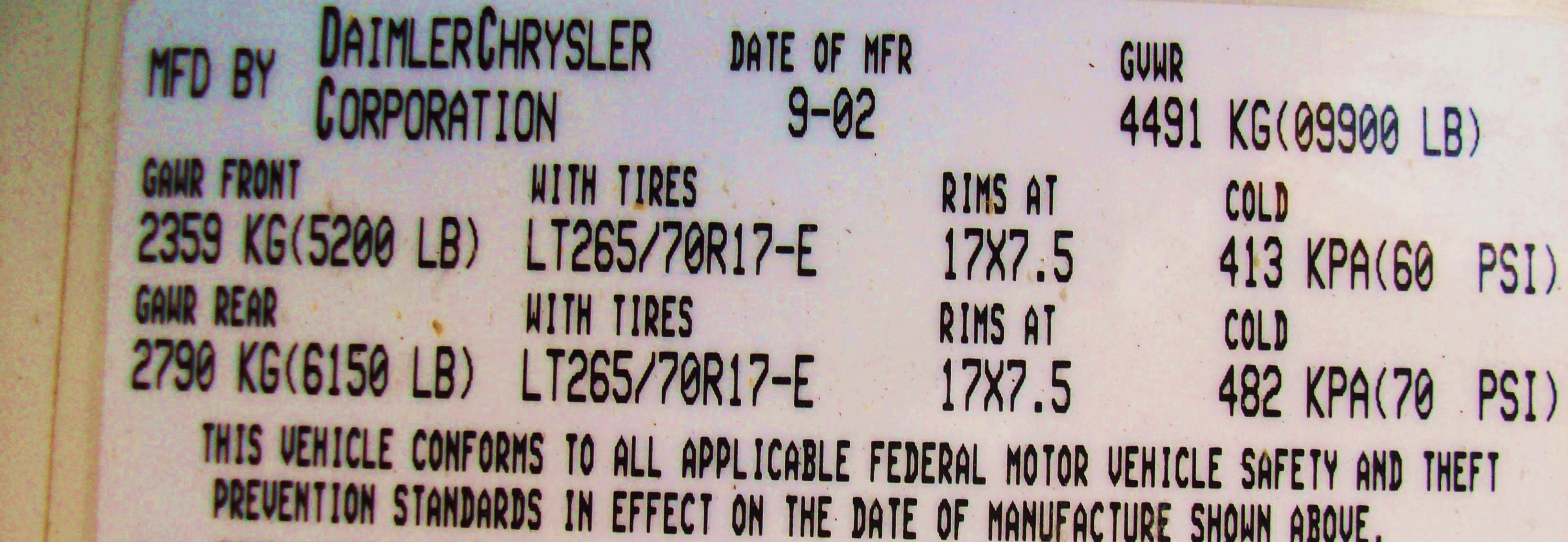

The point of this thread is rental yards not allowing 1/2 ton trucks to tow anything in their yard. Mostly due to people not understanding the ratings of their own truck. The Ford sticker proves why that rule has been adopted. 11,300 lb tow capacity on P rated tires may be safe but it's pushing it. Selling someone a "Heavy Duty" package with P rated tires at 35 psi is just dumb. Also many trucks come with hitches not rated high enough for their own tow capacity.

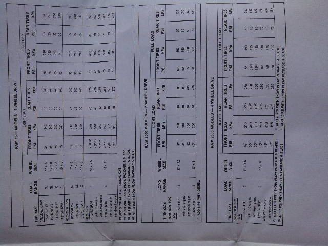

Did you get an addendum with the owner manual?
My '01 Ram2500 CTD shows the stock 245 rating on the door; my truck came with 265 and use a different pressure than the door sticker. The addendum in the manual lists a loaded tire tire pressure, and a no-load tire pressure.
I back the pressure down unless hauling/loaded. Other wise ride is worse, and rear tires wear center of tread.

Difference is Dodge doesn't market my truck as "Heavy Duty" or give it ridiculous payload ratings that might max out it's components.
Funny your "HD" package truck has a weaker front axle (by 300 lbs) than my 9 year old "regular" truck and the rear axle is only rated 150lbs more. The Dodge/GM trucks may look weaker on paper compared to an overrated Ford but that's because they under rate their trucks.
Hmmm, your door sticker lists 35 PSI too... Funny thing about that.

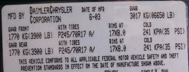

Well this is certainly interesting. After I posted the 80 psi for load range E tires thought I should actually check my own truck , and low and behold Dodge does not list 80 psi anywhere that I have looked Dodge 3500 rating 004.JPG
also when you add the axle ratings together it comes out to a totally different # than the GVWR = 9900lbs. axles added together gives 11350 lbs. tire max added together gives 12780lbs. I can see how someone would have a hard time knowing exactly what they can load in the truck/ haul....and how a person working in a rental yard could get confused also
