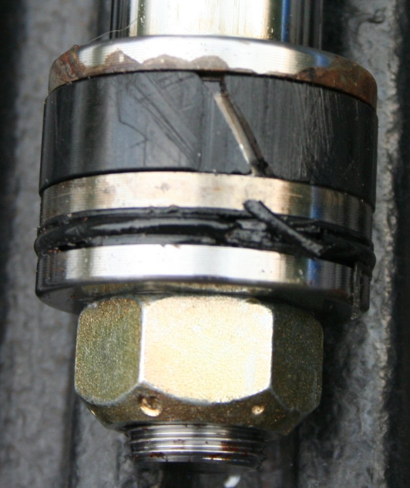

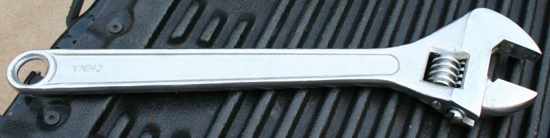

I got the wrench and it worked like a charm. I would guess it took somewhere between 100-150 lbs to get them loose. I didn't use a cheater and I didn't put all my weight on it.

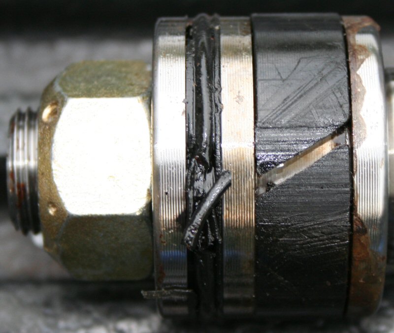

I have the cylinders apart and I'll probably put them back together tomorrow or Saturday. I have attached some pics of the broken seals. It's easy to see what the problem was. I think the small frayed seal in cylinder 2 was what was causing the initial slow leak down and the split larger seals in both cylinders are what happened this past weekend when the bucket would stay up at all.
One question I have is when I removed the caps, it looked like there was either some pipe thread sealer or some sort of Loctite on the threads. I don't have a picture of the cap threads, but the white stuff on the seals in one of the pictures is what I'm talking about. Does anyone know what this is? Do I need to put thread sealer or Loctite on the cap threads when I put it back together?

chanceu said:
I need a 2 1/8" wrench. I've only looked a couple places, but all the open ended 2 1/8" wrenches I've found were around $150.
Try Harbor Freight Tools - from their web site -

Glad you got it done. Looking at the pics, the seal scuffing is pretty extreme - have you checked for nicks and bumps in the cylinder? The chrome is also spalling and kind-of looks consistent with hitting the cylinder walls. The other possible cause of the destruction could be re-assembly - if there is a sharp ridge at the top of the cylinder. My bigger cylinders had a "liner" which had a very sharp top edge (sharp enough to shave a finger nail). I relieved the lip with a bit of wet-n-dry (and flushed it clear, upside down, with WD-40 after).

I noticed some rust on top side of piston check the bore of your cyl for damage for any pits in there. Pits will chew up piston seal (which is what you show in picture) maybe some water got in to cyl from bad rod seal (the one in the cap) and caused damage there?
usually there is an o-ring on cap before threads to seal the cap to cylinder I usually put a LITTLE nevercease on threads.

I'm pretty sure the scuff marks on the flat rings happened when I pulled them past the threads in the cylinders. I didn't take any precautions to not damage the seals because I am replacing them all. I did peek in the cylinders and didn't see any damage, but I am going to look closer before I put them back together.
I noticed the rust and wondered how something rusted in a bath of oil especially since I haven't operated it in the rain and it is stored inside. My guess is it's from the dealer as I'm sure it sat outiside for weeks if not months before I purchased it.
As I said, I'm going to take a closer look in the cylinders before I put everything back together. I'm also going to hit the rust with a scuff pad just to make sure it isn't causing any damage. I really don't think there is any problems in the cylinders because I know I was doing something I shouldn't have been doing when the initial slow leak down started and I was doing something else I shouldn't have been doing this past weekend when the seals gave way for good.

Hmmm, I looked at the pictures. The thing that is cut at a 45 degree angle is a wear ring that keeps the metal piston from rubbing on the inside of the cylinder. It is split so that it can expand as it wears. All of the sealing is done by the thin stuff down by the nut. Be nice to that when you are putting it together ....

That may be. I thought is was to much of a coincidence that the splits in both rings were almost identical.
