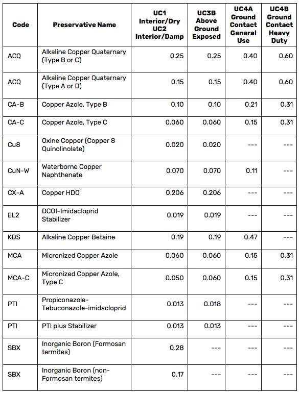

Landscaping timbers are "dipped" , not pressure treated and that's why they rot fairly fast.
Check the tag on PT lumber, you want .60 treat, .40 won't last near as long, as it's not rated for ground contact.
You can spl. order .80 or 1.0 but have a FAT wallet to pay for them! (marine rating)
SR
.40 IS rated for ground contact,...... however .60 would definitely be best!
See my post #17 for all the ratings.
Not where I live, it says right on the tag of .40, NOT for ground contact. .60 is rated for ground contact...
I've seen #17, and that's why I posted what I've read right on the lumber.

You don't need marine grade pressure treatment. And you're not likely to get it unless you are near the coast. You do need more preservative than typically found at a big box store - get the ground contact rated treatment level. As for fastners, just be sure they are ACQ rated and you'll be fine, these are typically hot dipped galvanized (not regular galvanizing), stainless steel, and many ceramic or proprietary coatings. The new chemicals in pressure treated wood are quite corrosive so do use a separator between the wood and frame. I would use something like the new window flashings that are self adhesive, have a type of rubberized material. They are self healing and provide better protection than tar paper.
Grace Ice and Water Shield
Cut to fit, peel and stick.
   / Repainting Trailer and Replacing Trailer Deck #25
There are several types of pressure treatment available and the proper one to select depends on the environment and what you have access to. For the most part ACQ seems to be what the big box stores carry, but some of the other lumber yards will carry other preservative treatments.
As for treatment and environment, Borate treated ones are effective against termites and non-toxic to humans, however the borate will wash off with water so can only be used in protected areas.
There are 2 ground contact ratings for ACQ, UC4A (0.40 retention) and UC4B (0.60 retention) both are rated for ground contact. There is also MCA with 0.15 and 0.31 respectively. Here's the chart on pressure treatment and the retention rates:
SR
For YOUR lumber, I am sure you are correct.
But.......There ARE different ratings for DIFFERENT chemicals, used by different producers, in the treatment process.
