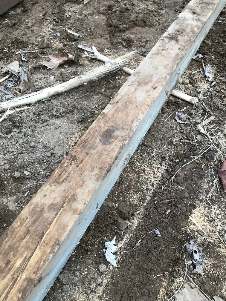

Landscaping timbers are "dipped" , not pressure treated and that's why they rot fairly fast.
Check the tag on PT lumber, you want .60 treat, .40 won't last near as long, as it's not rated for ground contact.
You can spl. order .80 or 1.0 but have a FAT wallet to pay for them! (marine rating)
SR
.40 IS rated for ground contact,...... however .60 would definitely be best!
See my post #17 for all the ratings.

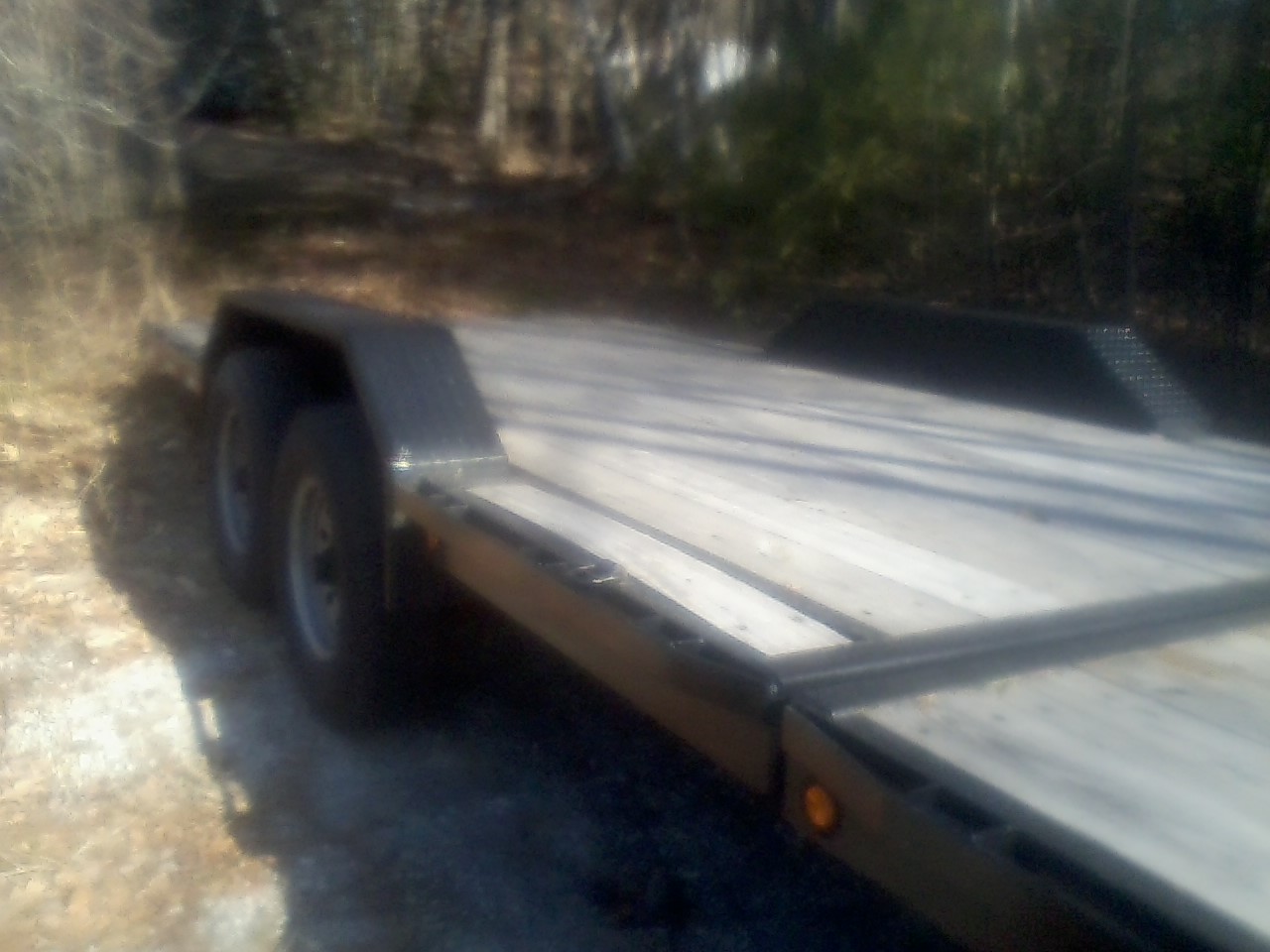

I am tempted to do just that, and upgrade to a 5200 lb axle with brakes. Would make the trailer an excellent firewood trailer. I am also thinking about fixing it up and selling it and buying a single axle 5200 lb high side dump trailer in its place.

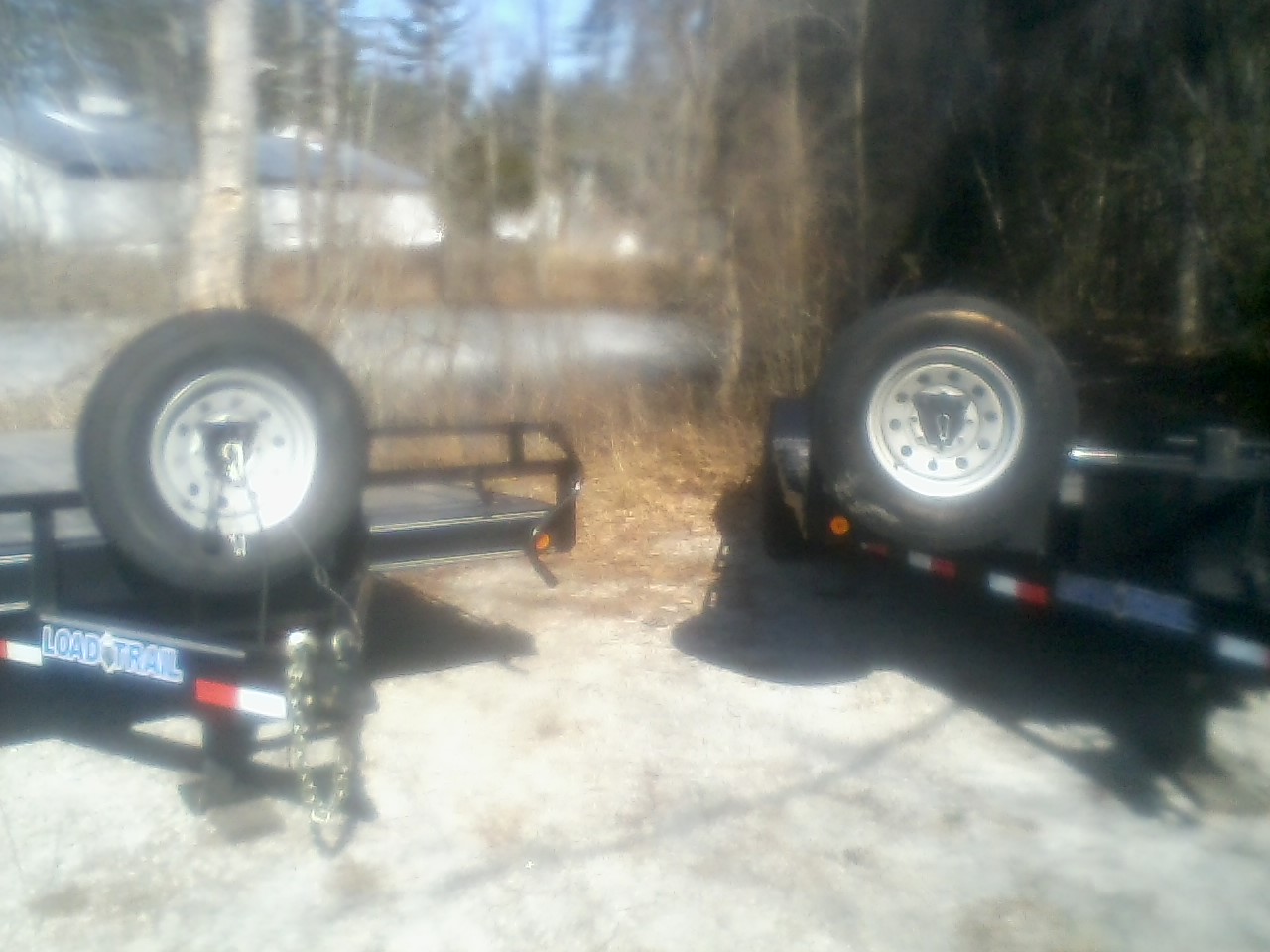

I looked at this trailer near me...Details - Load Trail LLC
