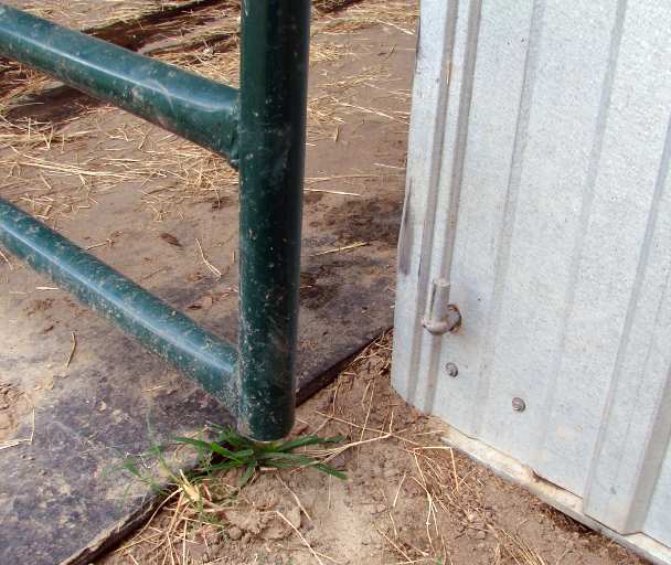

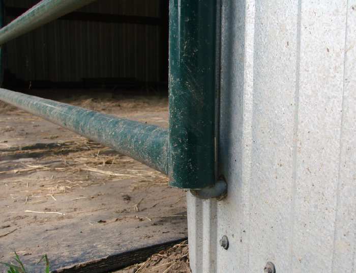

Every time you buy a gate, but an extra gate post hinge or two. Use one to latch the gate open and one to latch it shut. They make simple, cheap, easy to use latches and also keep your gate posts from sagging, especially when kids stand on the gates. :) :) :)
