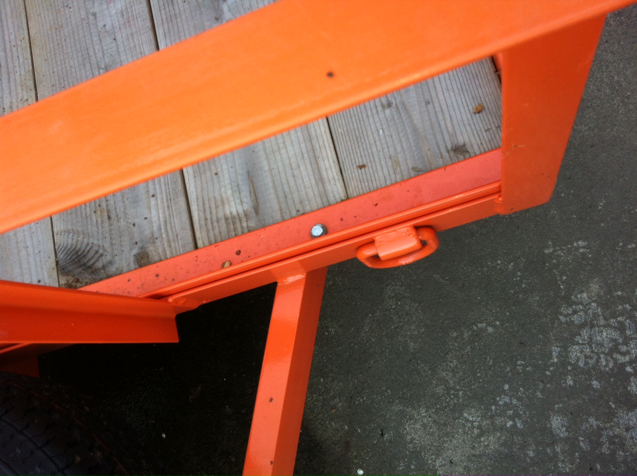

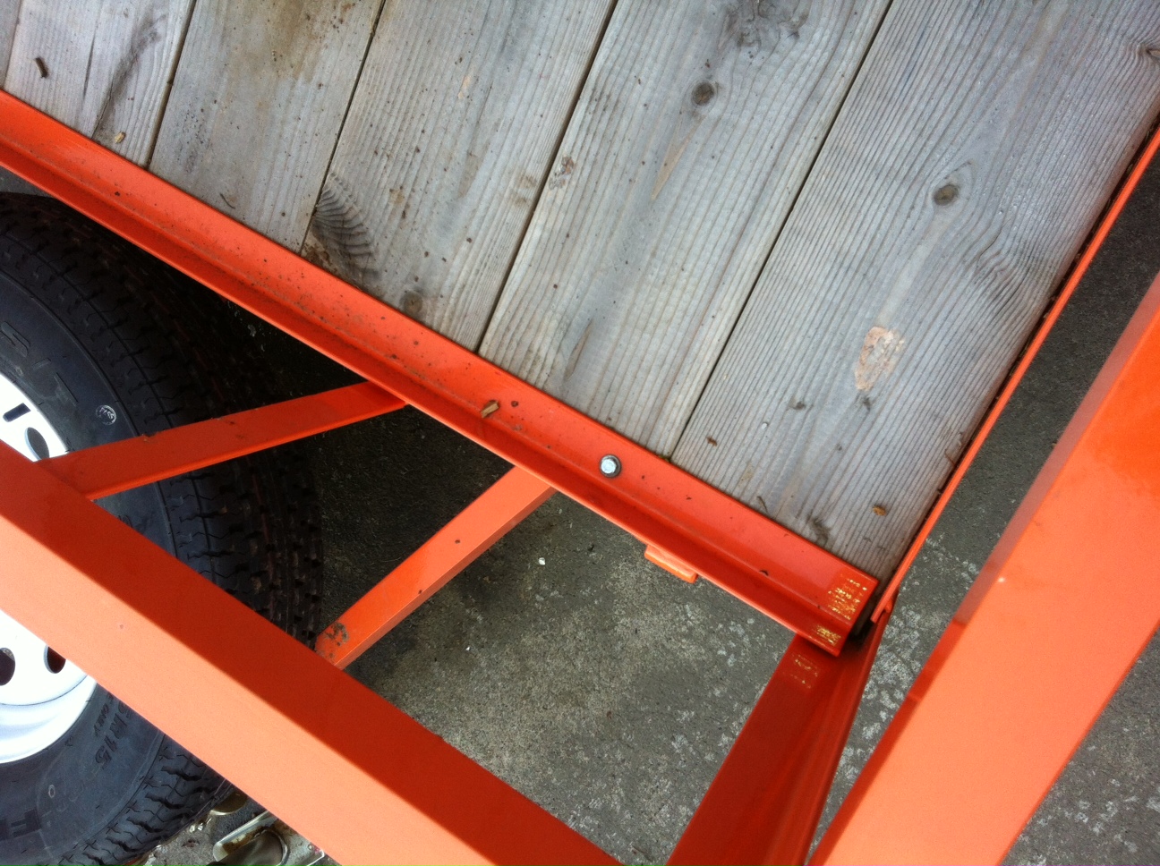

/ Repair/Replace Trailer Floor #25
I have an 8 foot trailer and don't think I can bend a 2x6 eight to ten inches up in the center so it goes in that way.
As an alternative, I plan to do what was done on a 8 ft trailer at Home Depot rentals.
An angle iron, same size as the framing, was bolted across the front, using two bolts.
Bruce
#26
View attachment 379239 View attachment 379238
Bruce
Do you think that is a lag bolt, or does it go all the way thru with washer, nuts on bottom?
As I was taking my old boards off I noticed they were held on with weird screws that I had never seen before. Sorta like a lag screw in metal. I tried to back some out but no luck. I had to just break them off. I figured if new bolts were needed I would get some round head wood bolts and drill new holes for them.
But your method of screws at the front end sounds good.
/ Repair/Replace Trailer Floor #27
I'll check next time I go to town, if the trailer is there. I'm pretty sure it is a bolt through the frame, with a nut.
