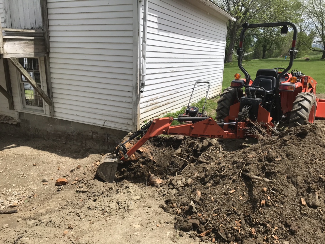

After we moved here last year I noticed a large tree growing next to my garage stem wall.
It had pushed the blocks loose and groundwater and chipmunks was getting in.
I’ve been digging and leveling in order to build on so removing the stump and repairing the damaged area was first order of business.
Here’s the end of day 1.
Trip to box store for mortar and replacement blocks are in my near future(tomorrow).

T'were it me, I'd be taking more away from that back wall too and getting rid of that grass/sod so close to the siding. Then I'd be planning on adding some drain pipe for that downspout to direct water away.
/ Repairing cinder block wall
Yes. That’s the plan. This whole area had grown up against the building. I’m going to dig that back out and put a French drain along it before putting up the lean to. with a swale outside of that, maybe this will correct my problem areas.
That gutter and downspout are trash. I just haven’t made it that far down “the list”.

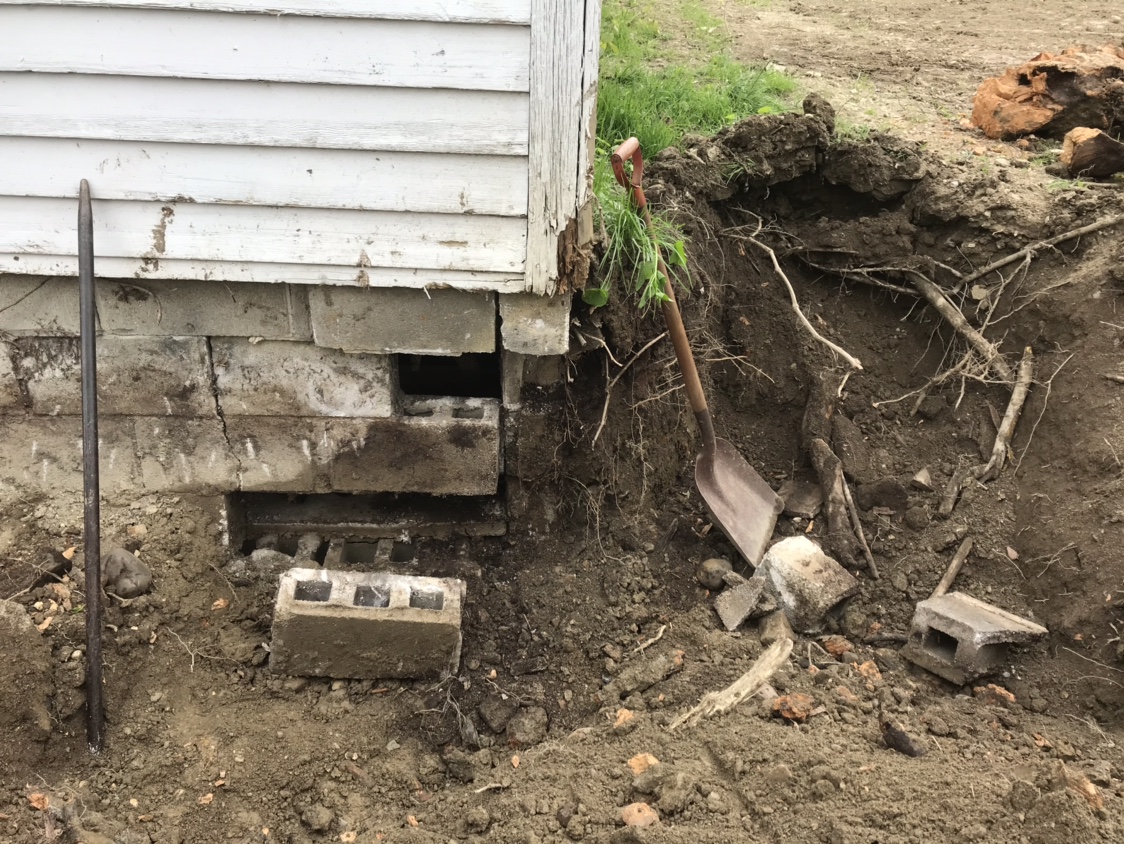

I have to dig that back wall out to relieve the pressure on it and attempt to push the bow inwards it has developed. It was built in a he early 40s the previous owner told me.

I would wok both directions till I see no more cracked joints or blocks. That is your new cut line. Probably need to shore up the floor in that corner too. AS Cat driver said; replace with concrete unless you are a good block layer. Use high strength mortar if blocks are chosen. I have don a couple similar projects in my far past.
Ron
So basically remove the bad blocks, form a flat surface on both sides and fill with high strength concrete?
Not quite sure how to do the last few inches on top under the sill plate but maybe leave enough room to get a trowel in and pack it in. Then after it sets, fill the last little bit.
/ Repairing cinder block wall #12
Pour it, but leave the proper space for a row or two of mortared bricks across the top.
/ Repairing cinder block wall #13
Frame up the inside and outside to above the sill plate only wider. Pour concrete in the gap between the sill and forming. Overfill a little to ensure concrete that is in full contact wit the sill.
Another way would be to form in a metal plate on rebar supports that fits flush with the sill. Fill in the gap with grout.
/ Repairing cinder block wall #14
I would also evaluate the sill. It looks like that could be badly decayed so incorporate that into your job.
/ Repairing cinder block wall #15
Replace the sill plate last. Jack the corner up slightly above level, then set it down on he new sill plate. Even with block put some K web in the horizontal joints and a few vertical rods tied to the K web and concrete grout in the cells.

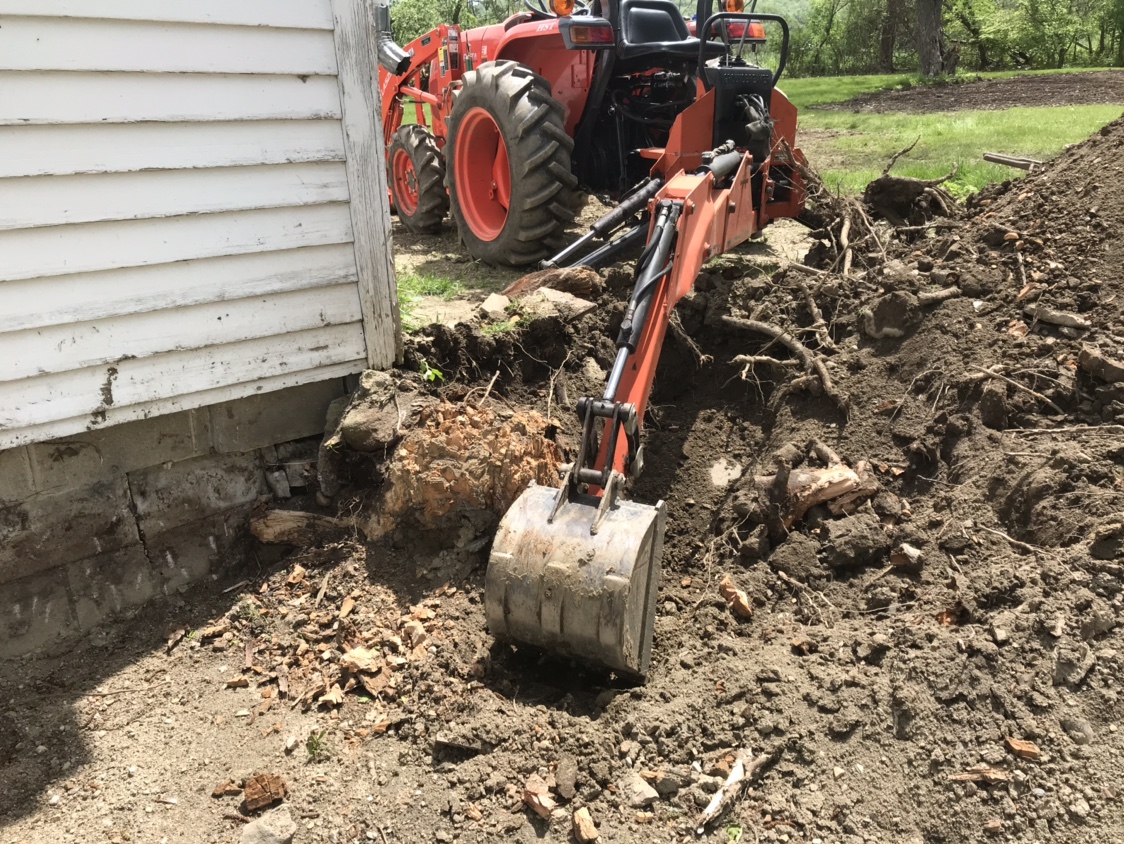

Between the rain showers I got a little more done on my garage foundation. Of course this has turned into a bigger job than planned.
Dug the bowing back wall out pushed back in place with tractor, pressure washed the wall off is where I’m at. Plan on a 4” perforated pipe and French drain next with a 60 mil membrane against the outside of the wall.IMG_0751.jpg
This all started from a tree allowed to grow next to the foundation in the past by previous owner.IMG_0142.jpg

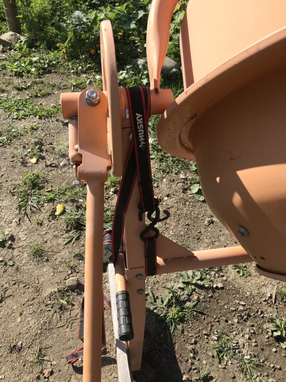

Had the first aww man... after the HF mixer tried to fall over on me. IMG_0789.jpgLooking at the certified repair you can see a bolt head sticking out slightly. (By the U in Husky).
The inner tubing broke in half around the bolt holes and when I went to dump a full tub, it pulled out dumping everything on me, the bucket, and ground.
I practiced a few of my choicest words that I’m never allowed to used when my 5 yr old granddaughter is near.
Nope, you guys can’t see my masonry work. It is just that good. Yeah right.
