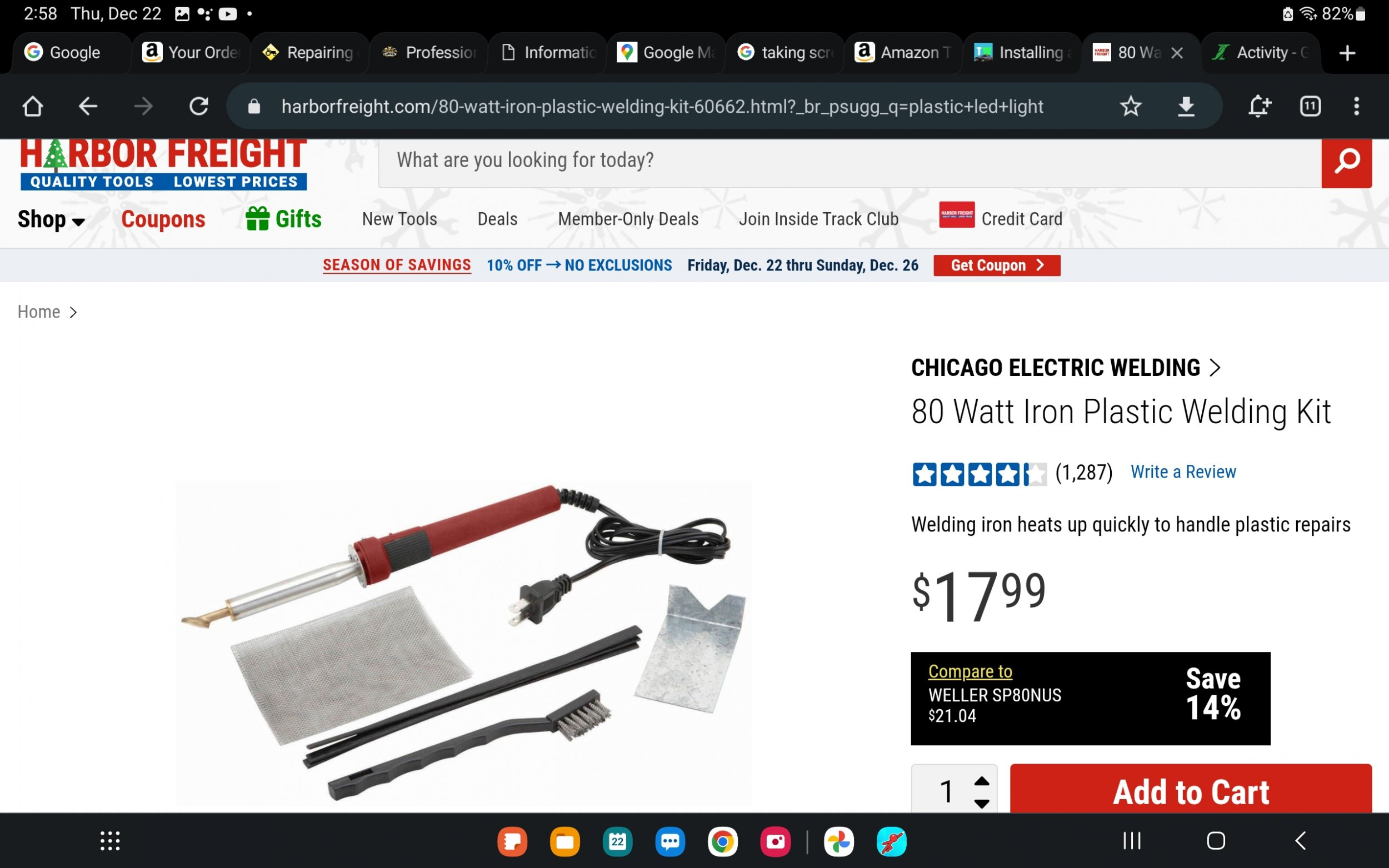

I have 2 tractor cab roofs made of HDPE plastics. Want to try to fix them. Found this cheap repair kit, but I dont know if it’ll work on this type of plastic?
Has anyone had luck fixing this type of plastic? I dont want to use tape, I want to repair with a “weld”

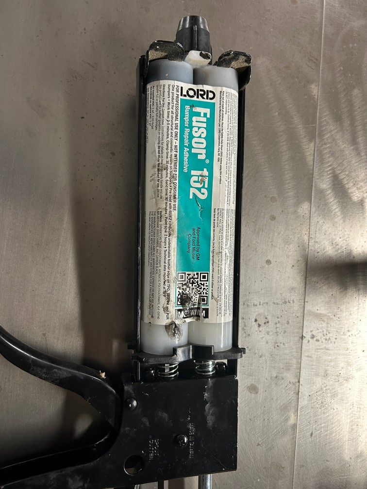

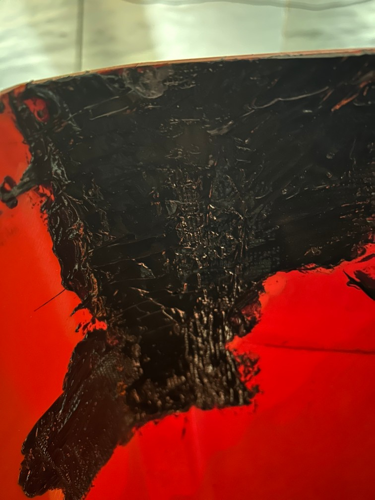

I used this Fusor product, which is what autobody shops for repairing bumpers and like materials. MY BX2350 hood cracked, the rear is my mistake. Requires "plastic like" mesh and primer. Can also been sanded and painted. Repair is about 1year old. Should be found at body supply shops.

I've welded plastic rain barrels split by frost by cutting slivers of the plastic from the opening as filler rod and using a fine pencil tip soldering iron. It works but the joints can be brittle. Holds water, just don't kick the joints or try to move the barrel when it's full of water.

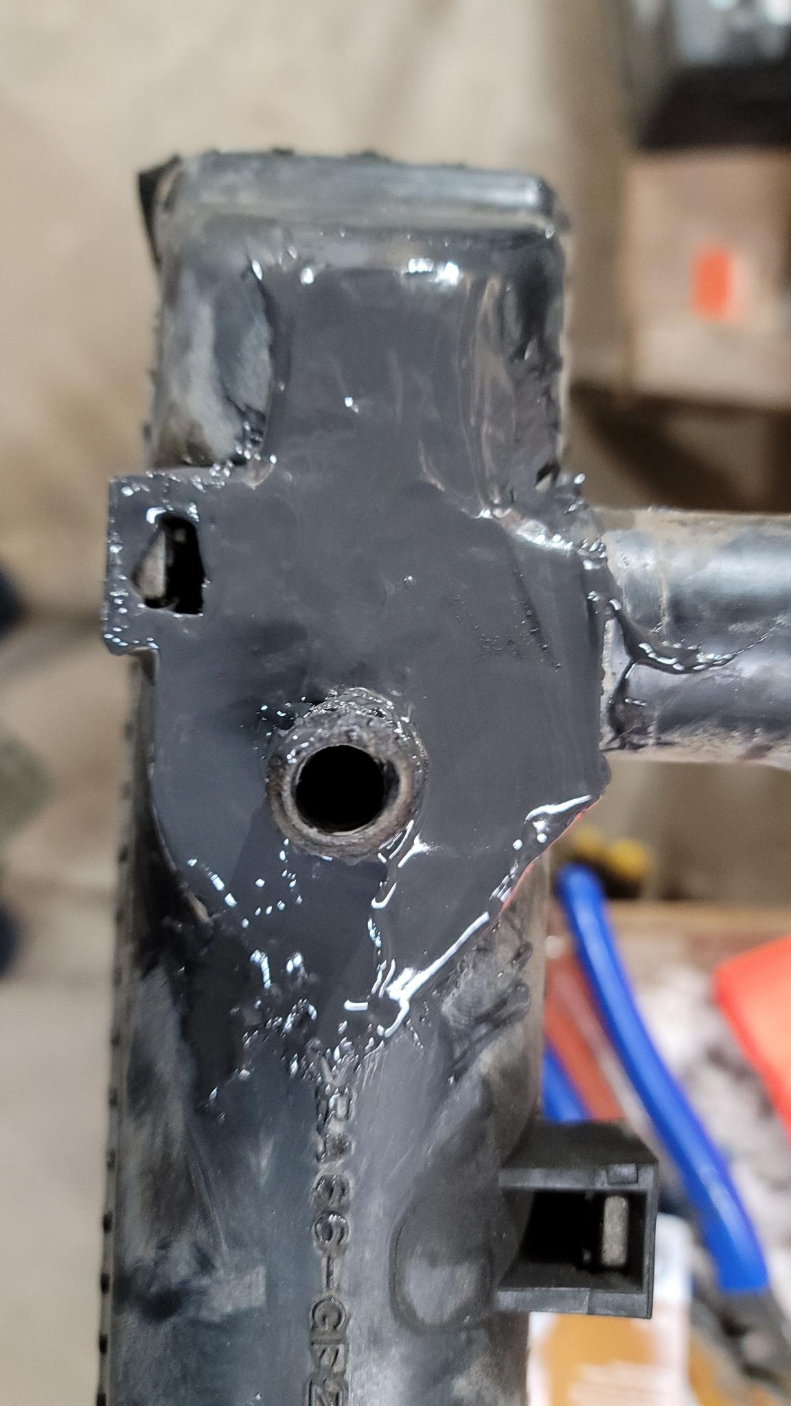

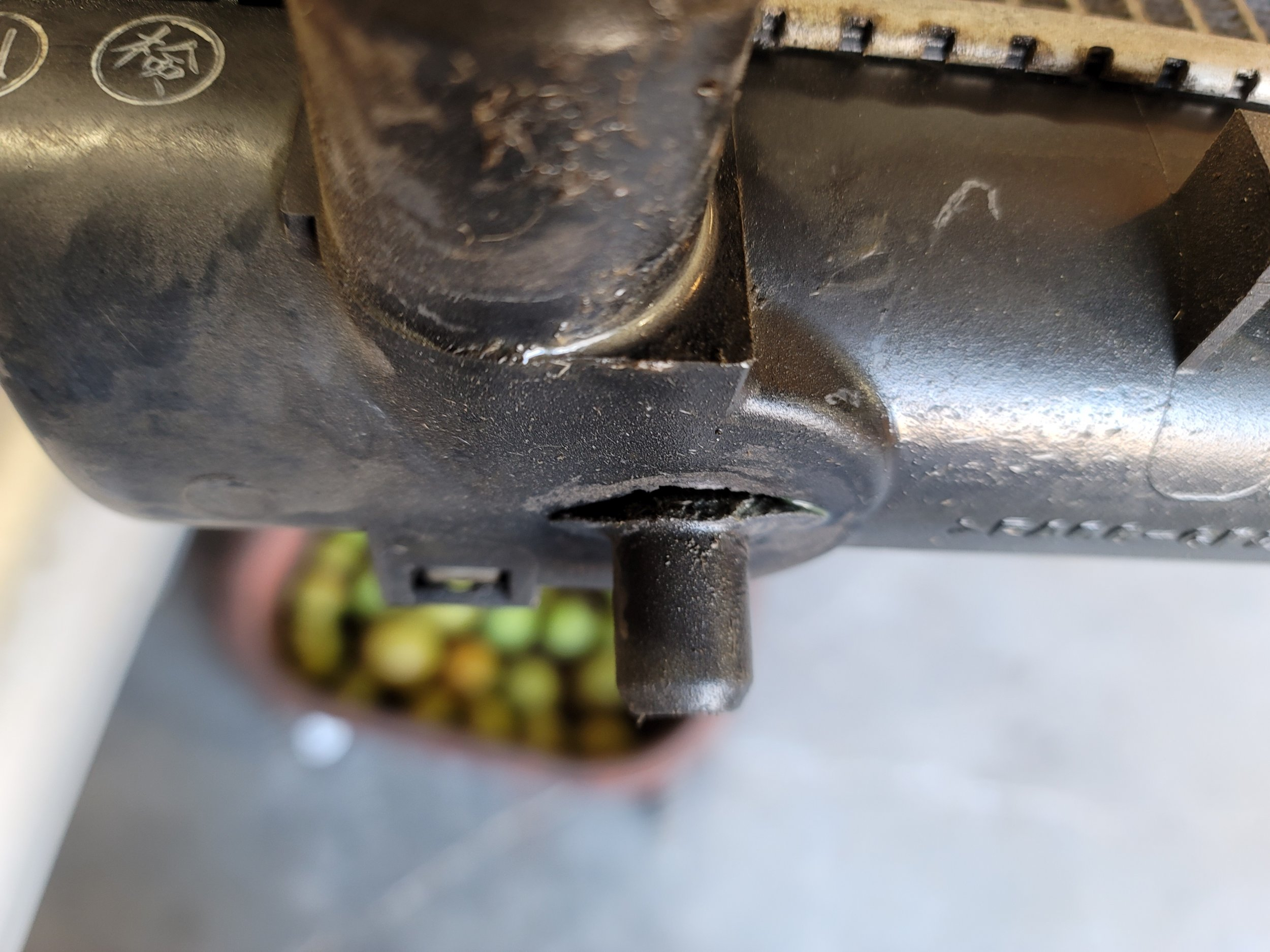

For what it's worth, and I'll say I'm not at all experienced. Last fall I broke my radiator on my B5240 Kubota pushing brush like a bull dozer. Not wise but ... Anyway everyone told me I could not plastic weld the bottom of the rad because it was a special compound. I had a $1225 quote for a new rad.
Instead I removed the rad and used a soldering iron to prevent the smooth surface. I tried to drag both sides of the crack together and make some under cuts that would provide a good surface for the $7.00 two part epoxy an old farmer said would definitely work. I had my doubts but it was worth a try. I put on two coats of the epoxy and put it back together. It's been just over a year and no leaks. I use the bucket lots to pound posts which I know I shouldn't but ..
