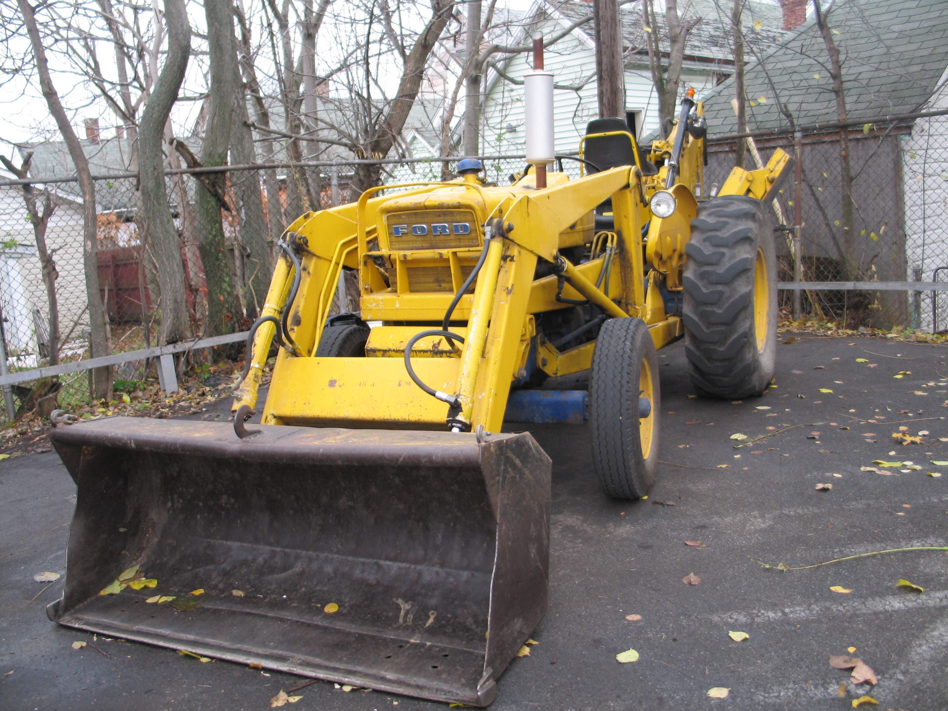

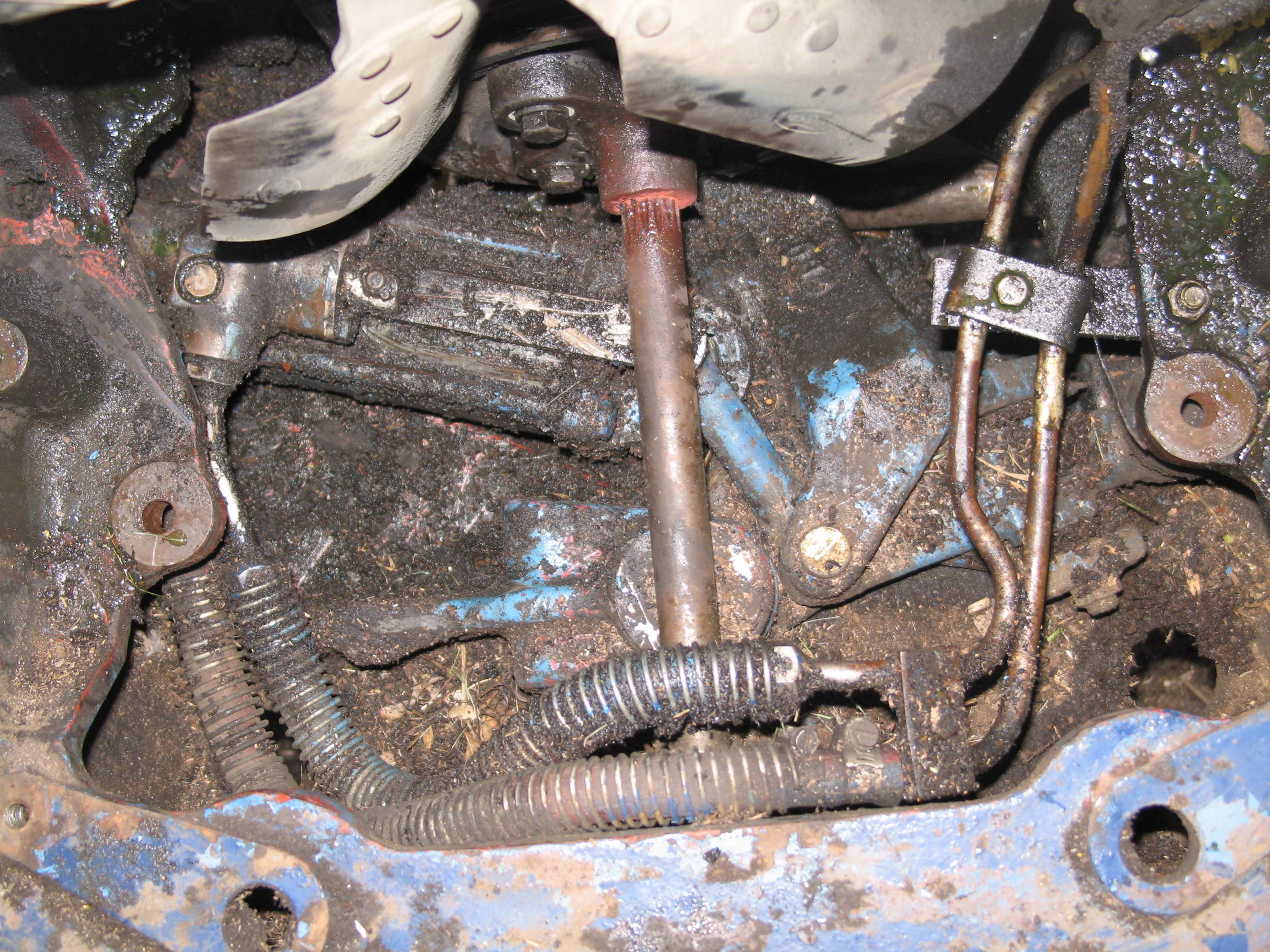

The latest on the tractor is that now the steering doesn't work at all and it quit leaking. This means I had to dig into it as soon as I had the time.
So here is the tractor.

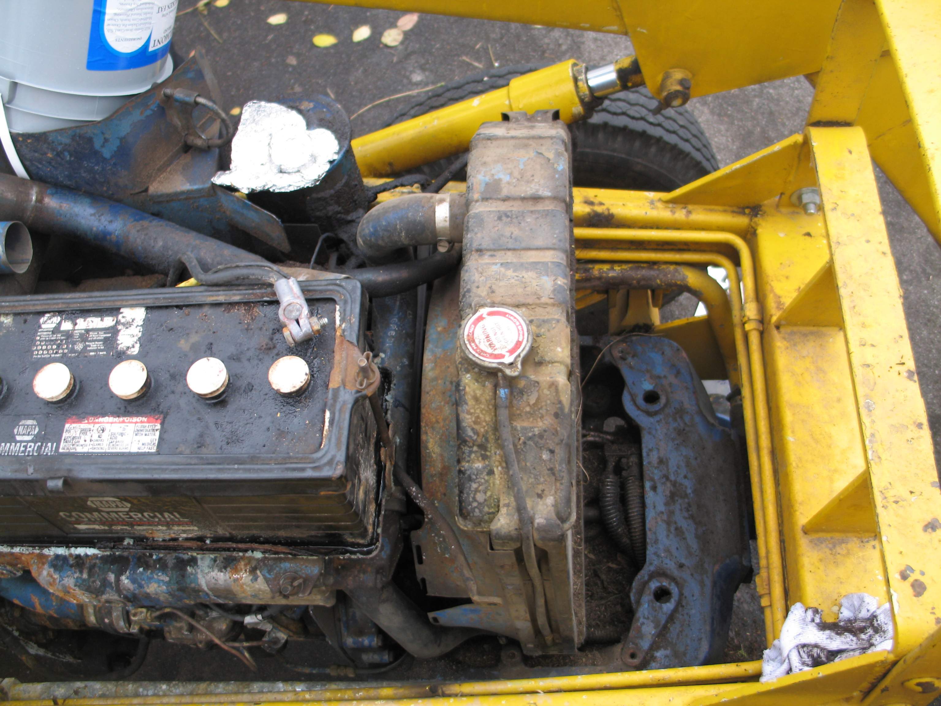

This afternoon we went over to work on the tractor and after getting into it a little found out that the pump is fine(I think). The leaking oil was coming from the power steering valve and cylinder area.

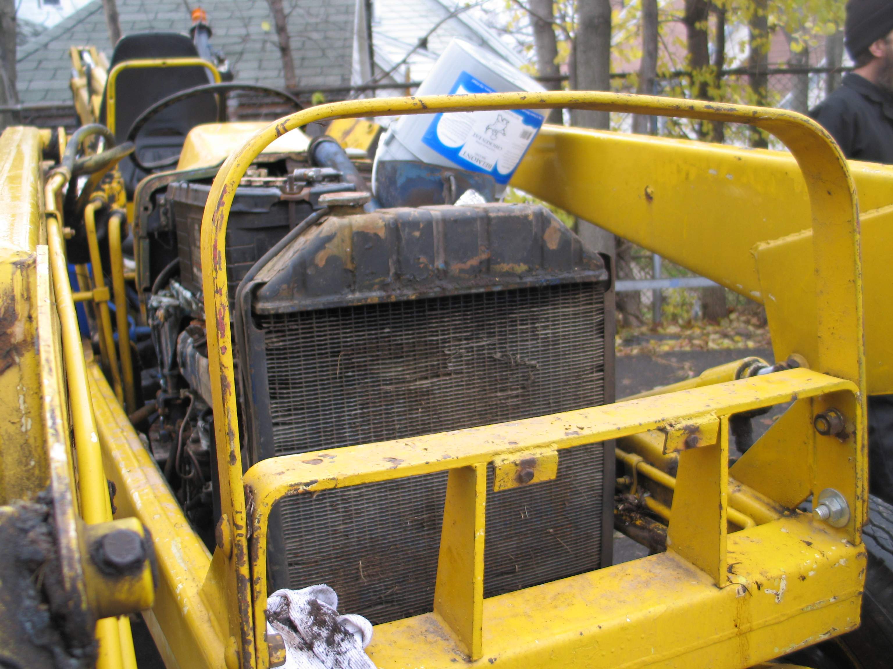

After getting the hood and grill off, we were able to get to the radiator.
We were able to remove the radiator which got us down to the steering linkage.

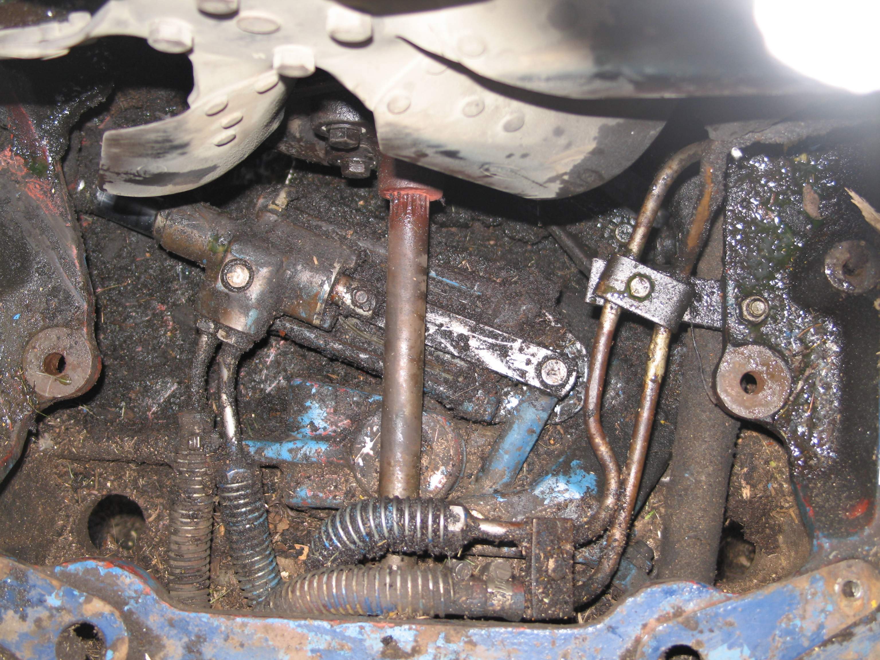

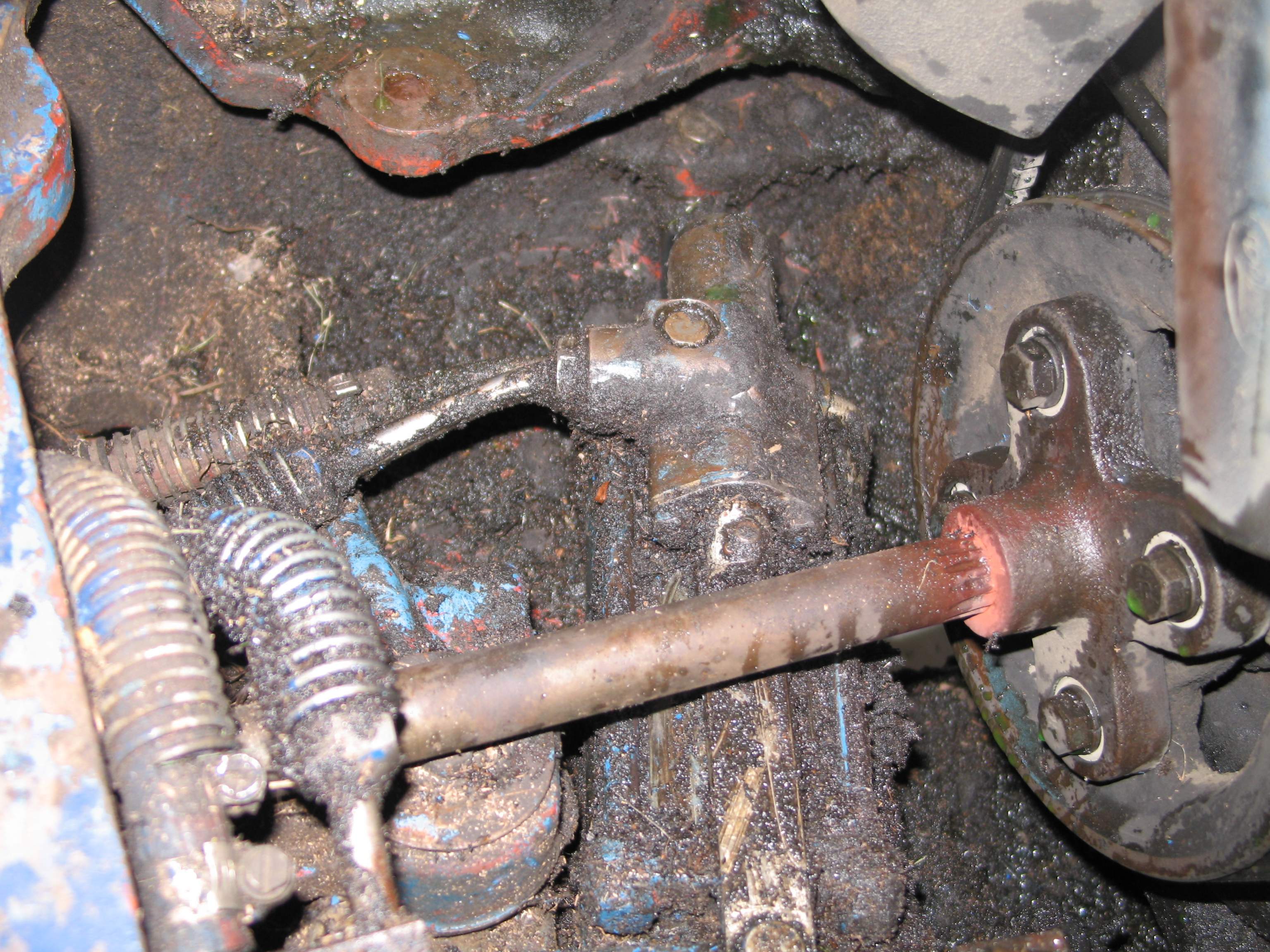

I think that the power steering valve is what is bad.
How do I remove the valve or the cylinder with the valve??
So far I have been able to disassemble it without an exploded view but I would like to know what next to get the valve out??
If there are problems with this post( pix to big/to small) tell me. I'm not sure how to do this.

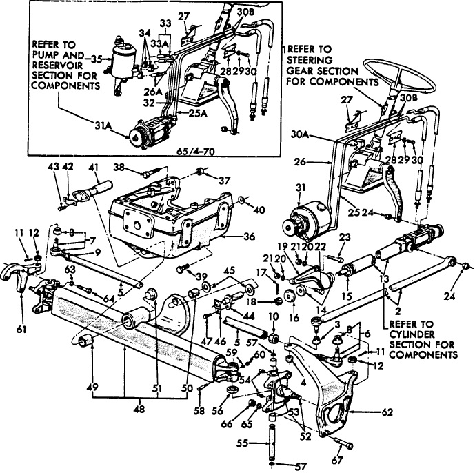

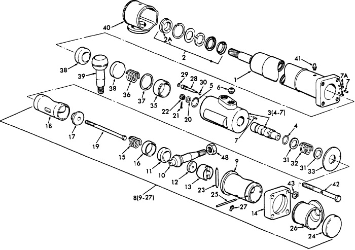

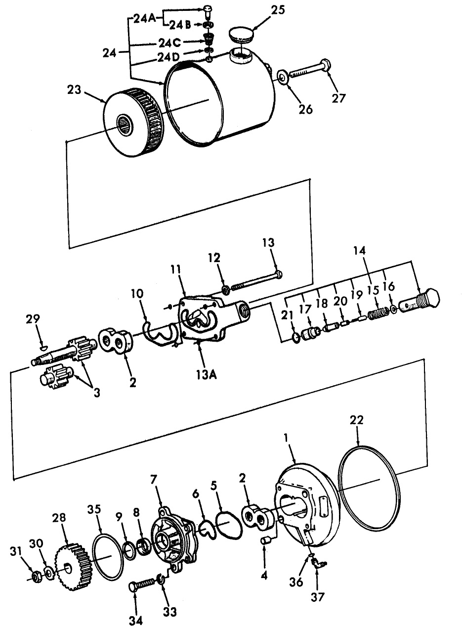

Tucker, I went to messicks.com and looked up the 3500 steering. The four photos below show the system components, but no details of how it works. The first illustration is the complete system and piping. The second is the PS cylinder detail and the third and fourth are the two types of pumps/reservoirs used on that model.
