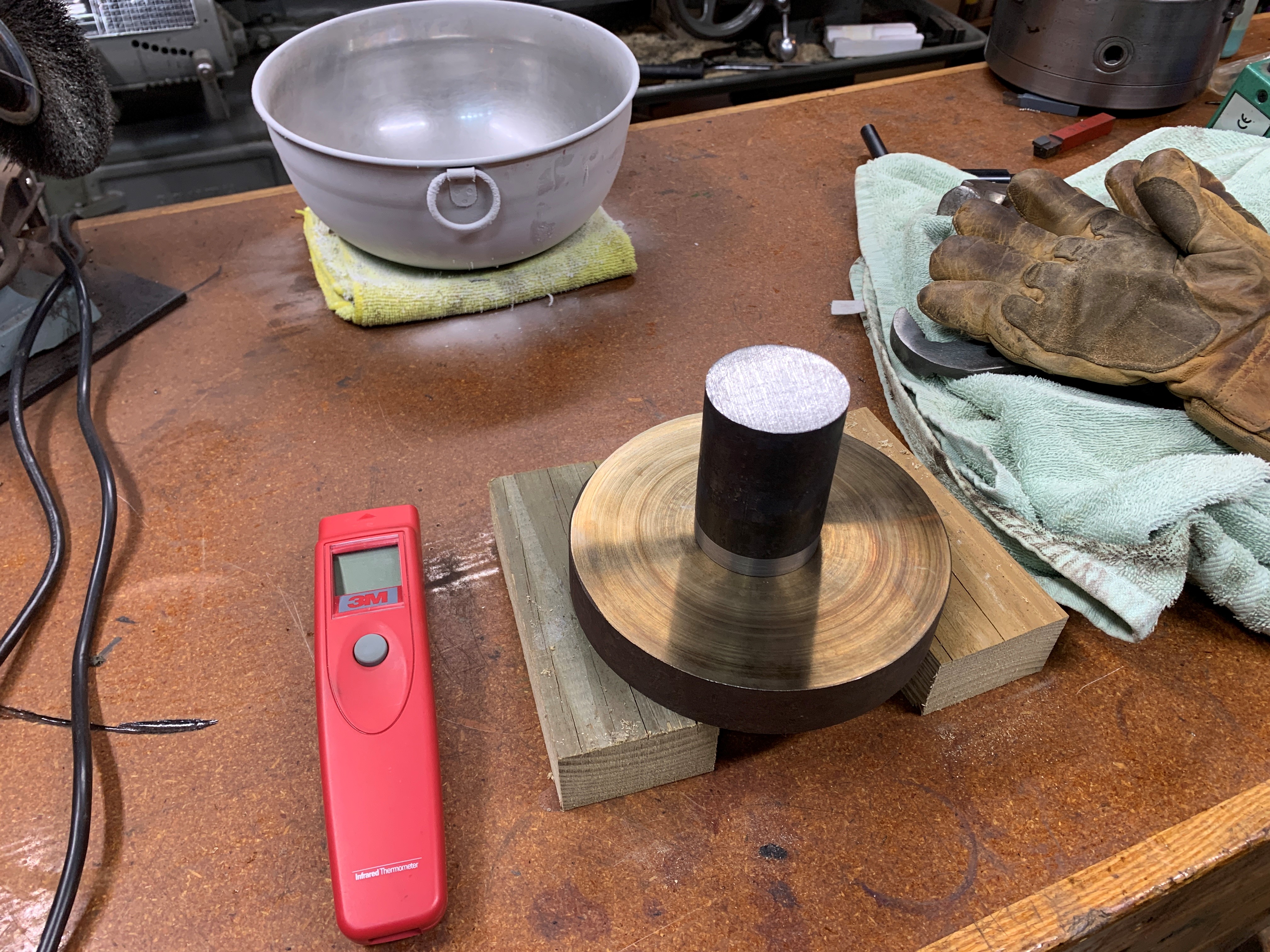

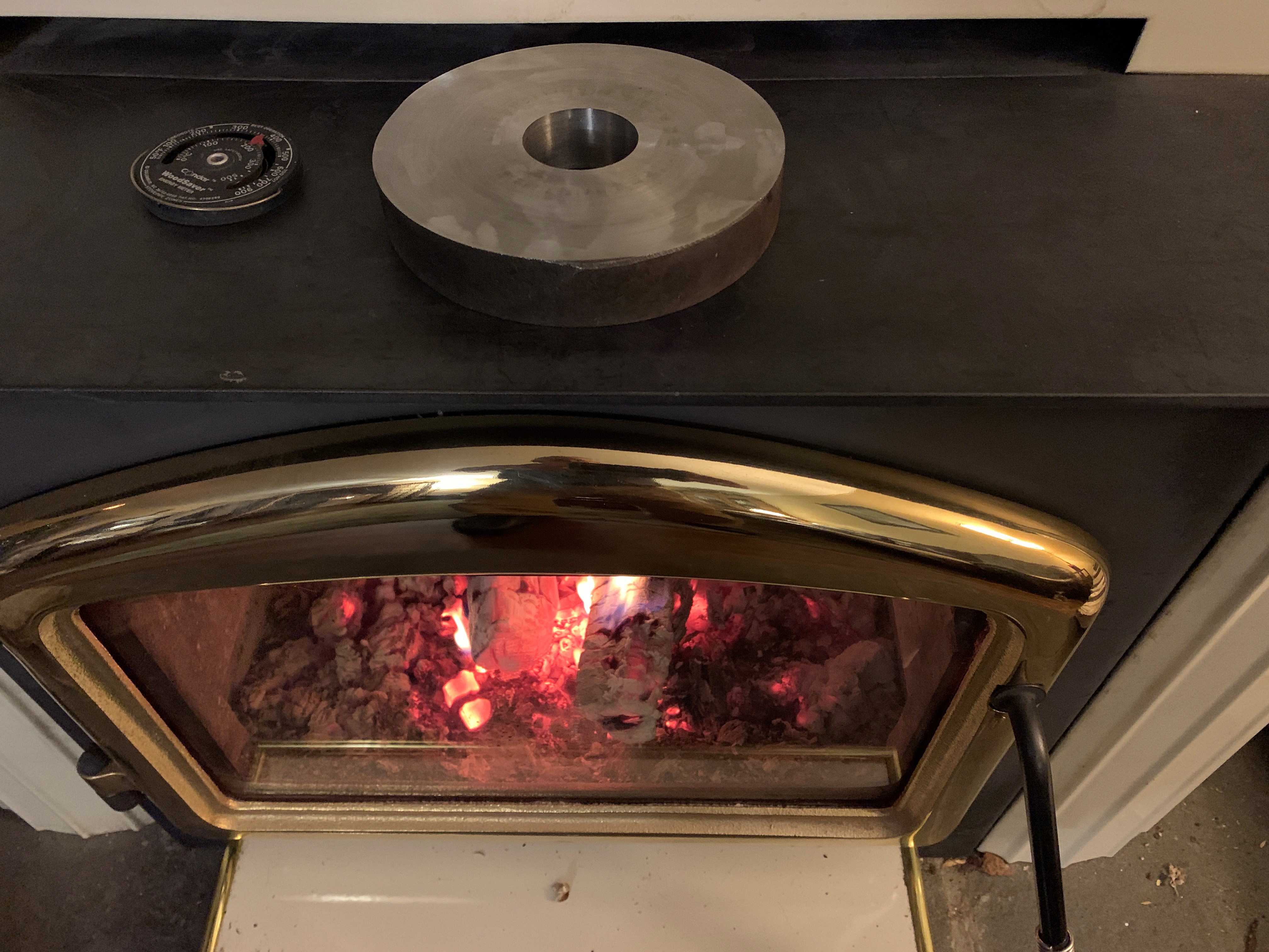

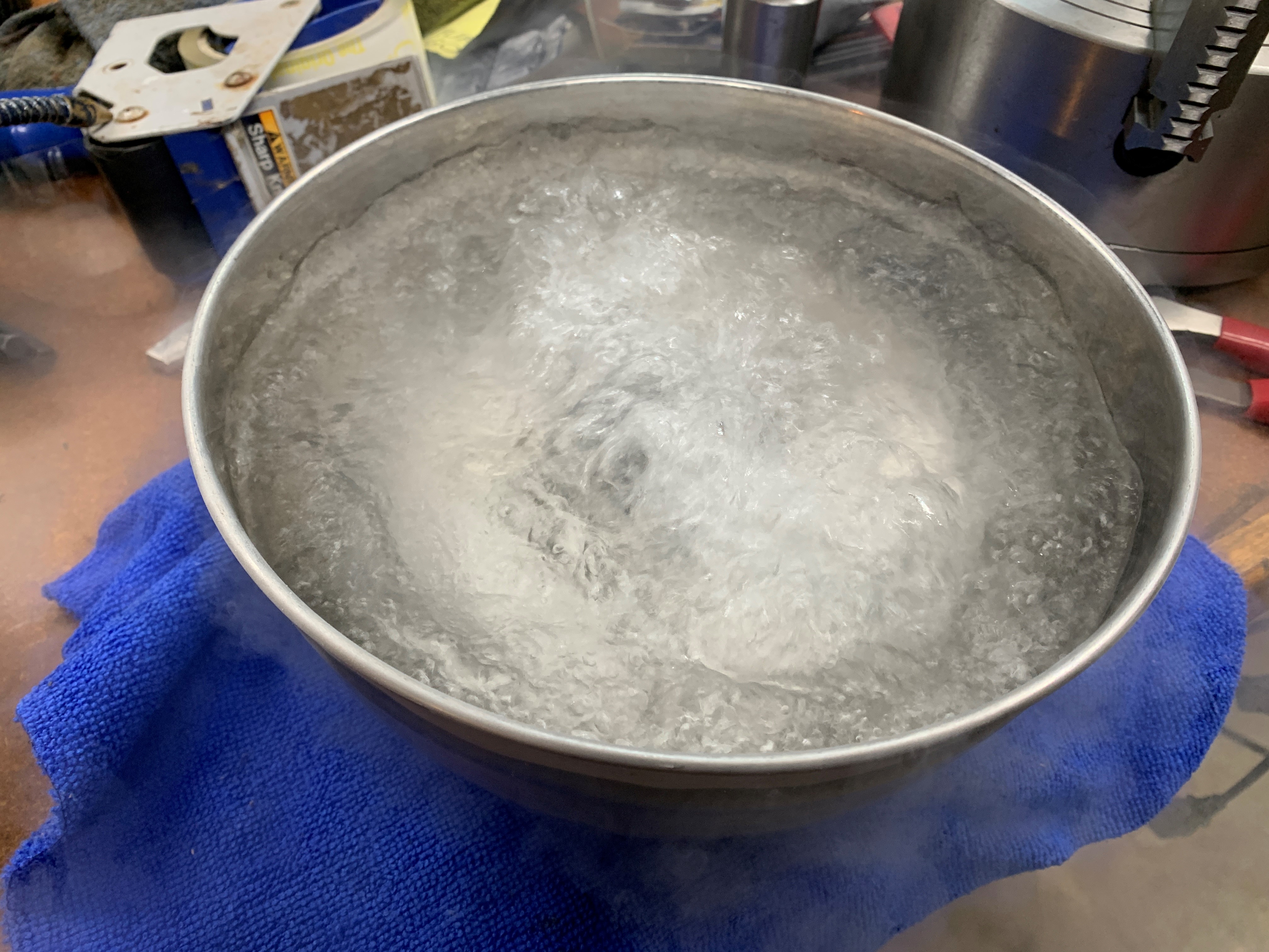

I completed machining of a mock-up gear and shaft, just to experiment with heating the gear and cooling the shaft while I take measurements to determine the changes. The mock gear was set on top of the wood stove for an hour or so, while I took measurements. The shaft was cooled in a bath of liquid nitrogen until the boiling liquid stabilized.
It's looking good.
Mock Gear ID inches:
66 deg: 1.7095
200 deg: 1.7200 << Edit: should be 1.7120
400 deg: 1.7350 << Edit: should be 1.7135
Gear temps were measured with an optical thermometer.
Mock Shaft OD:
80 deg: 1.7130
Cold: 1.7110
The cold temp may be approaching -300 deg F. Liquid nitrogen is at -320.
With these numbers, I would have .0035" of interference. I'm wondering if I would risk cracking the gear with that much stress. Maybe .0020 would be better. Anyway, tomorrow night I'll repeat the heating and cooling at the same time, and then slip the two parts together. I'm expecting that no amount of beating with a hammer will get these parts to budge after assembly.

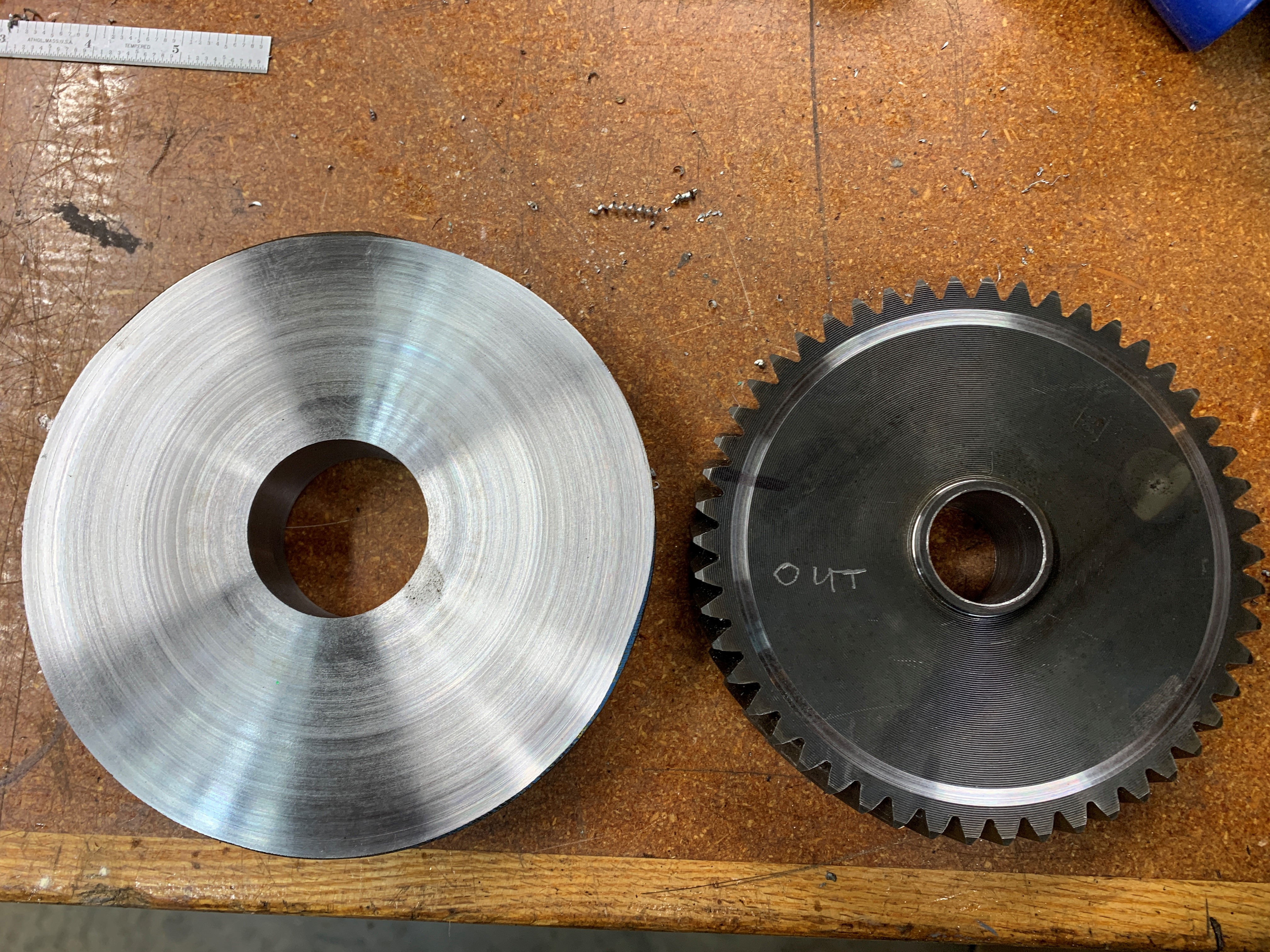

Mock gear and real gear
Mock gear and shaft:

Based on your dimensions i don't think that you need to cool shaft at all. The 0.022 loose fit at 400° will drop together. The extra 0.002 clearance due to the LN2 on the shaft is not necessary. Just set the gear on a wooden block a set the shaft in place. If you have a way to keep light press together during cooling, that would be good to ensure the shaft stays seated. Looking great, congratulations.
Reducing the interference to 0.002 should be fine. Especially if you still intend to apply the 10-32 threaded dowels at the interface between the shaft and gear.

If I keep the interference at .003, do I run the risk of cracking or fracturing the gear? I'll still add the cut off bolts.
If the shaft is fully cooled with LN2 (~ -300) and the gear is at 400, could the assembly of such disparate parts create a thermal gradient in the gear that could be destructive?
I don't have a press, so I could tap the shaft lightly as it cools and starts to bind up to keep it seated on the flange.
I'm inclined to skip the grinding step. It's a bunch of extra work to set up and perhaps adds risk since I have zero direct experience with this. And I don't have a diamond dresser for the wheel.

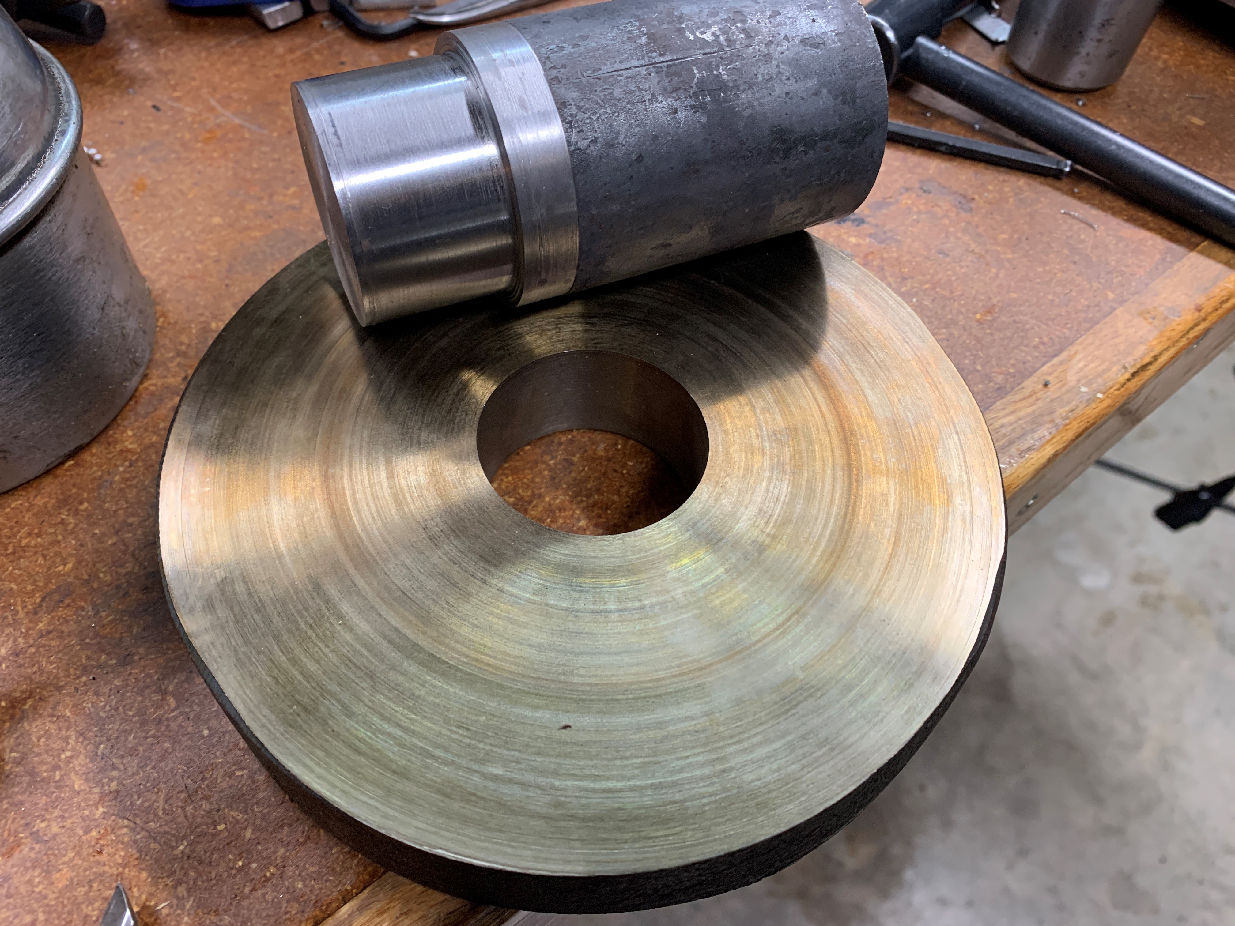

Today I heated up the mock gear to about 360 degrees and put the shaft into LN2. The two parts slipped together very easily and I was able to rotate the shaft in the gear for perhaps even a minute before it locked up. I could notice the parts starting to bind up. The shaft was tapped with a small hammer as it was binding up to attempt to keep it bottomed out on the "flange".
I put the gear in the vise and beat it hard with a small sledge no budge, as expected. Now on to the real stuff.

Great news, but photo did not come through.
Can you check mock up for runout?
