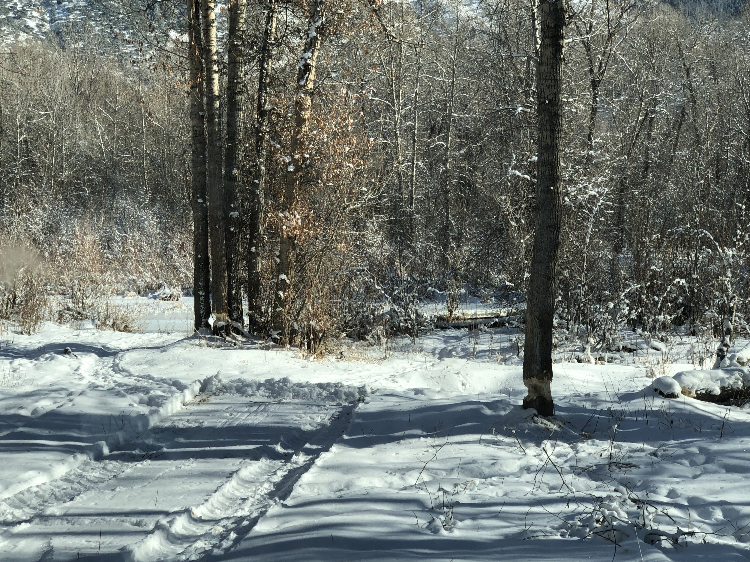

Howdy this is definitely off topic but I thought I would see if some of the smart folk on here could give me some advice. I live in Northern Utah and have acreage on the Weber River. We had a beaver family that did enormous damage to our cottonwood trees a few years back (prior to my buying the land). I had them trapped and sent off to beaver heaven.
I recently discovered that they are back in the neighborhood. It is to late to bring in a trapper as the river is already pretty significantly iced over so that will have to be done in the spring. I am wondering if anyone on here has had any luck with a repellent. I have read that hot sauce may do the trick but I have a very large river woodland area (at least an acre right on the river) so I wanted to get some feedback before I start in on this. They have already decimated two trees in a matter of a week or so to the point where I will have to fell them as they ready to go and are quite dangerous.
Any advice is appreciated. And, no, I can't fence the area it is to large.
Thanks,
Kevin

Actually freezing over helps the trapper. Call a trapper.
I've got a few problem houses I need to set up myself, but am waiting for things to freeze solid. I just found another one tonight, we already are losing a culvert because of it. The cold also makes the fur prime up. 👍

Our local parks department loosely wraps chain link fence around the trunks of any trees they want to save in the local parks near the river and small lakes, ponds. Works great.

You will have to protect the trees you value the most until the beavers leave. I used chicken wire wrapped around the larger trees I wanted to keep from being killed off by the beavers.
Trapping the beavers will only buy you some time.
We had to install a beaver pond leveler in the dam to force the beavers to leave, there are more than one conversations about beaver issues on TBN, but this is what we did, https://files.dnr.state.mn.us/assistance/backyard/privatelandhabitat/clemson_beaver_pond_leveler.pdf
