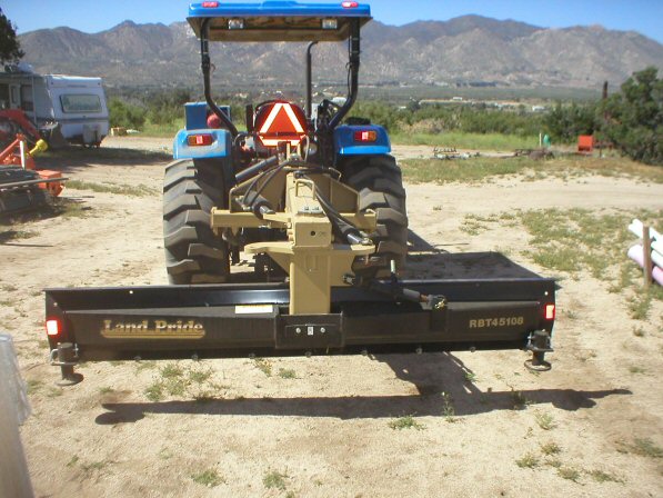

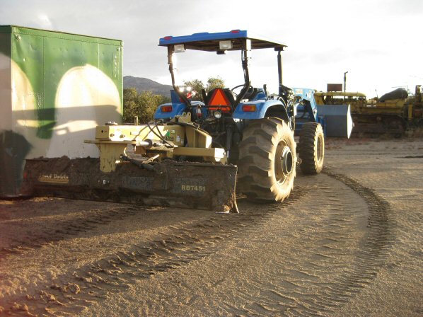

Yes and no. For grading, the "T&T" is all most anyone needs. :cool: But for ditching, you still need to tilt the blade more that what you can get out of the hitch. Because I don't do much ditching, I left the tilt of my Land Pride RBT45108 for manual adjustment and have the offset and angle hydraulic. ;)
It's not just the fancy blade that you are getting, but weight. An RB1684 weighs 319lbs where as the RBT3584 weighs 709lbs. You can get a whole lot more out of the heavier blade and have it be dependable vs just adding weight to a lighter weight unit.
That's a nice blade, what do they cost? I suppose a 84 inch would be the right size for my 4720?
