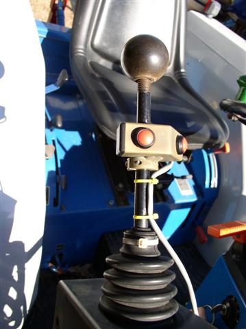

I bought a 12VDC 3rd function valve from Surplus Center ($110) and added some relays and built a push button set for my loader stick using 1" tube and a split collar. The non motor spool is a minor issue as long as there is not much inertia load back to the motor. Something as lite as a PHD at less than 10 gpm I would think would be OK.
