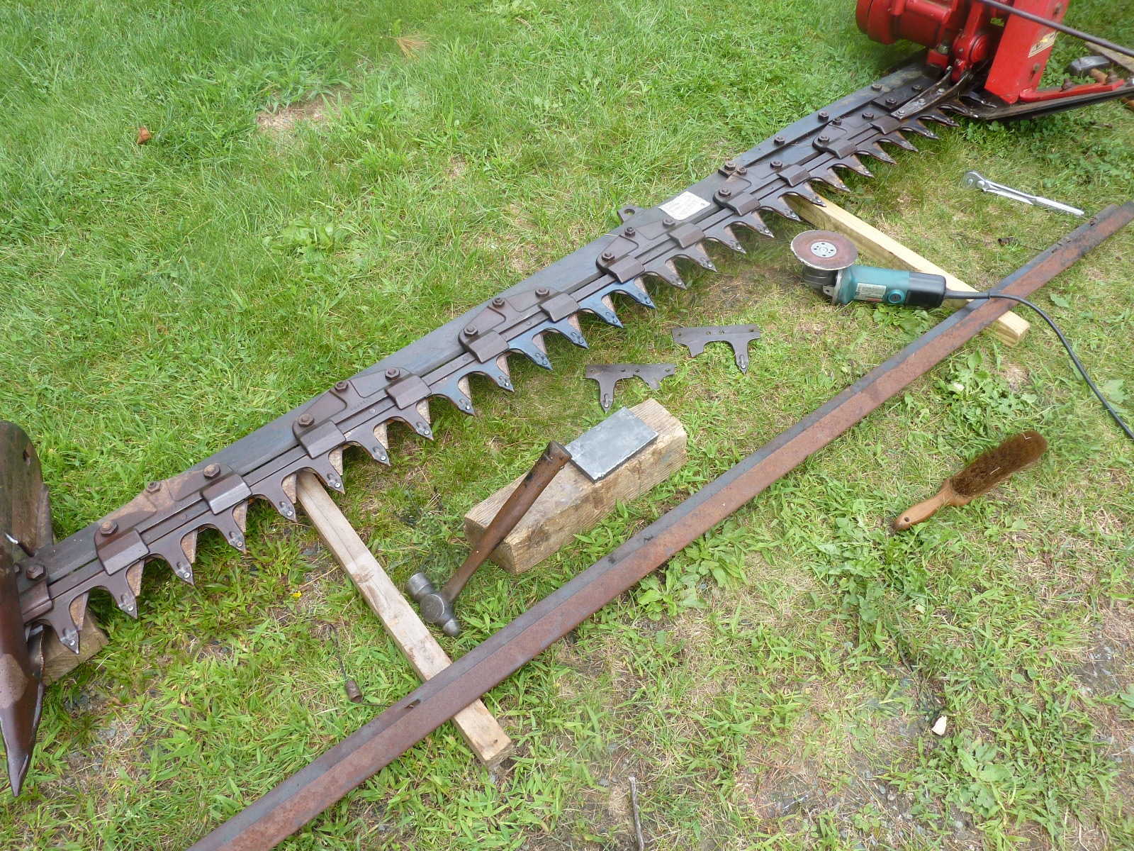

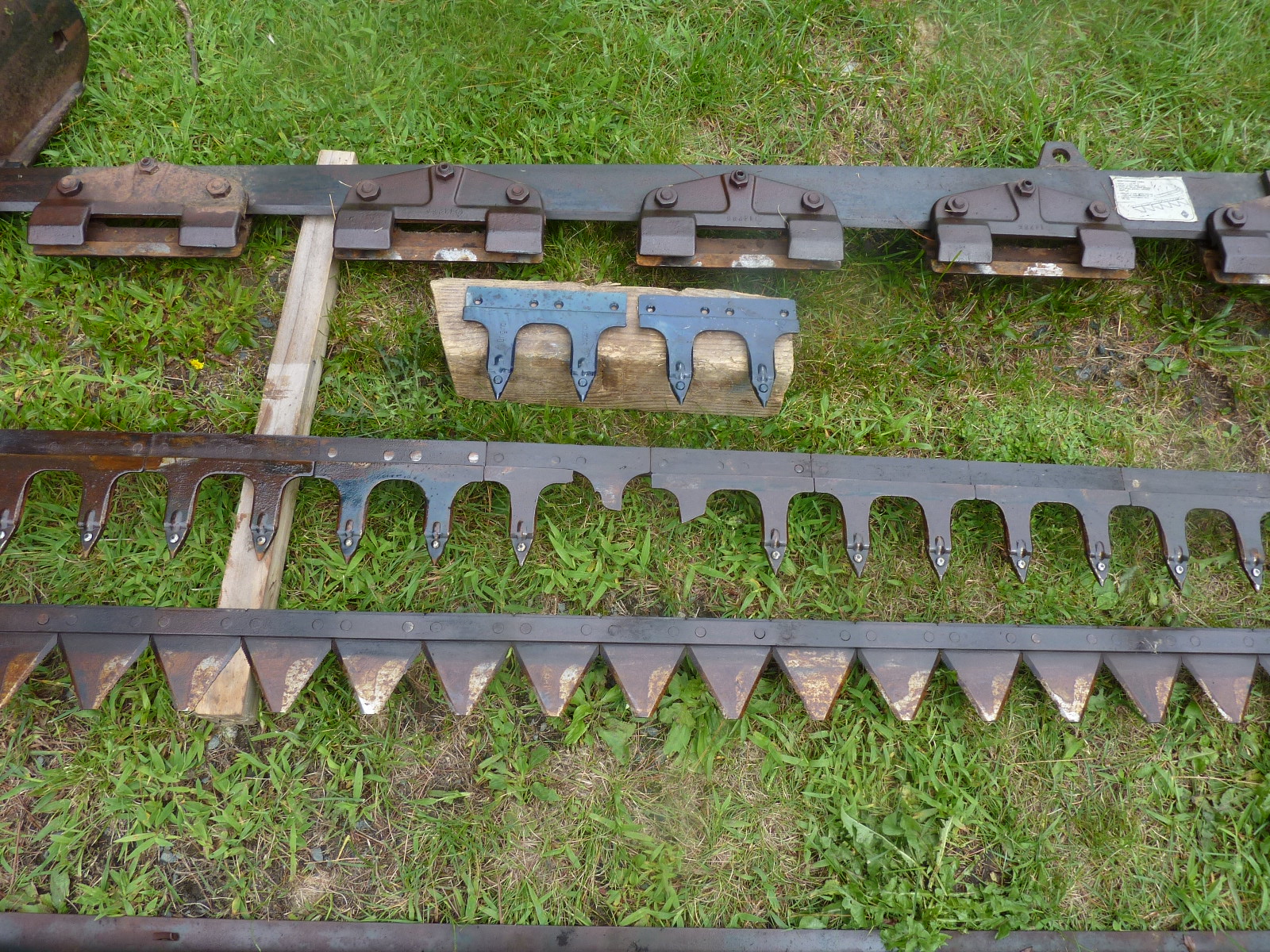

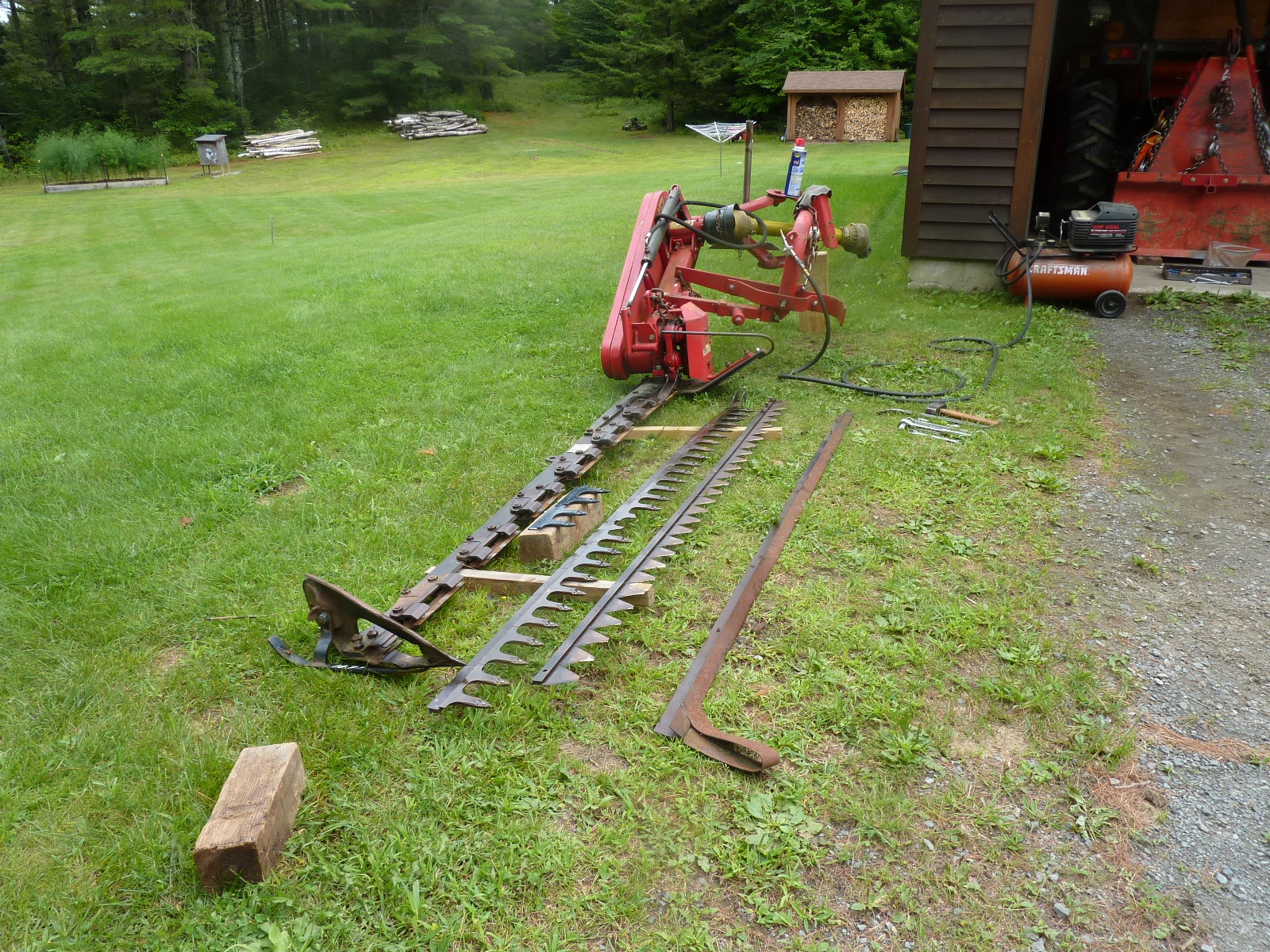

I use my Sickle Bar as a roadside mower so it has a hard life when the grass is high and I can't see. Once a year, if needed, I take the bar apart and replace any broken knife sections or guard/guide teeth. This year it was only broken teeth from trying to cut a rock. It comes apart easy. The opposed two moving bars slide out of the main bar after they are unbolted from their drive levers. The knife section bar slides out from the tip end and the tooth guard bar slides out the other way from the mower head end.
Each knife section is fastened to it's bar with two flat head rivets and each pair of tooth guides has four rivets. I had a couple broken teeth and needed to replace two pair of tooth guides.
Just drill and punch out the old rivets, Put on the new parts and use a ball peen hammer to clinch up the new rivets. If the heads are to high grind them flush. Here it is all back together. Pretty simple.

Fastest way to remove sections. Bench vise. Open the jaws just wide enough for the section to slip thru, point down. Not so wide that the sickle bar will also slip thru. Position the bad section, tip down in the loose vice with the section bar resting on one vise jaw. Smack the top end of the section you want removed with a shop hammer. This action will shear both rivets. Depending on accuracy and personal strength this will be accomplished with 2 or 3 strikes of the hammer. Job done.
