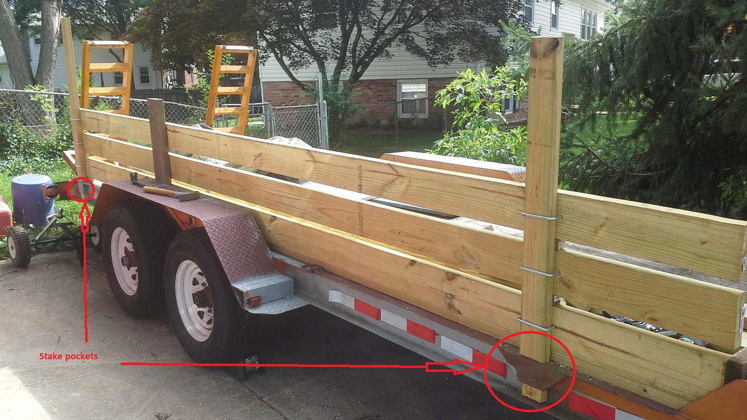

Has any one replaced the fenders on their equipment trailer. I just bought a Load Trail 18" trailer and needs work. The fenders are cracked, bent, and rusted through. I would like to put the same style back on it. 9" wide 72" long steel with the tread plate pattern. Did you order them some where or have a fab shop make them? I am trying to find them in Ohio because the freight costs more than the fenders. Surely some one makes them in Ohio. I called Moritz trailer factory near me and they would not talk to me about buying fenders from them. In rebuilding a trailer, if you are not careful you can get more in it than you could ever sell it for if for some reason you didn't like it.

I understand the need for steel. My Hudson has heavy duty diamond plate. I think they are 1/4" or thicker. I stand on them frequently when loading the trailer.

Do your current fenders come off or are they welded on ? You might consider making them removeable - very handy when loading pallets etc. on an equip. style trailer as well as when opening doors on a trailered vehicle.
My Load Trail equip. trailer has them and are pretty handy. 1 bolt front & rear and they slip up & off the small brackets welded to the frame. Have to disconnect the wiring connector for the clearance light. Would be fairly easy to weld a couple small brackets to your frame and then weld a pair of matching gussets, 1 to the frame and the other to the fender and use a bolt & nut to secure. Those fenders in steel are fairly heavy though but plenty sturdy.
