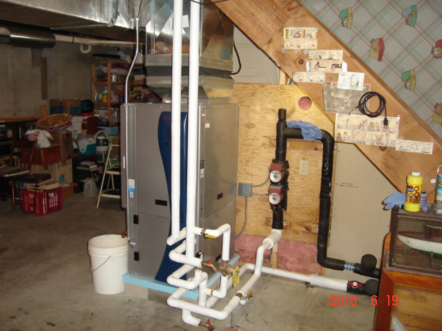

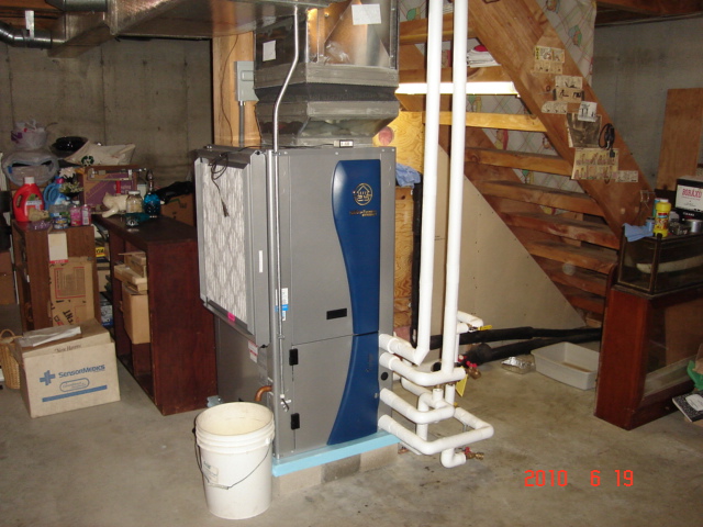

Well- After a false start of sorts, it was discovered that the unit delivered to me (42K BTU) WAS in fact too big.
Yesterday it was pulled out and a 30,000 BTU unit installed. When I got home it was up & running.
Man, is that thing QUIET!!! Compared to my old one, I can't even hear it! From upstairs, I can't even hear the fan, in fact one has to stand directly in front of the filter to really hear it:eek:.
Preliminary numbers are in:
In A/C mode--
TD across the coil: 20+ (old one: 15-18, for an increase of 25%)
Run load amps: 7.8 (old one: 11.8, for a decrease of 34%)
COP -estimated- 4.5 (old one: 3.25, for an increase of 38+%)
This thing is rated at between 4 and 5 COP, so I used 4.5....
SO: it certainly appears that I'm getting a substantial INCREASE in performance, with a substantial DECREASE in electric consumption.... and I can hardly hear the thing!!!:D:D
What's not to like? ---Happy Camper in NH!
(PS-- Guess that #8 wire ought to be able to handle it OK....:laughing:)

What's the blue under the unit? Is it set on foam board?

buckeyefarmer- yes, that's 2" styrofoam. The new, smaller unit was also shorter. You'll notice the transisiton in the discharge duct that was added, to couple with the one they had on the larger unit. As the new heat pump was still a bit short, they raised it 2" with the foam board.
It actually makes a good vibration isolator-- I had some under my old one, too.
Incidentally, that variable speed high-efficiency fan is hardly sucking any juice at all! I'm leaving the fan on continuously at this point; when I went to check it with my ol' Sperry clamp-on, on the lowest amp scale --6 amps-- the needle was hardly deflected at all, just enough to see it move. Half an amp maybe?? Wow!
Also, that amp reading for the "whole" unit in A/C was on the heavy leg --the one that has the two 120V circulator pumps on it; the other leg was registering only around 5 amps, and keep in mind this unit is 30,000 BTU where my old one was 24,000 BTU...
I just can't believe how much more efficient this Water Furnace unit appears to be. Also very well constructed- somebody paid a lot of attention to detail when it was built; very neat.
So I guess at this --admittedly early-- stage, I'm extremely pleased with the machine.
