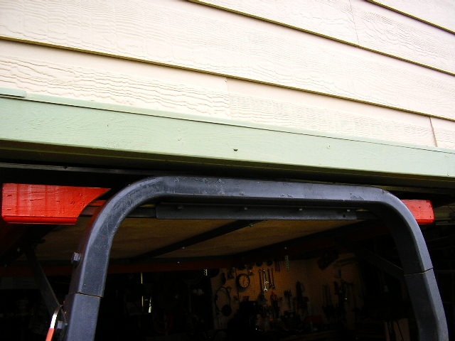

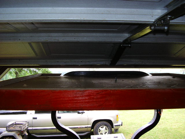

OK if you just want to shorten the standard rops, that's what I did. I cut 2" off the top piece, and redrilled the top hold. I have 1/2" clearance between the header and rops. Slightly hard to rebolt, just needed a clamp to pull it in about 1/4" and it ain't comming off again. I got pics at the office.
Rob
   / replacement rops for jd2305 #14
Pic of my handy work....So sue me!! :D
But it fits! Actually with the turfs, it was lower and fit. The R1's added some height.

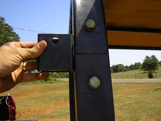

Ray, I had one of the Standard L tractors, the 4WD version of what Rob has.
Its ROPS was in 2 pieces, bolted together with sleeves inside. I took it apart
once and it was difficult for one person to lift up (hard!) in just the right
part of the center of the top of the hoop. I think a telescoping roll bar
would work, but it would be harder than a folding one to adjust. A least
it would not be left in the folded position!
Notice I did not say don't do it. I shortened up the ROPS on my Kioti and
I used sleeve plates inside the rectangular tubing to provide additional
strength at the welds. I can drive it into my workshop now, though I did
install an 8x8 sectional door. I never fold it, though I still have the joints.

I wonder if you ran into what I did. I took out the top to bolts to pull it off. Very hard as you say. But while fiddling with it I losened the bottom bolts of the inner sleeve. It would slide on and off real easy then.
Last time I took mine off I took it off with the cover in place. Almost killed myself. 2 man job. Even when I put it back on I tried to put the cover on separate...again almost killed myself...another 2 man job. When I orginally put the cover on I just put up the lightweight frame first, then added the plywood. I hope I NEVER have to remove that thing again.
