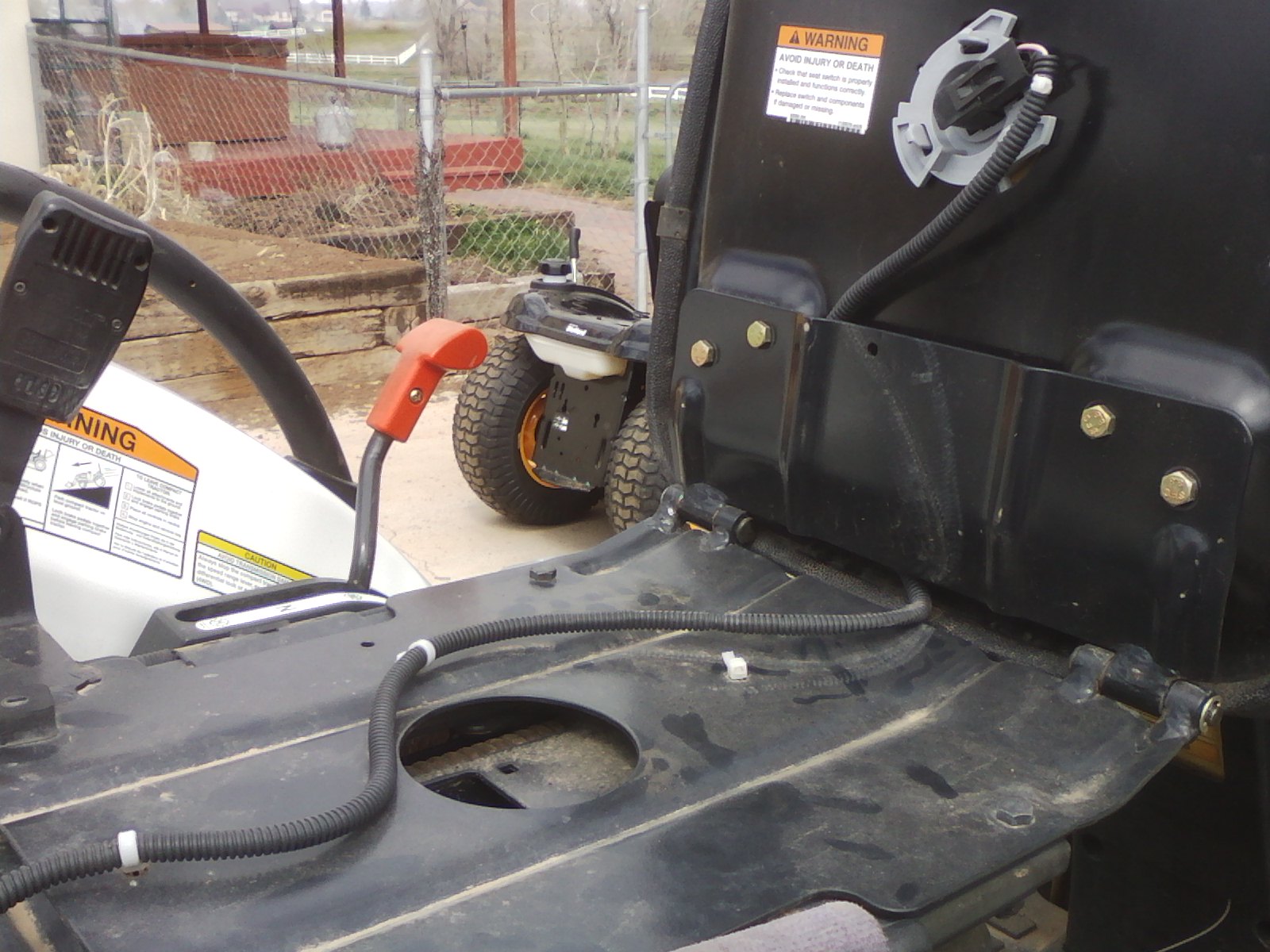

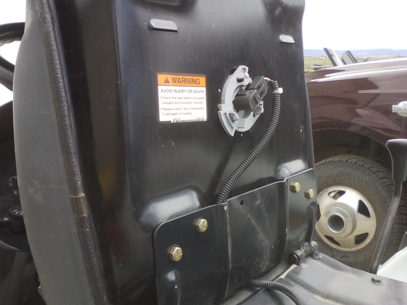

I just had a good look at the Bobcat parts catalog. They have updated it with better picture viewing. There were two seats available a Standard and Deluxe suspension model. I have the deluxe model with the seat safety switch mounted into the seat base and not on the frame. I am attaching pictures.
However the standard seat appears to have a different switch mounted to the seat frame, and not the seat that might work on the typical replacements I am finding. Could someone please post a few pictures of the standard seat safety switch set up. I am hoping that by changing out the switch I can install an aftermarket seat.
Thanks for the help folks

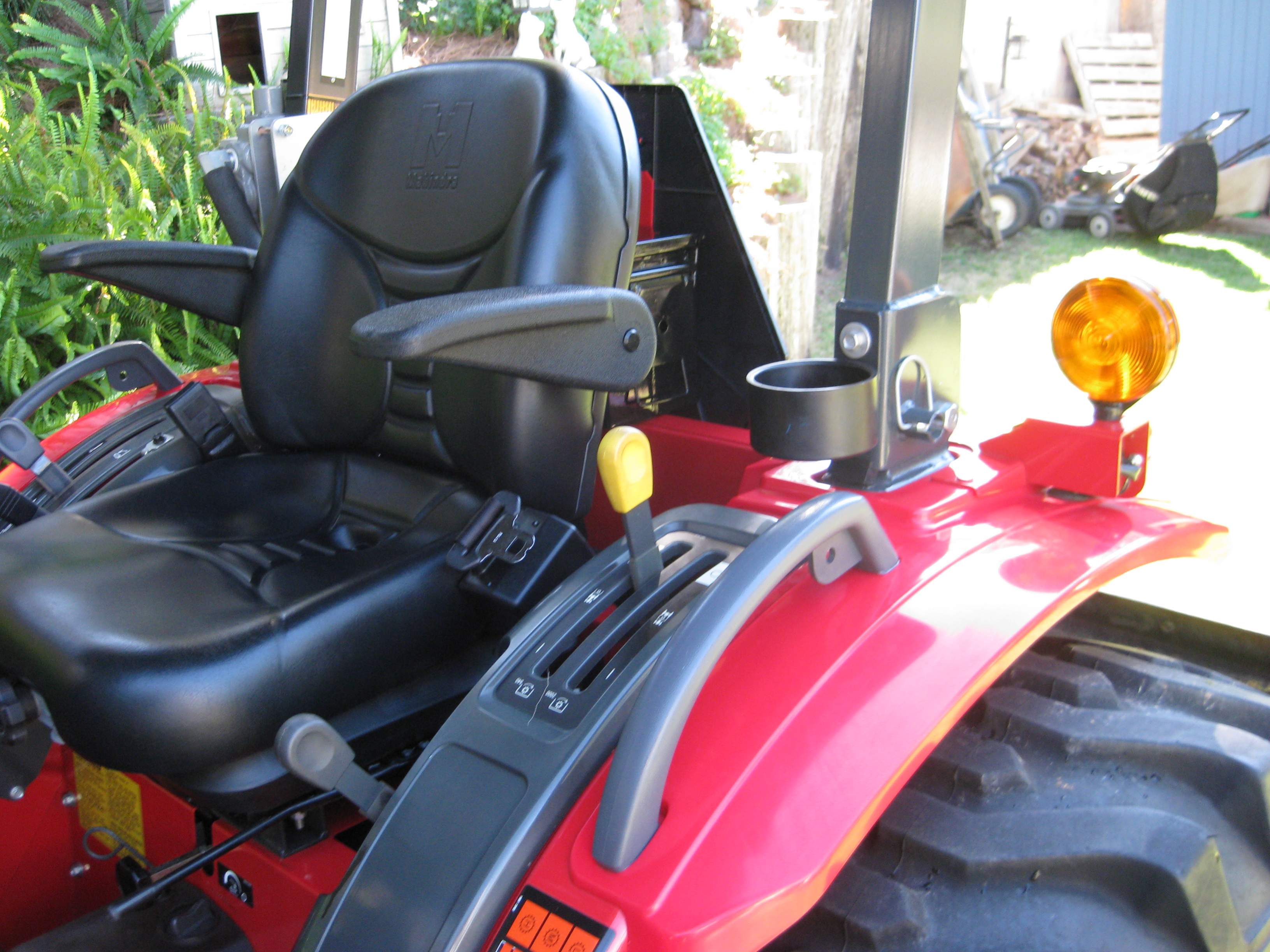

If it were me, I would use this seat, disable the seat switch and be happy and comfortable. I have the Mahindra version of this seat on both of my Mahindra tractors. Stock on the big tractor and requested addition on the smaller tractor. I have never gotten tired of sitting in those seats. :thumbsup::thumbsup:

Already have suspension seat, just need new cushion part.
