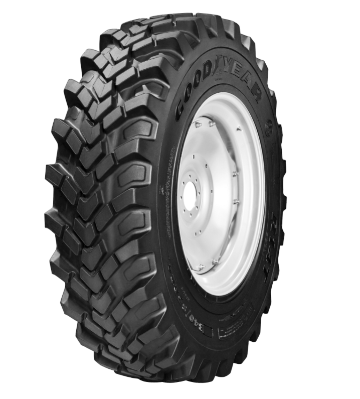

Tread design is the next problem. I like the new R14 tires which appear to be a cross between ag and R4 industrial. Don't know if they make them in that size.
View attachment 786560Let us know how you make out.
Thanks for the R14 tip. I will keep looking; the fact it is a Goodyear should (!) make it easier to find.
Do you have the R14s on your 1430? If so, do you notice any difference in performance? Soft ground? Amount of mud trapped in the tread...?

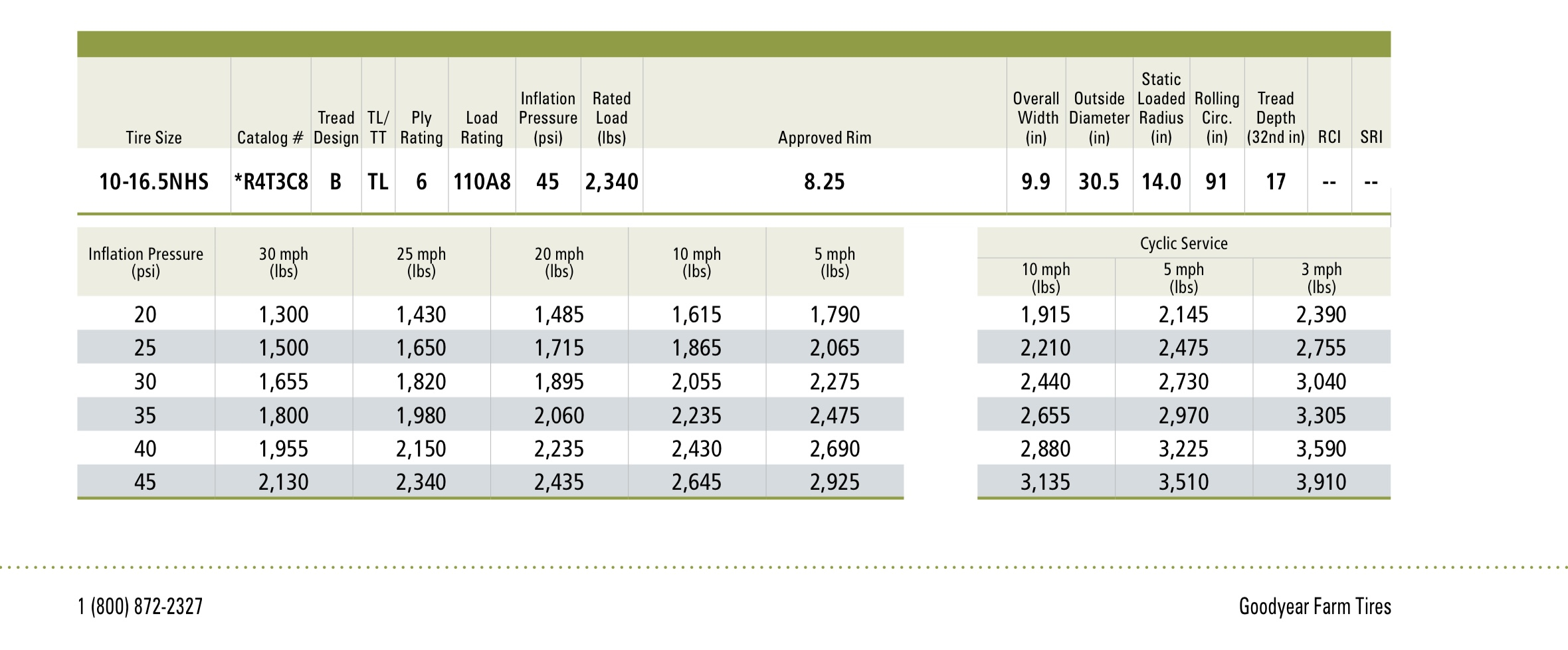

In case anyone wants it, here is the load table for the R14 Titan tire (aka Goodyear)
For two wheel, low speed use, it looks like the minimum pressure would be at least 30psi.
The stock Carlisle Trac Chiefs have basically the same load rating at 45psi, (3,500, vs 3510 above).
