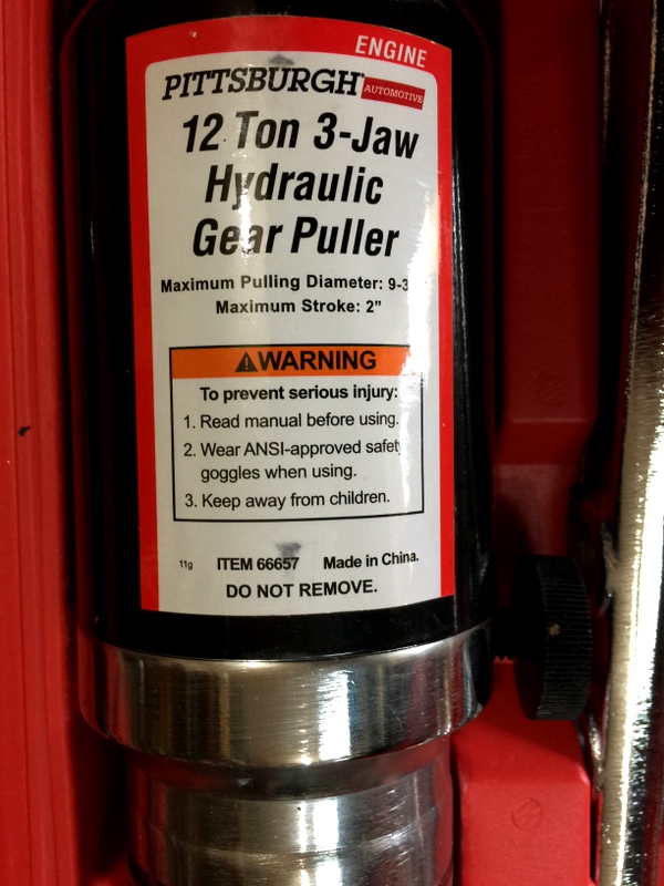

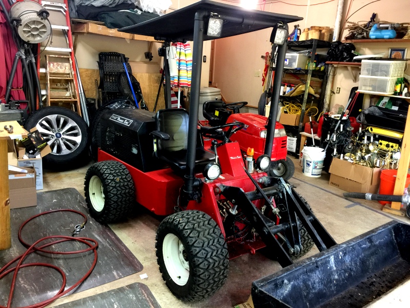

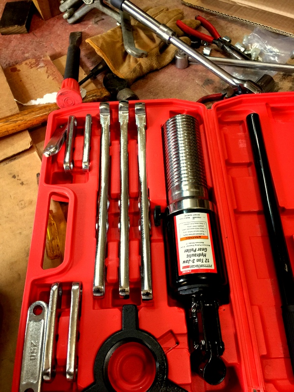

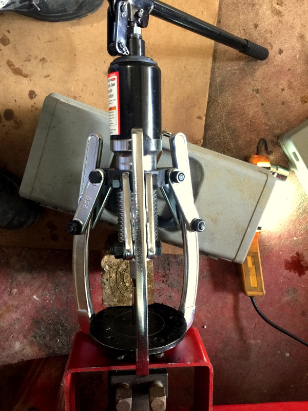

Well was time to replace another Wheel motor on the old girl =1425. The old one was leaking hydraulic fluid just a matter of time before I had a seal blow out. Probably in the middle of a snow storm with my luck. Anyway Getting the hubs off was a lot fun as usual. You can see with my first wheel puller the shaft bent and it still didn't budge the frozen wheel hub even after applying heat...
This time I decided to pull out the Big Boy. A 12 ton hydraulic puller.. It bent the old hub in three places before it shot off across the floor like a Rocket... The new one is much thicker .. I always stand to the side and wear shop goggles when doing anything like this. I know if it would have hit my leg it might break a bone or at least put a big indent in the shin ...

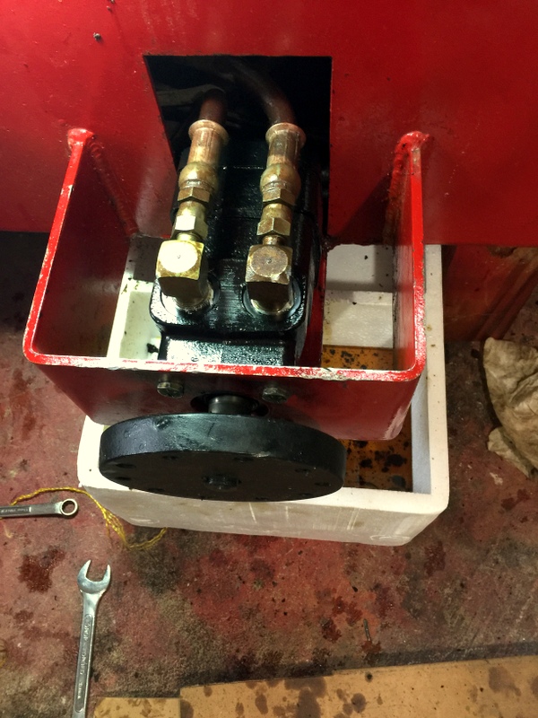

Now to replace the wheel motor and get messy with hydraulic fluid everywhere .. Had some coffee now back to the shop .. New motor installed .. Next take off my all metal gas tank replace the petcock put on new lines and clean out any debris that may have accumulated over the years still loving this old machine the Kohler runs like a top..

Nice going. Did you use PB Blaster or the like on the hub? I have had it work wonders.
/ Replacing another Wheel Motor.
Thanks Bob yes I did.. As you know every little bit helps .. 👍
