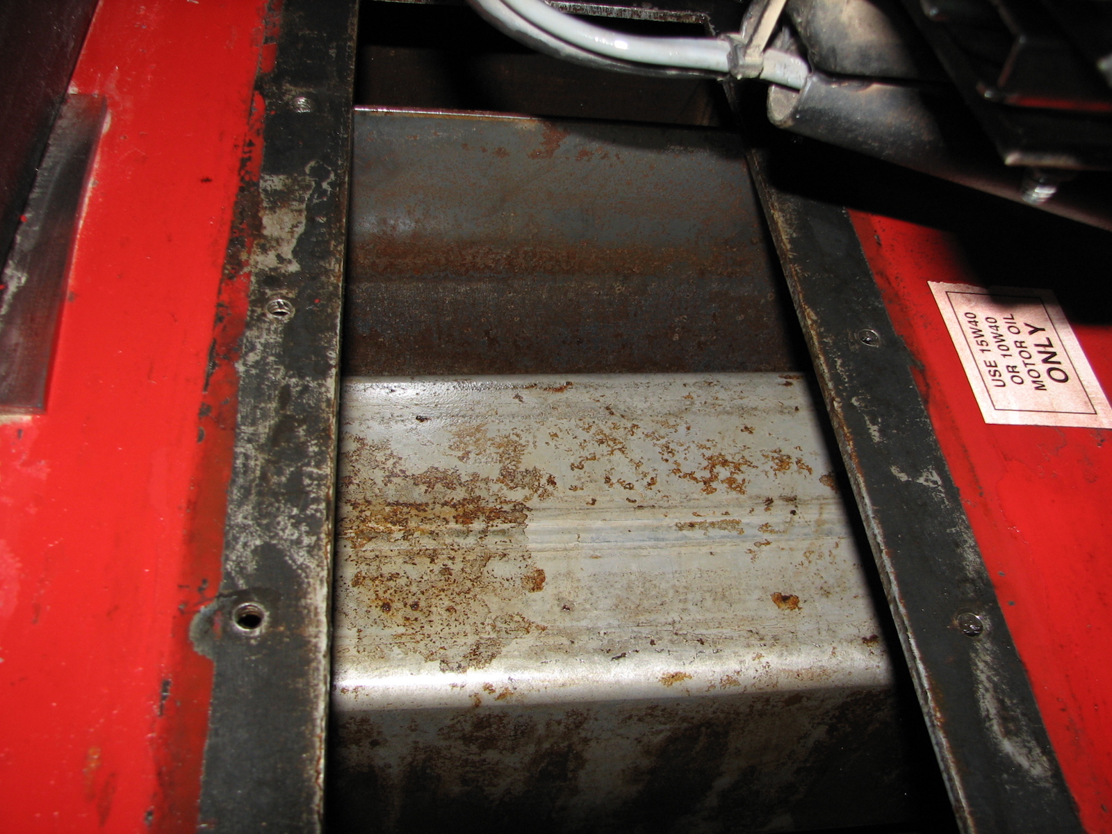

Anybody able to describe the baffles? Does anybody know their purpose?
/ Replacing another Wheel Motor. #23
As I see it, the baffles help prevent "short circuits" within the tank which will keep your fluid cooler, help reduce sloshing, help particles settle, and help prevent air bubbles from being sucked into a pump.

Here's a picture
/ Replacing another Wheel Motor. #26
Thanks. That helps.
/ Replacing another Wheel Motor. #27
Fellas... the baffles are the tunnel for your hoses to pass through to the front half of the machine..... and the others might just be structural. I'll have to take my cover off and look.
/ Replacing another Wheel Motor. #28
Sorry, Moss, mine also has a baffle at the returns - labeled in the first picture - if you look, there is a gap behind it. The tunnel is also labeled and will act somewhat as a baffle.
More visible in this picture: IMG_2732-small.jpg
Ken

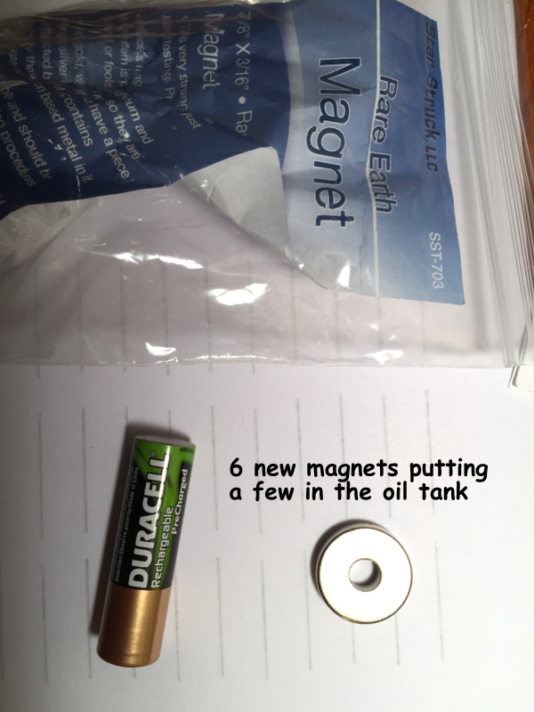

Maybe after changing out the motor place a few magnets around the tank and run it around the yard maybe 3 hours total. Then change out the all of the oil. Here is a picture of the wheel motor circuit from my manual ... Will ask Terry while ordering the new motor and see if there is a smarter way to circulate out the debris then change the oil and filter. Guess in the end you pay for it one way or another ..
