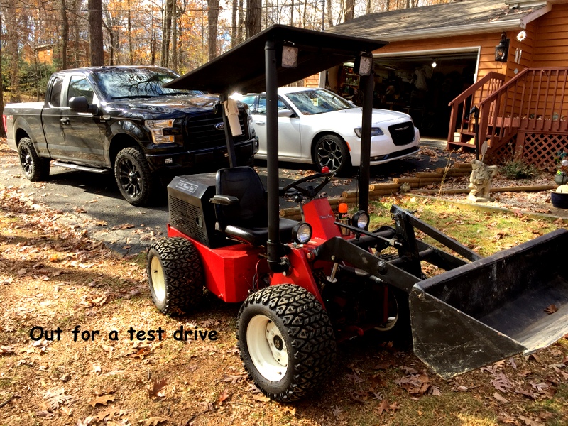

Is that a home-made bucket level indicator rod I see on your FEL?
Factory came with the PT ... Need to repaint it though ... Hard to see .. Can't wait to get this thing in prime condition so I can start ordering some attachments large bucket and forks to start ..
   / Replacing another Wheel Motor. #42
Mine had the same level as well. I took it off. Drove me crazy, was never accurate.
   / Replacing another Wheel Motor. #43
I had one on my IH2500b. It was useful on that machine because, like most standard tractor loaders, you cannot see the front of the tractor from the operator's station. No problem with that on the PT425. :D
#44
I plan to get off the machine and visually check the bucket angle.. Mark it then repaint it in a bright color .. Hopefully it will hold it's position and be useful for quick reference.. I find myself standing up and looking to see the front of the bucket.
Then again until I get around to ordering the larger bucket. I am using the smaller rock bucket.. It may be easier to see the larger bucket. I'm around 5'10 You guys may be taller.

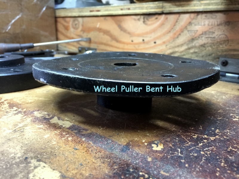

How did your wheel hub get such a bend in it?

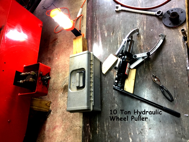

All the best,
Peter

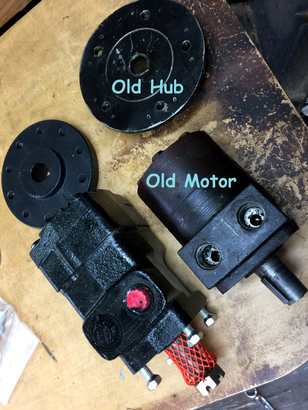

Peter the older hub as you can see in the picture was not as thick as the newer versions . This hub took a lot of force to get off. The 10 ton hydraulic puller just bent it before it popped ..

Wow! That’s a lesson in one line.
Thanks.
All the best, Peter
