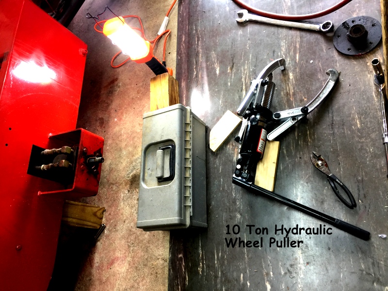

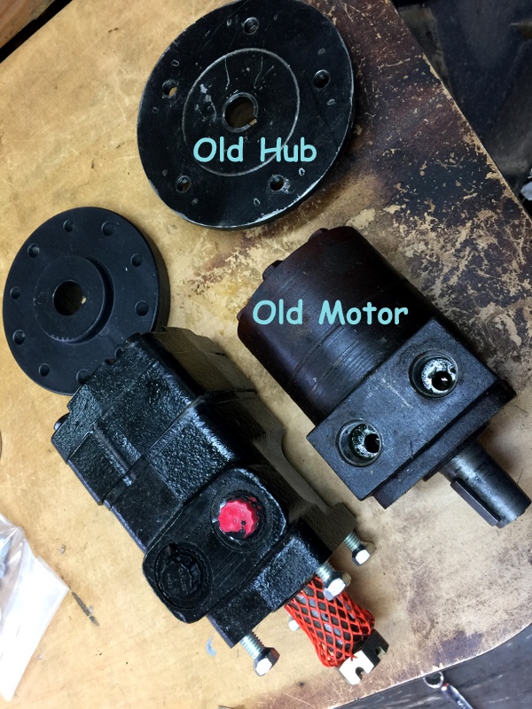

   / Replacing another Wheel Motor. #48
How did your wheel hub get such a bend in it?
All the best,
Peter
#53
All the best,
Peter
Peter the older hub as you can see in the picture was not as thick as the newer versions . This hub took a lot of force to get off. The 10 ton hydraulic puller just bent it before it popped ..

   / Replacing another Wheel Motor. #54
Wow! That’s a lesson in one line.
Thanks.
All the best, Peter
