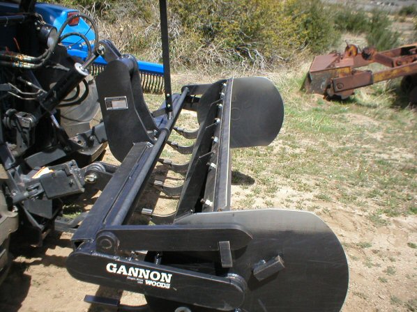

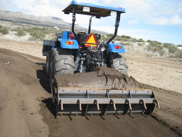

At least per Brian (MtnViewRanch) if he has the hydraulic top link, he won't get as much benefit from the rollover BB. It's most helpful for folks like me that don't have TNT so we don't have to manually tilt the BB to decide which blade we are engaging.
Kinda wierd for me to espouse anything other than a rollover, but I am quoting Brian. :)
The best other thing about the rollovers is their heavier weight and solid construction per foot compared with standard box blades.
Thomas
PS: I forgot to say that as TripleR said, we absolutely love ours and only remove it in favor of the ballast box when mowing because of the improved clearance with the ballast box.

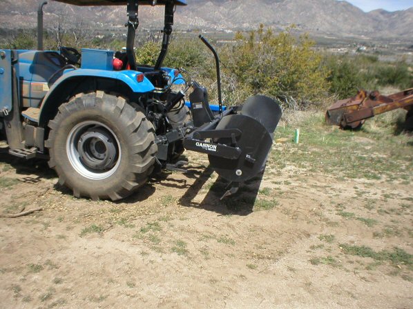

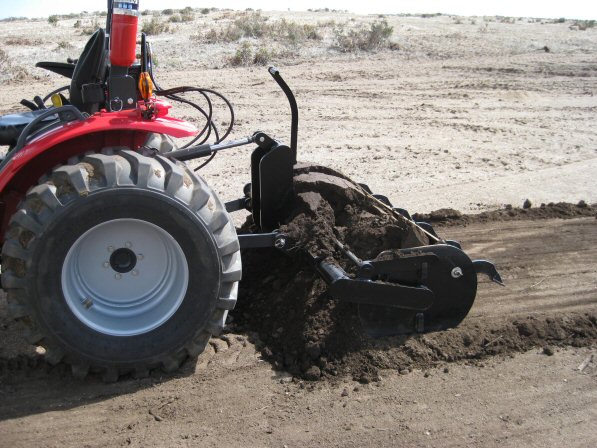

If you think about it, the ROBB was designed when no one had any rear remote hydraulics for their 3pt hitch use. It only makes sense that the top link wouldn't need to be adjusted after the initial adjustment, and typically it does not need any. I know that I very very seldom need to adjust the top link while using my ROBBs once the initial adjustment is made after hitching up.
Here is what I consider the best new ROBB available today, not as good as a Gannon ROBB, but you can only get what you can get. ;)
When using a ROBB, it is FAR more advantageous to have a hydraulic side link than the top link IMO. :wink:

While the EA box blade is built very strong and is not going to have structural issues, it just will not work the same as a box blade that weighs 1000+lbs. Most likely you could save some $$$$ and purchase the EA BB and be satisfied, even happy with it. :thumbsup: But it will not perform as well as a 1000+lb Gannon when serious grading is being done.
Buy the EA BB and then add a side link to your top link order. If it were me, I would be getting the ROBB and adding the side link to the top link order, but that is just me.:drool: Seems like you understand that you need an implement that is substantial, so I doubt that you would go wrong with any of the choices given.
