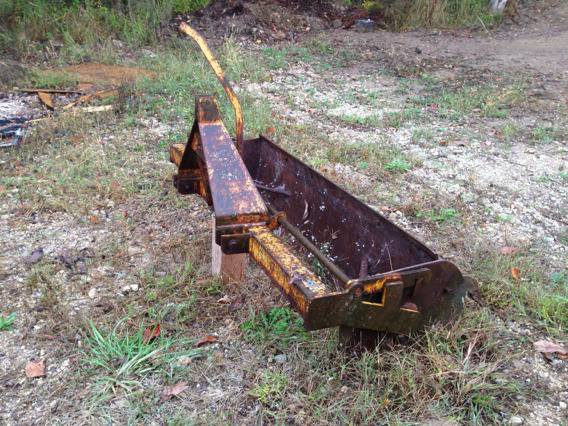

Well - this ended up working out well. At the last minute (was going to head over to the dealer and order a Gannon yesterday) - I checked craigslist one last time - and what showed up? An older 6' Gannon ROBB close to home (around 60 miles NE).
Gannon box blade 6'
Had to make two trips to get it (first time there was a mix up about them being able to load it on my truck - had to come back home and get the equipment trailer) - but for $300 cash I got her.
Even looked better in person - I'll give her a quick sandblasting and a coat of new FI paint (MF Red to match the tractor, truck and trailer) - and hopefully be happy. If not - figured I could see it for what I got it for and then buy new if needed.
Now just waiting for my new hydraulic top link to ship! (hint hint...)

That was good luck, saved a lot of cash. It will look good with some paint, always pays to check craigslist!!!

Looks good and saved a lot of cash. I would sand blast and powder coat it.
I would use it for a week or so, then decide if you add any bracing or reinforcements, have any cracks to cut and reweld, and only then blast and paint. Especially with powdercoat, its hard to touch up because ordinary paint wont stick to powdercoating.
Renze makes a great suggestion. Use it first and see if it needs anything before painting. BTW I love my Gannon box blade with hydraulic scarifers. It is heavy which helps in moving soil/gravel without chatter. Nice catch on Craigslist!.....Gary
