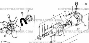

Hi I am new to the forum and not really know English, I come from Polish and need help in dismantling YM2000 Yanmar water pumps.
Some time ago bearings in the pump started beeping and I want to mention them, just do not know how?
Maybe someone undressed and will share how to dismantle?
Do I need to use the puller and the gunboats from the fan?
Thanks for any help:)
There is not much to it. You will need a gear puller and maybe a "C" clip tool. Remove everything from the front of the shaft and push the shaft out the back. Bushings are probably held in by "C" clips. You just need to be a little bit mechanically inclined.

What he is wondering is if the impeller is installed hot. That is that it is heated and then pressed into position. I will try to help him. Does the service manual cover rebuilding the water pump? Probably not just replacing it right? I will see if I can get a parts manual for him. I do not have time to get a service manual.
norm; I have not had one of these pumps apart, so do not even have a clue without a picture. What do you mean by "back" and "front"? Front as in the fan/radiator side? Back as in impeller/block side?

No need to heat anything, some have a circle clip, some don't. A new pump W/gasket is a little over $ 100, if this is your first time, you stand a real good chance of busting the housing. If he buys a bearing & shaft, impeller, seal, and gasket it may not be worth it.

I would assume the fan end to be the front.
   / Replacing the water pump bearings on Yanmar YM2000 #17
Like I thought Norm, just checking, because the pic on Hoye's site indicates that the bearing and shaft come out the front.
I am posting the pic so that everybody will be on the same page. I now know more than I did, from what norm said and looking at the pic. :thumbsup:
Mike

It's a similar job to this . The wheel puller will probably press the shaft out, rather than a shop press, and you can't separate the impeller from the shaft without first pushing the shaft out, so . . . no need.
