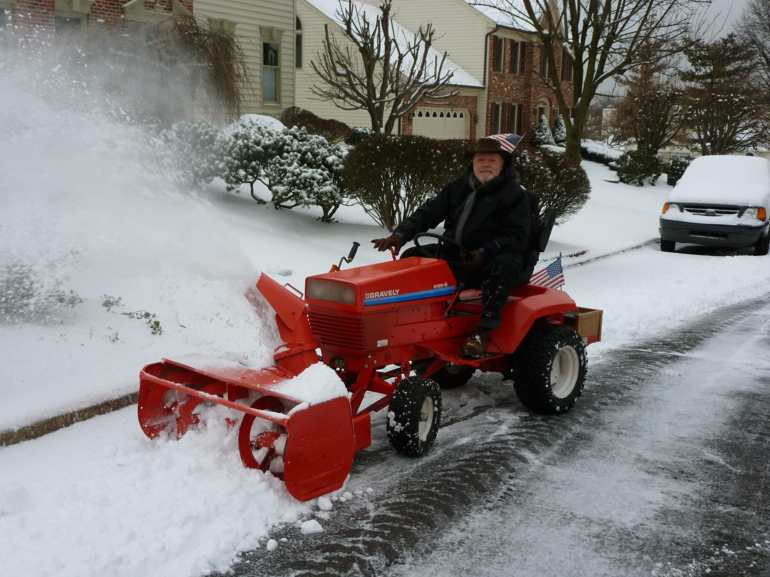

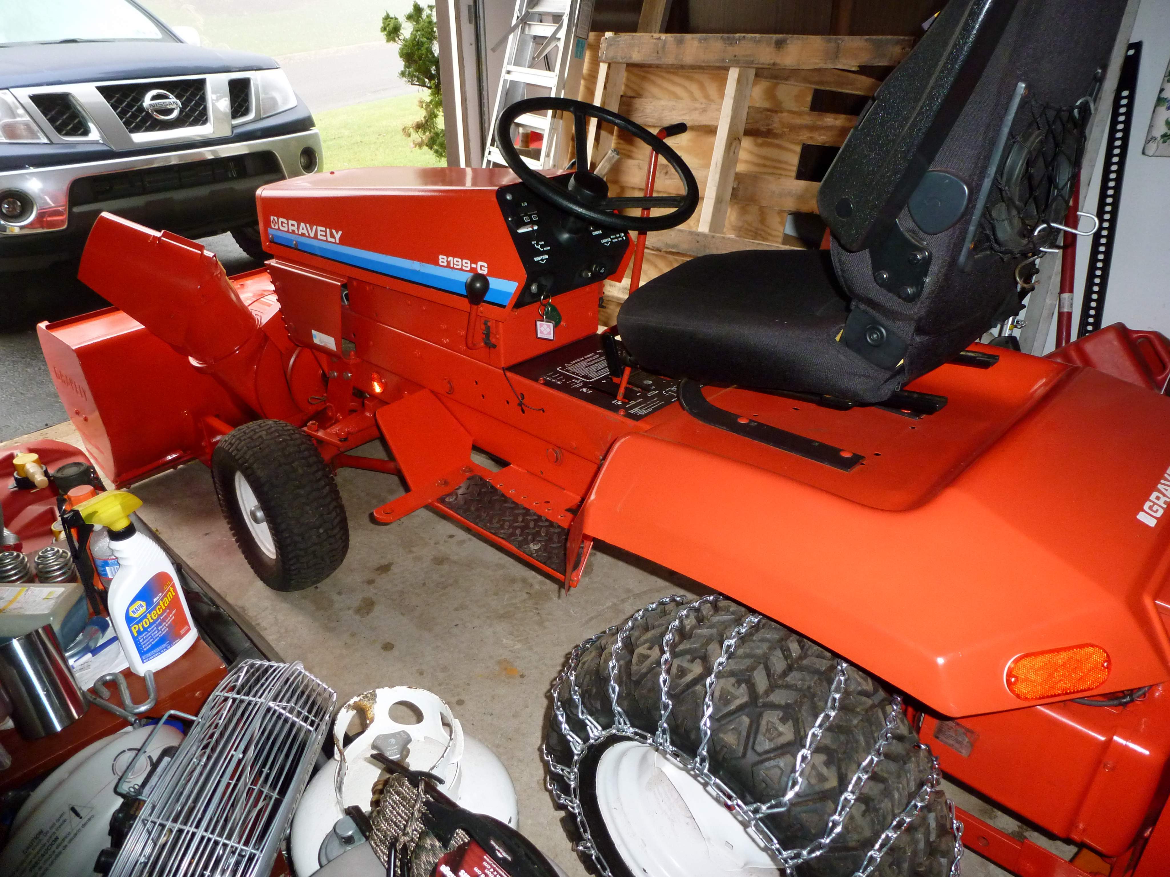

Richard, I've had to take a wooden dowel and gently tap with a rubber hammer on the points case, and that usually worked. Come to think of it, last time it was serviced they replaced the pushrod along with the points, and I've not had the problem since. Hmmmm.

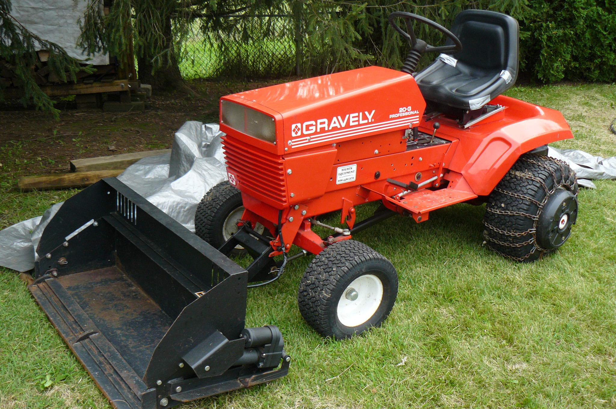

And....my bad, it was not a 24G I saw with a Subaru V twin, but rather a 20G. Found the picture, too bad I didn't get one from the rear. Sure liked his Johnny Bucket. I bought this guy's snowblower for my 8199G.
btw, I took one ride with the chains on, scratched the heck out of my driveway, took them off, built a weight box with 300 pounds in it, and it ran marvelously.

Chains will scratch a driveway but when the snow gets deep, nothing beats their traction.
