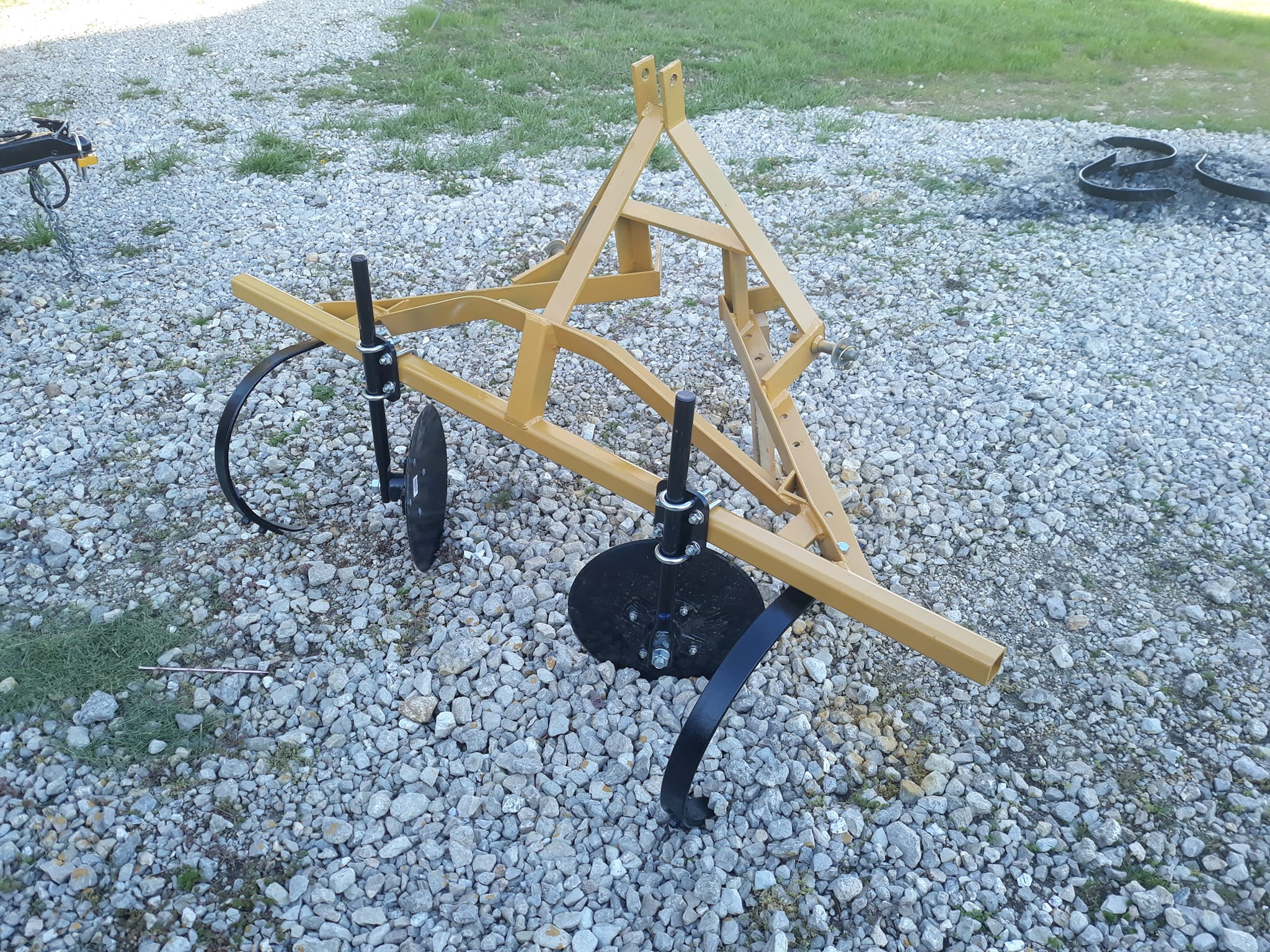

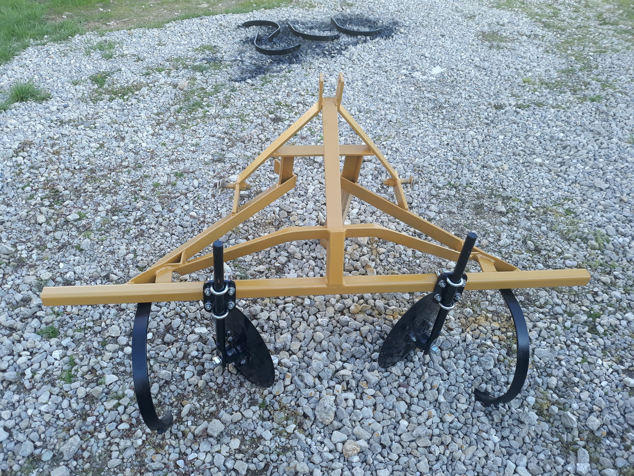

I welded (well, had a guy at church weld, anyway) a 6' 2x2 bar to the rear of my cultivator, removed four tines, then added a couple of s-tined sweeps and disc hiller blades to make a garden bedder. A couple of rattle-cans later, she's looking garden ready!

Them hillers make a nice bed for a garden, I swap them out for a 2 x 8 board and make a pass down my row and it gives me a nice flat spot to plant on top of my bed.
/ Repurposed Single-Row Cultivator #3
That looks good, like factory made, nice job.
