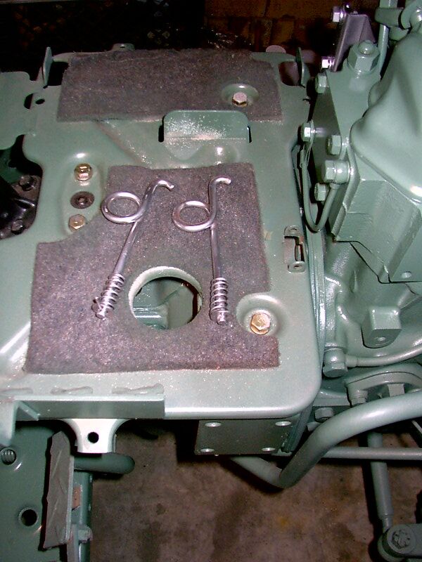

Here's a photo of the hood hold-downs. The YM1510 parts manual shows a drawing of these that looks exactly like the ones in this photo, but the part number is different for the 1510 vs 1110.

   / Request for 1510 pictures #12
The hood hold-downs on my 1100 are longer than the 1510 ones, so thus the different part #.

#13
gbirky,
Thanks so much for the photos of the draw bar and hold downs. This is excatly what I needed. It looks like I can make something up for the draw bar. Not too complicated. The hold downs are much simpler than I thought. It seemed to me that there were more bends than that. Simply a straight piece of wire with a loop and a short 90. I really appreciate you taking the time to shoot these.
Dave
   / Request for 1510 pictures #14
You are welcome. I have gained so much from this discussion group that I try to do all I can to sort of "pay back" into the system.

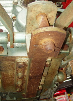

Here are photos of my 1500 draw bar...sorry about the rust. I am repainting this spring.

   / Request for 1510 pictures #16
another draw bar photo...yep still rusty

   / Request for 1510 pictures #18
Neat pictures.
Question: is it a "draw" bar or a "drag" bar?
cvt
   / Request for 1510 pictures #19
draw I believe....but if your not careful it will drag you around too (i.e. dont start the tractor unless your sitting on it! /forums/images/graemlins/grin.gif)
Peter
   / Request for 1510 pictures #20
Have you gotten a drawbar? or did you make one up? Looks like something worth having.
cvt
