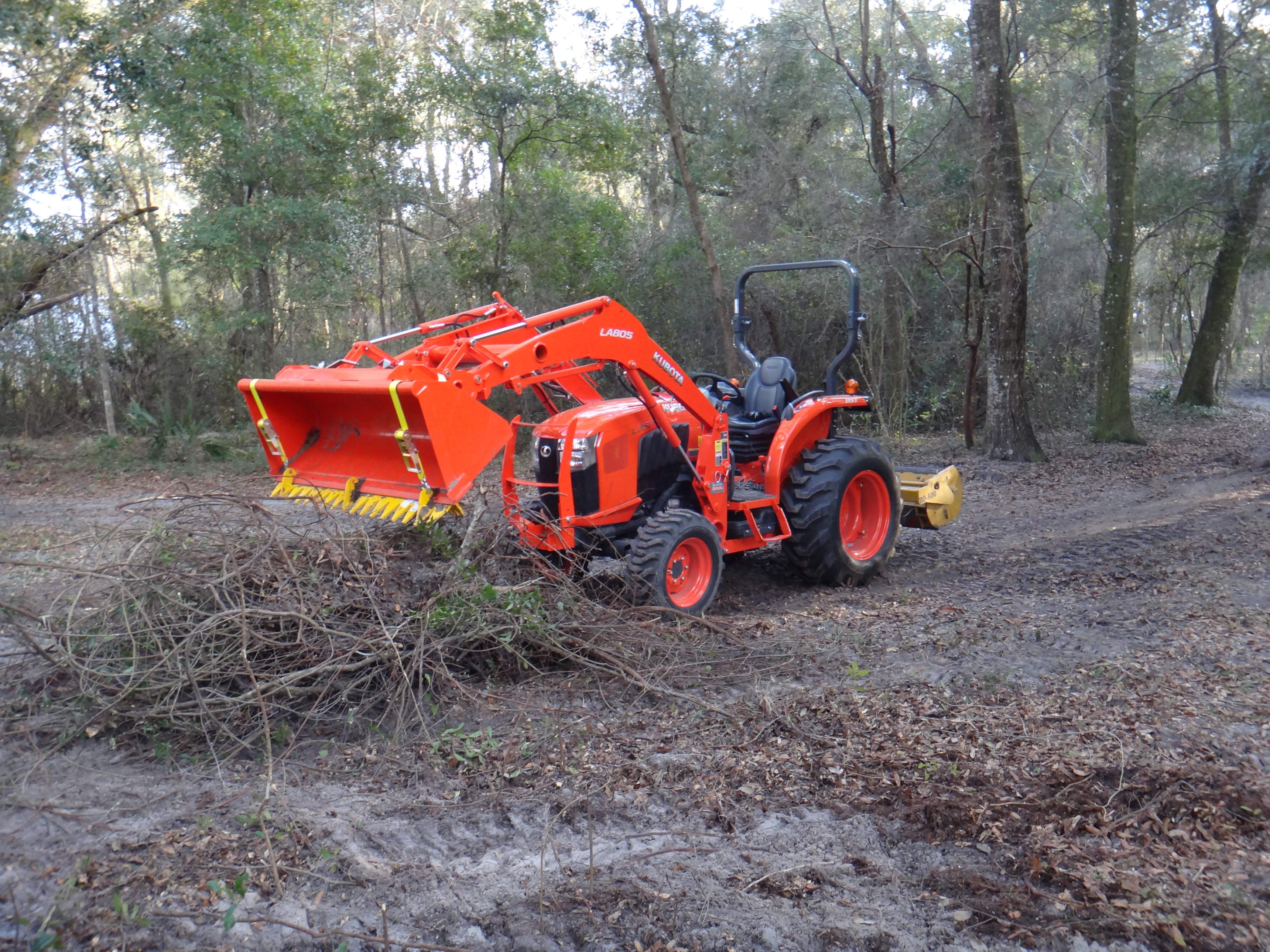

Front End Loader (FEL) plus optional heavy duty bucket for your rocky environment.
Telescoping Lower Links on the Three Point Hitch + rigid, pin-adjustable Lower Link stabilizers.
Triangulated Cross Drawbar for the Three Point Hitch for towing tree trunks and trailers.
Suggestion: Tractor Quick Hitch-Cat 1 Quick Hitch | Agri Supply #61559
Ratchet Rake attachment for your bucket= brush removal, piling brush and moderate grading.

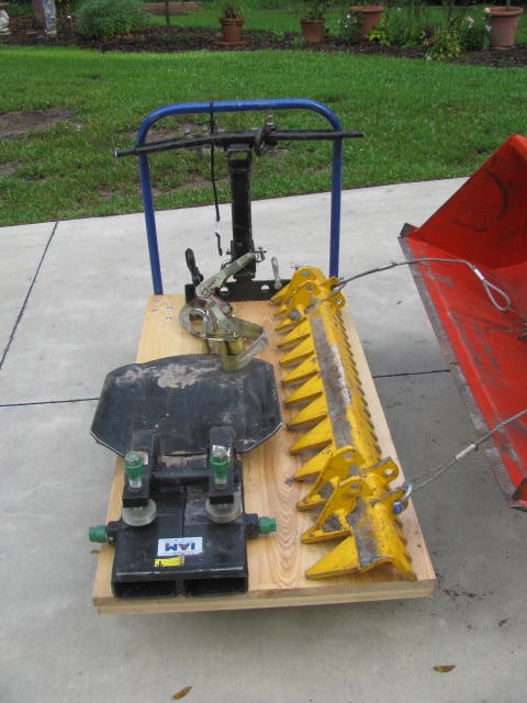

Skid Steer Quick Attach (SSQA) option for your FEL. Makes taking off bucket easy. Required for a grapple.
Grapple for tree lifting. Requires optional rear hydraulic ports. (Hydraulics for the Three Point Hitch are standard.)
VIDEO: https://www.youtube.com/results?search_query=compact+tractor+grapple

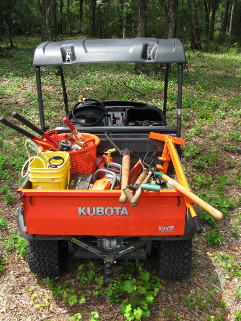

One professional quality chain saw. I like my relatively light Stihl MS261. A battery powered reciprocating saw with "pruning" or "axe" blades.
Rotary Cutter - width and weight to be determined by potential use.

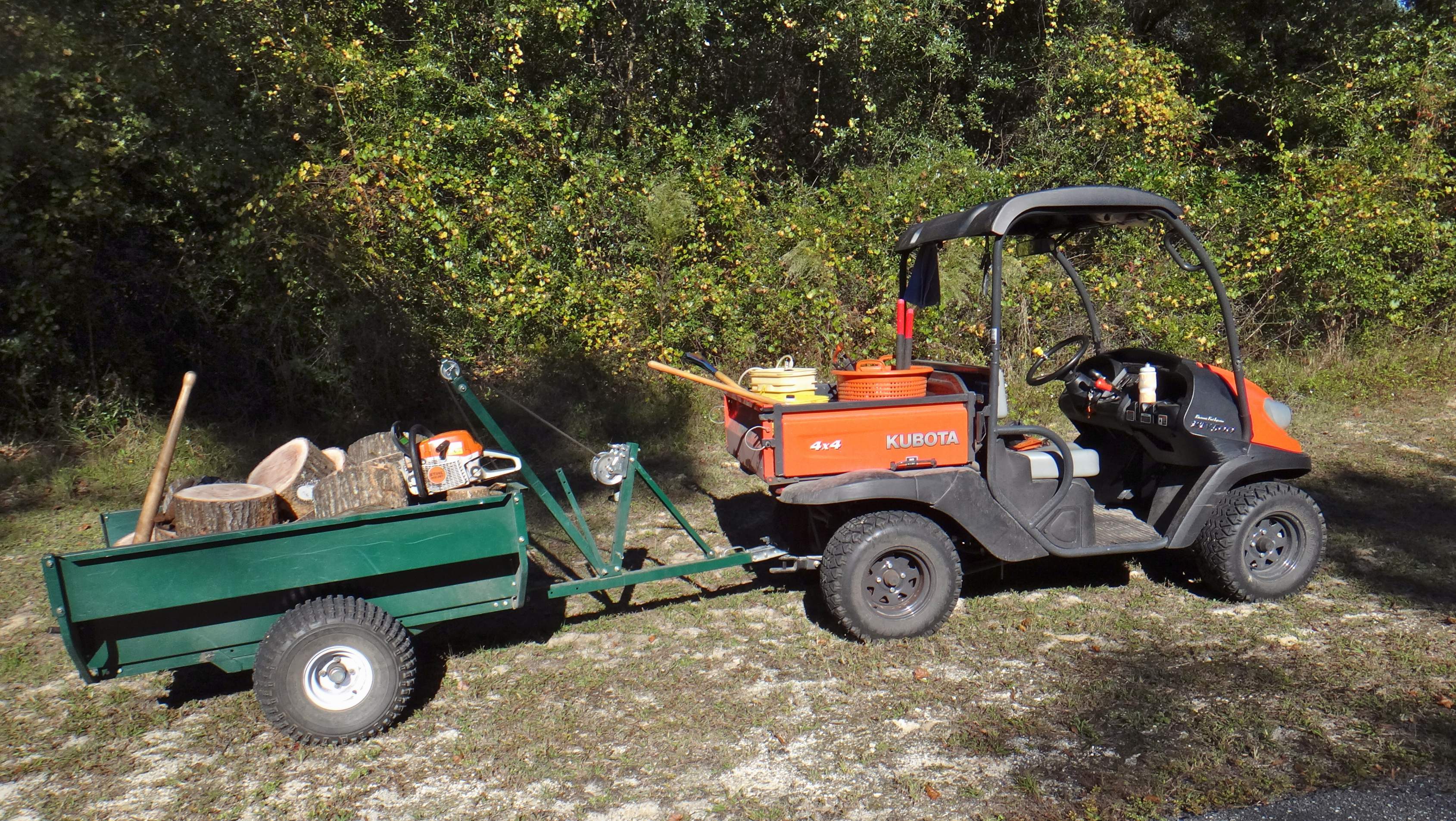

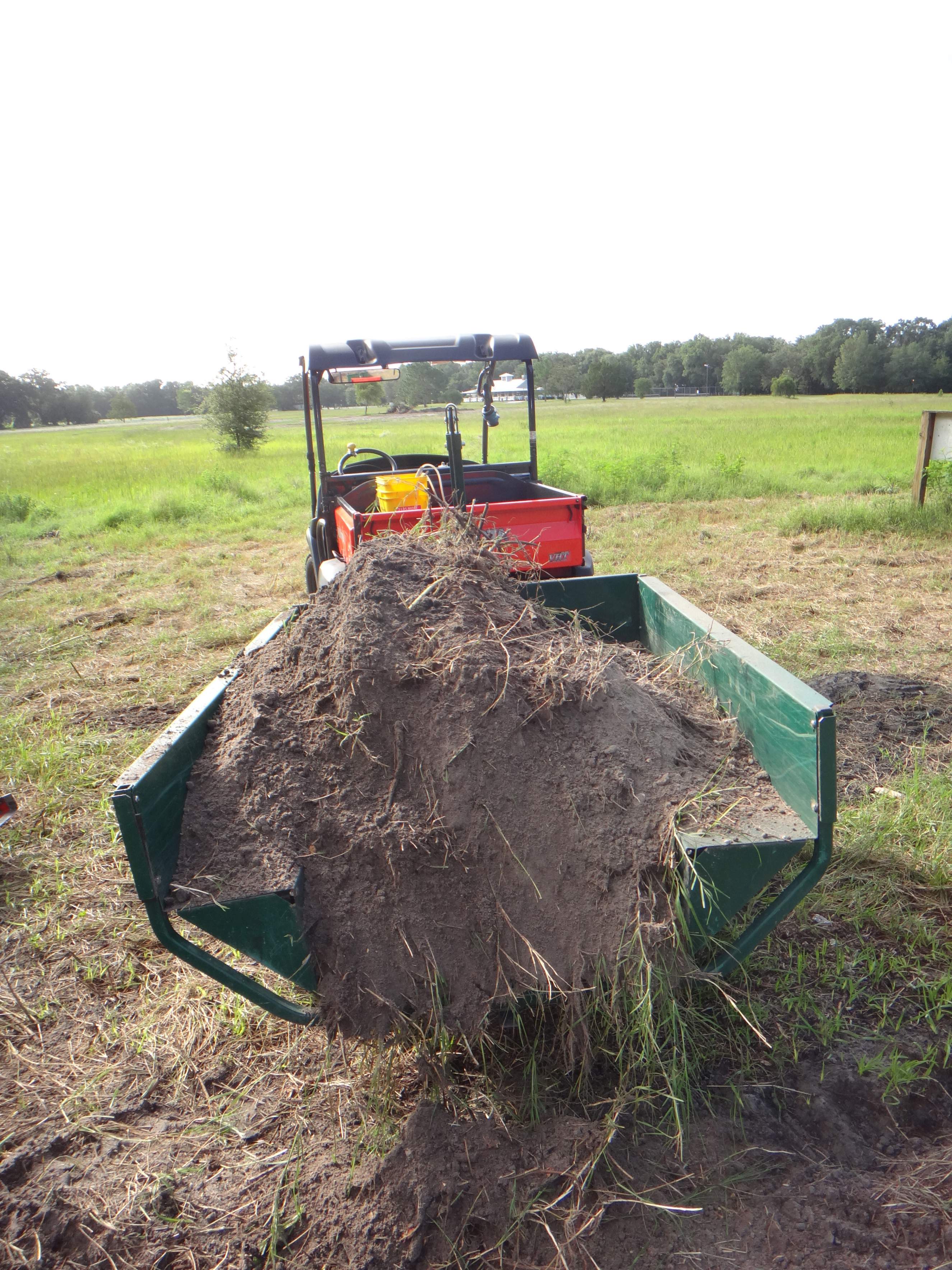

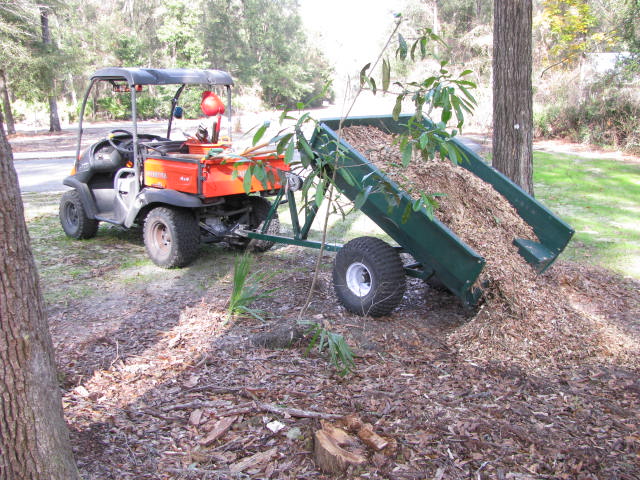

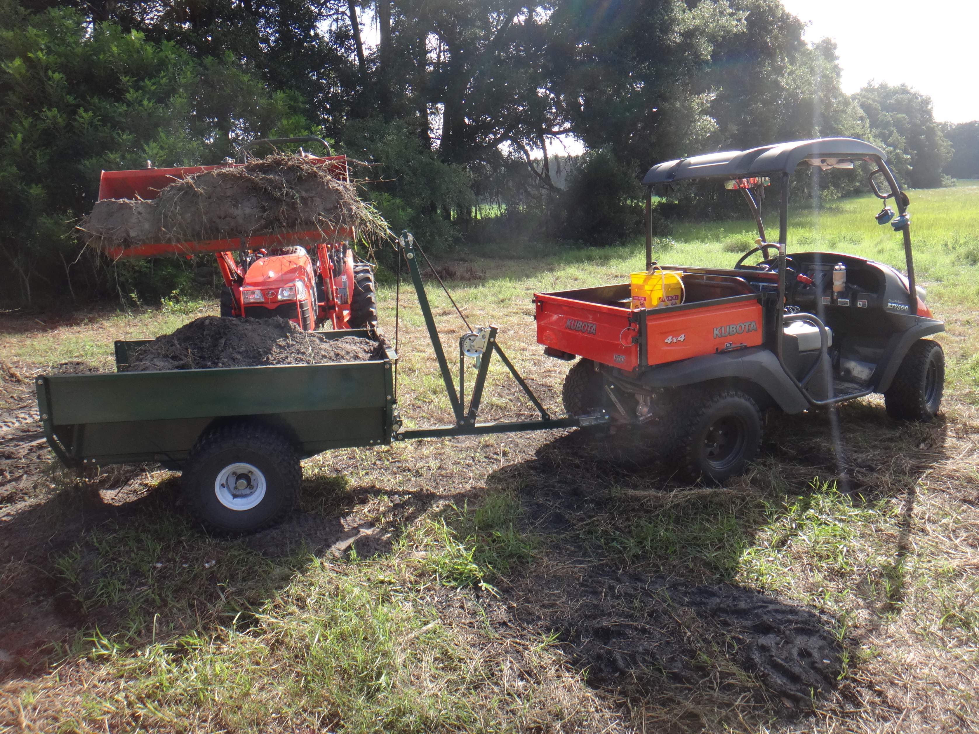

A roofed Utility Vehicle with a rear hitch combined with a DUMPING trailer.
Steel toed boots, safety glasses.
