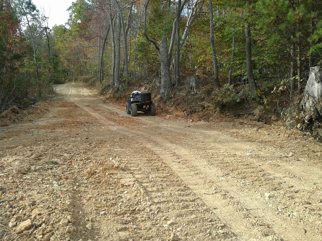

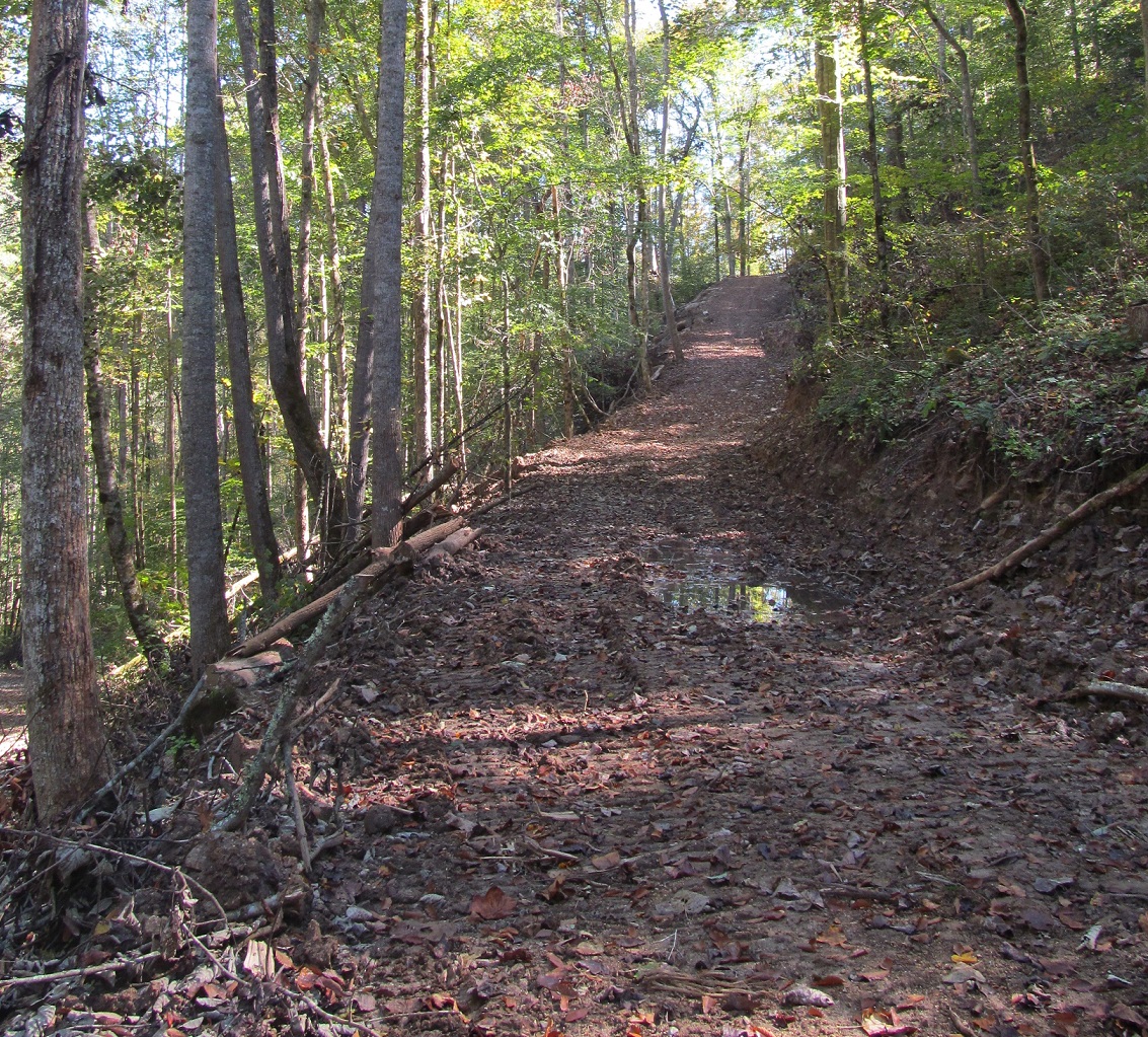

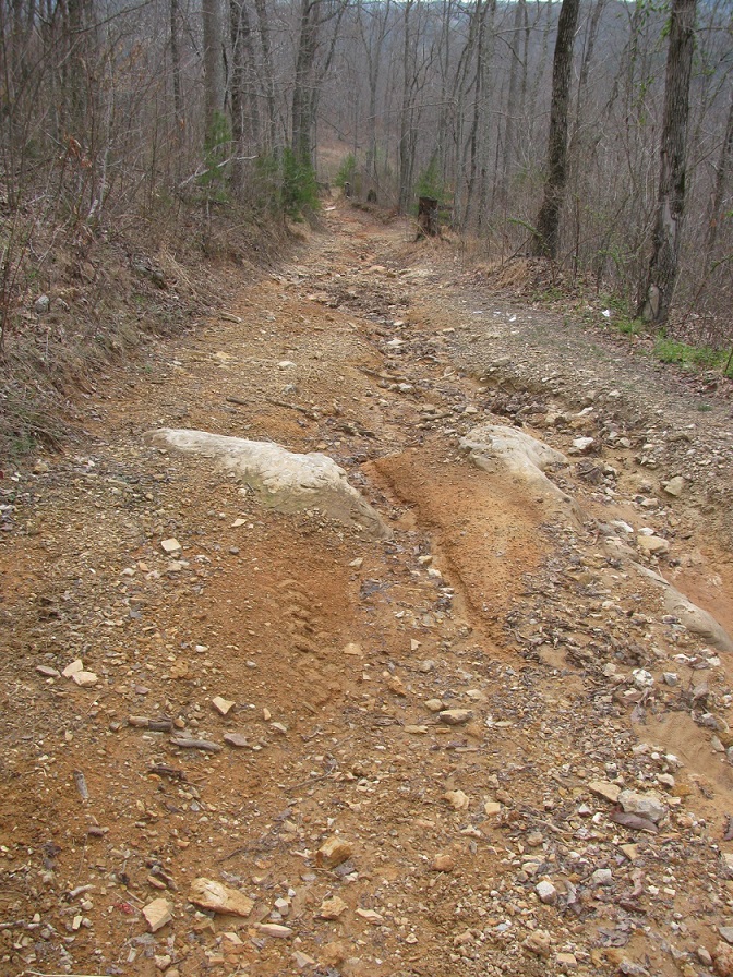

Roads - Typical before reclaim for logging in 2012, then after repair after logging in 2014, then now. In the years between logging and now the roads had deteriorated almost to the before-logging state, but were also overgrown with foliage (as in trees, tree limbs, bushes, etc). Are now generally much smoother, much wider, and with much better water control. I wish I had money today for gravel. The road on the north side as it loops up onto the hilltop never gets sun, so is slow to dry out. That will be the first to get stone and gravel, but I cannot do it now.
Road just before logged 2013 - 1.jpg Road just logged 2014 - 1.jpg Road just repaired 2016 - 1.jpg

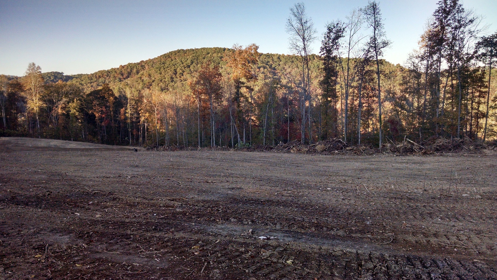

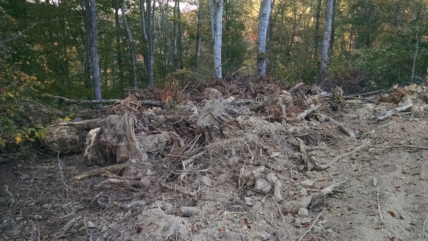

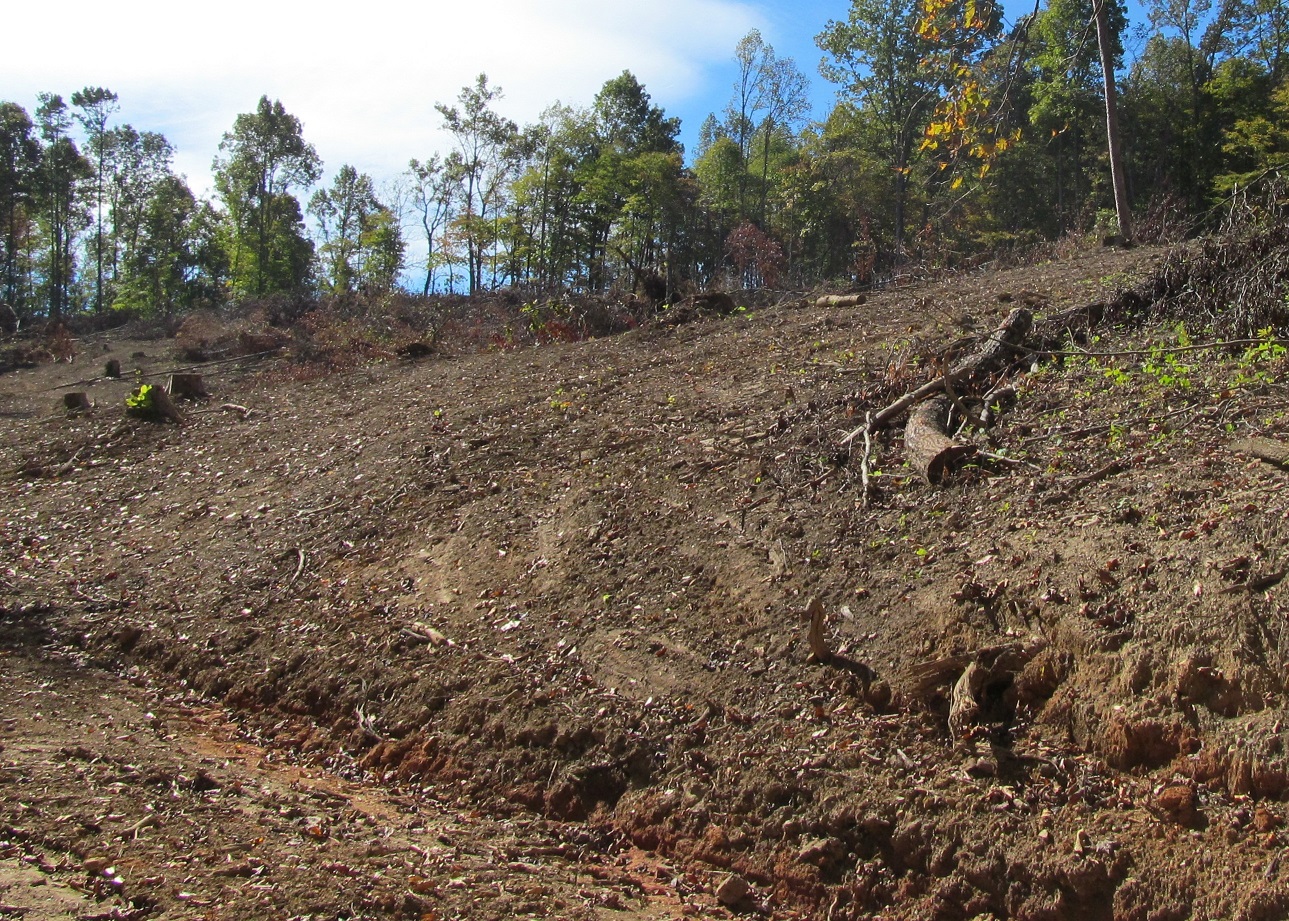

Clearing at the top. 7-8 acres. Before with stumps and slash, then after with only small saplings, then some of the removed debris. Entire east side of clearing is a 6-foot high wall of stumps, logs and soil removed from hilltop last week.
Just logged in 2014.jpg hilltop with saplings and debris - 2016.jpg hilltop with debris pile - 2016.jpg
