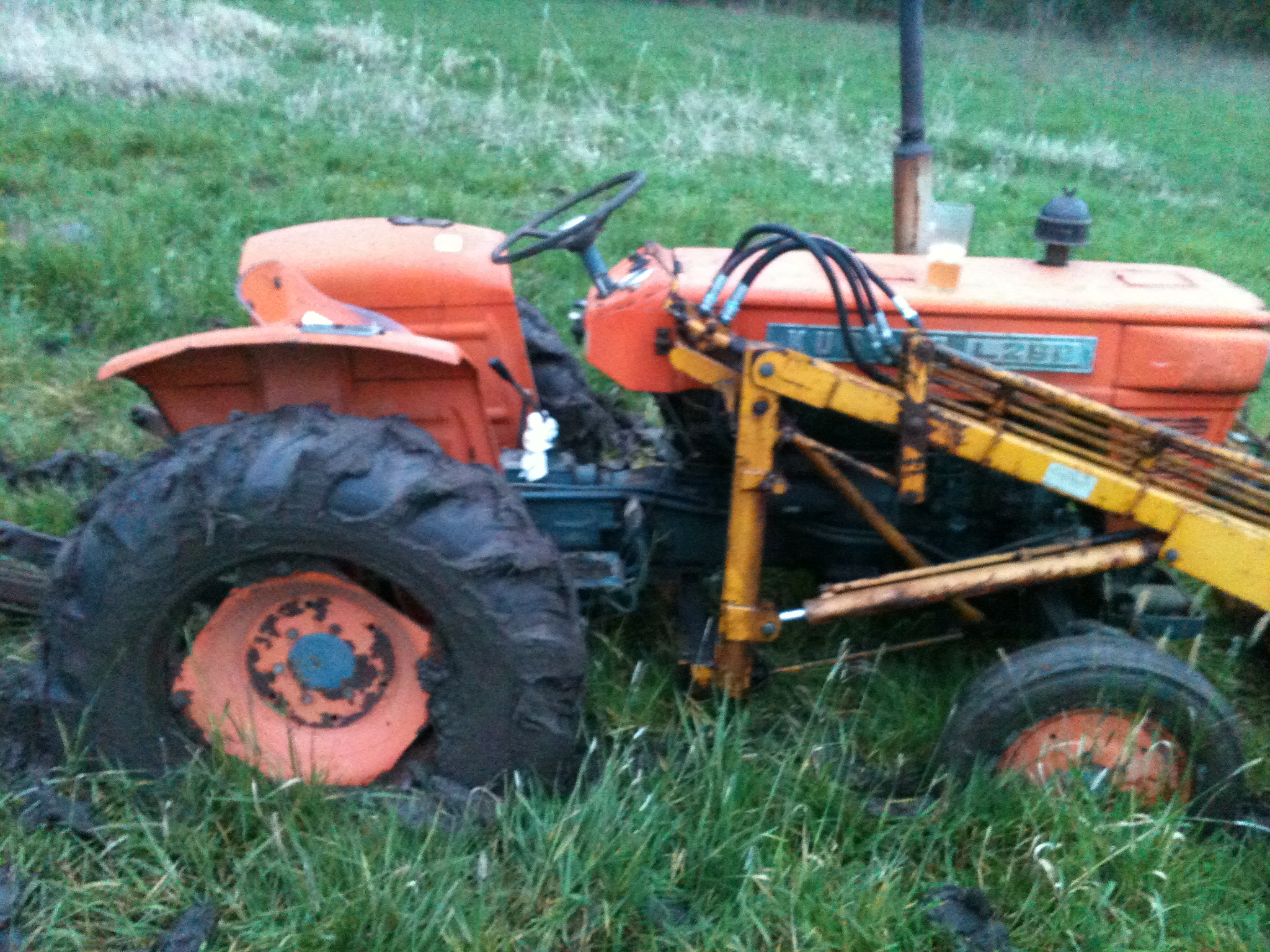

I'm toying with choices... I use the loader all the time but it's a self leveling linkage setup with a very warped bucket so smoothing doesn't work no matter what you do, plus I have a box scraper... the linkage setup severely limits bucket rotation and curl force due to curl geometry (although a couple of the curl hoses are tiny, bought 4 matching hoses today to install when I put a new valve on). Here's somewhat of a picture of the loader... I didn't get anything new today, will try tomorrow...
I've never used a joystick loader but am VERY used to the function of the two levers. The current valve is a stacked setup but you get one function at a time so you can't tilt and lift at the same time (it stalls the pump if you move both for whatever reason), and with the level linkage setup I'm not so sure anything fancy will help but am open to opinions...
I don't have a remote but only have 5 acres and no farming so limited need of auxiliary hydraulics, a hydraulic top link would be nice sometimes but so would a working adjustable linkage on the right 3 point arm :). I also don't think I have room width wise for a third function, was looking at that today, it's tight between the hood and rear upright where the valve lives...
Not trying to be cheap, just weighing options, it is a 45 year old tractor worth around $3k tops...

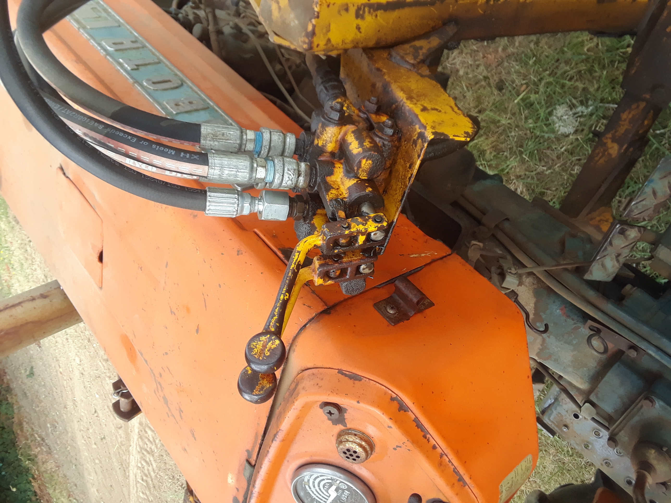

Here's a picture of the original valve.

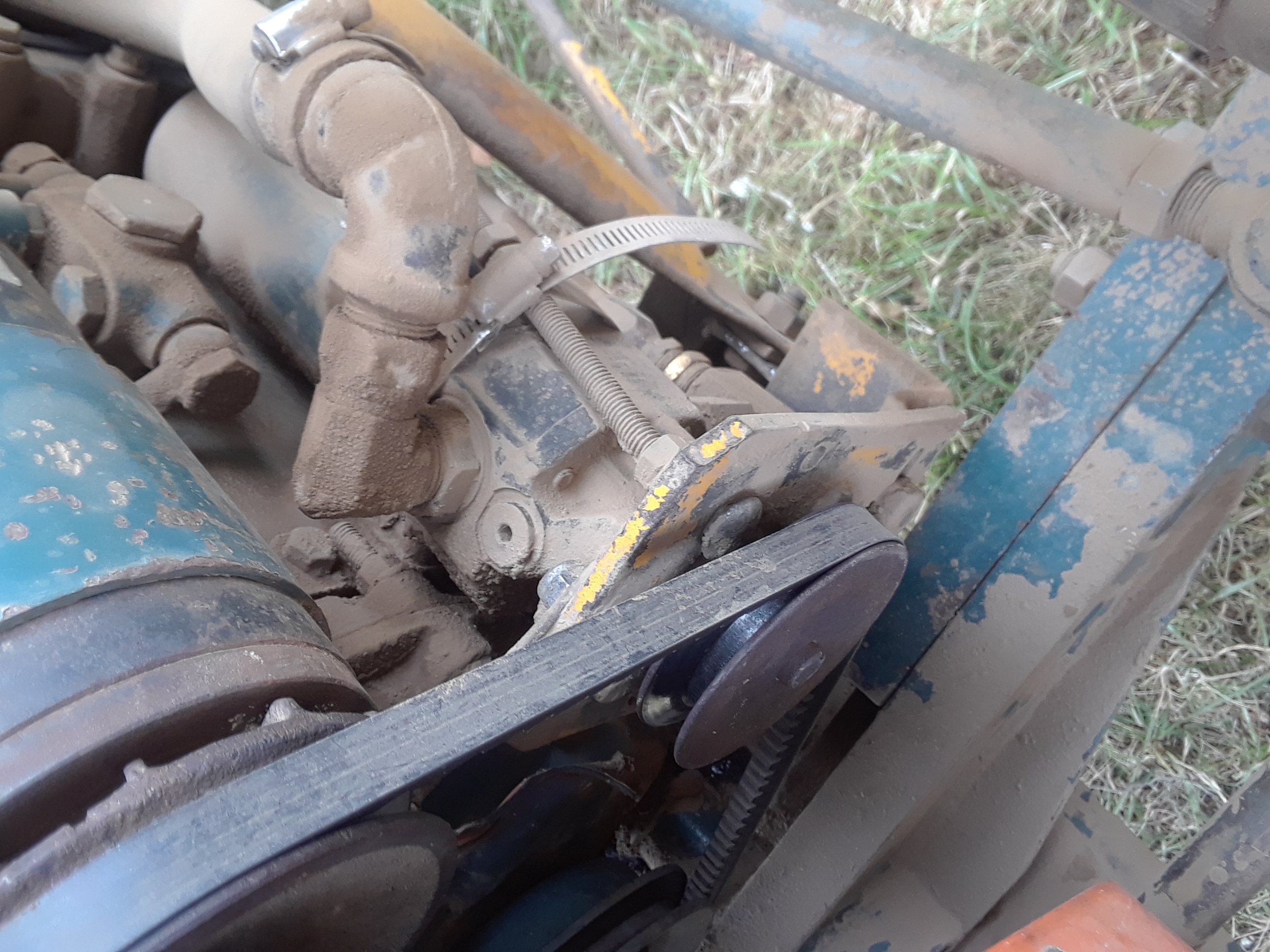

It's an external belt driven pump, Northern 10567 like THIS that has a 2 or 3 to one overdrive off the crank (I haven't measured, probably closer to 3:1) and with my normal operating speed of 1800rpm that puts me right in that range. I attached a picture of the pump setup, pretty obvious it's aftermarket looking at that :)
That said, any argument for single lever "joystick" control? All I hear is it's the way to go but haven't heard of reasons, can you run both at once, give finer control? An engineering mindset wants to know before I choose :). It looks like the same valve with some fancy linkages to me. With the self leveling bucket I just don't even think about trying to tilt and elevate at the same time...
   / Resealing valve for front end loader controls #17
You're right, usually a joystick is accomplished by linkages to two adjacent valves - and yes, you can actuate both valves at the same time - BUT in most cases you don't push EITHER valve to its end of travel.
If you just push forward, it's the same as just moving the lift lever forward; straight back, still just the lift lever/valve - then, moving the joystick sideways TOWARD you will curl the bucket; sideways AWAY from you will dump the bucket.
Moving the joystick forward and outward @ 45* would dump the bucket while lowering the loader arms - probably the most useful combo is picking up a load of dirt or gravel from a pile; push forward PAST the spring return into FLOAT, bucket drops - while it's dropping, adjust curl (sideways movements) so it ends up level as it reaches the ground - drive forward into the pile, once the bucket starts to fill you pull the joystick to the rear slightly (raising the loader) and to the inside (which curls the bucket) that combo gets the bucket as full as it can get.
that's just one example; it can be done with separate levers, but it's more of an exercise in finger dexterity than a single lever control... Steve
If you get one of these
2 Spool Prince SV Sectional Control Valve Open Center | Stack Valves | Hydraulic Valves | Hydraulics | www.surpluscenter.com
you could order the joystick kit separately, either at the same time or later (or not at all, your choice) - there may be other brands that also allow that. As you pointed out, the valves are the same - it's the linkage in the kit that changes side motion on the lever to forward motion for the SECOND valve (curl)
HTH... Steve
