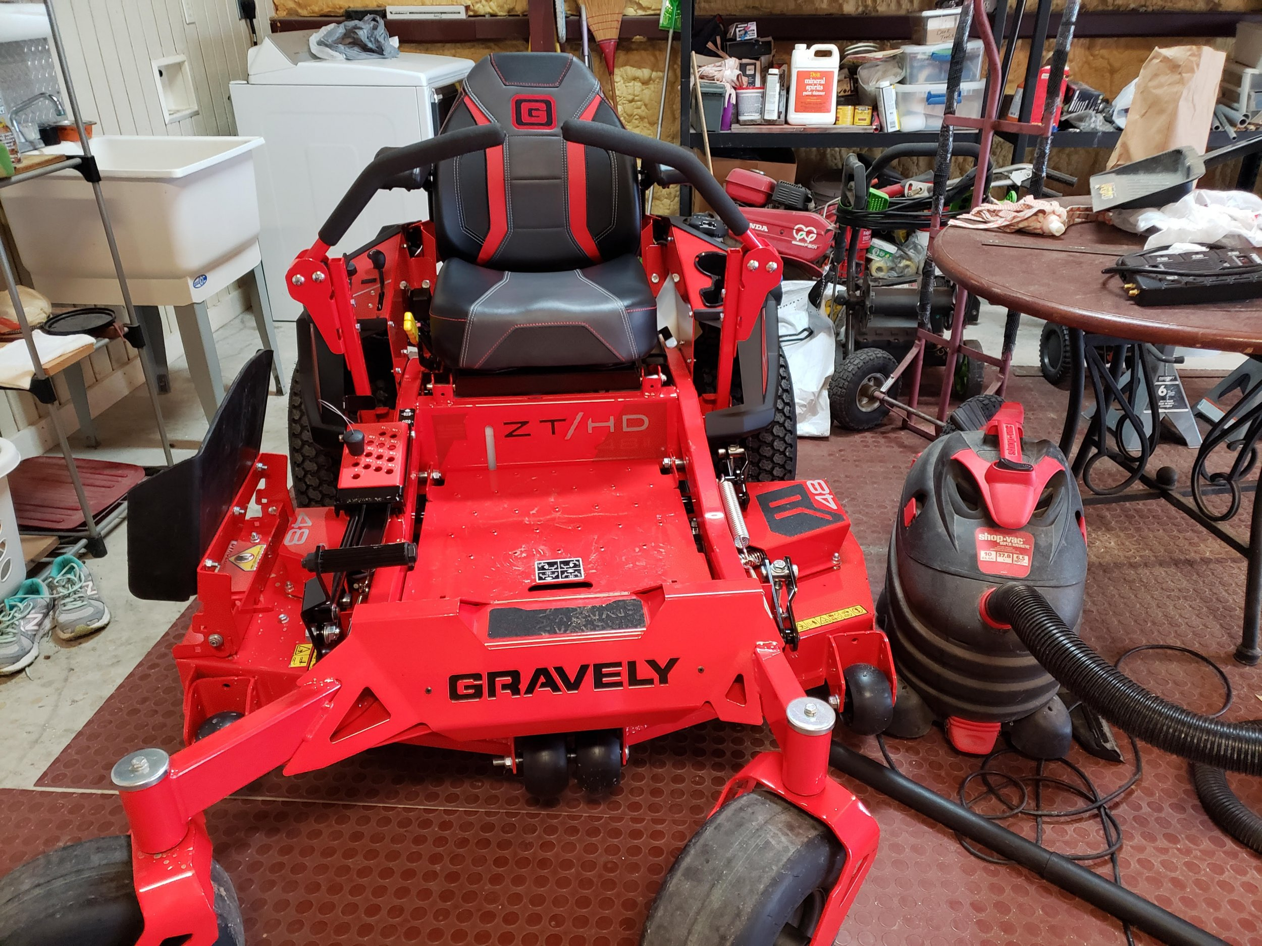

Well hey fellas hope all are well...been a while right? So, finally got settled into the house and many sundry honey-do's....and Shazam it's time to mow a .....front AND back yard...that used to be pasture....gulp! That 18 year old 21" Husqvarna ain't gonna get it.
The Ariens Apex was my first choice and save 10% at a the Blue Box store with Vet. discount....but the New Holland dealer in Shiner has treated me very well over the last four years and well chose to support him instead. I'll buy the belts & other expendables from him and if warranty is needed it will be addressed.
And after all the hours of research, the 22" wheels, 5gal. tank, ZT-3100 Hydros and 5" deep fab deck became a Red Gravely ZT-HD 48" unit.
Six hours later deck set to 3" it cuts through 6-7 inch coastal like butter and woody weeds as well.

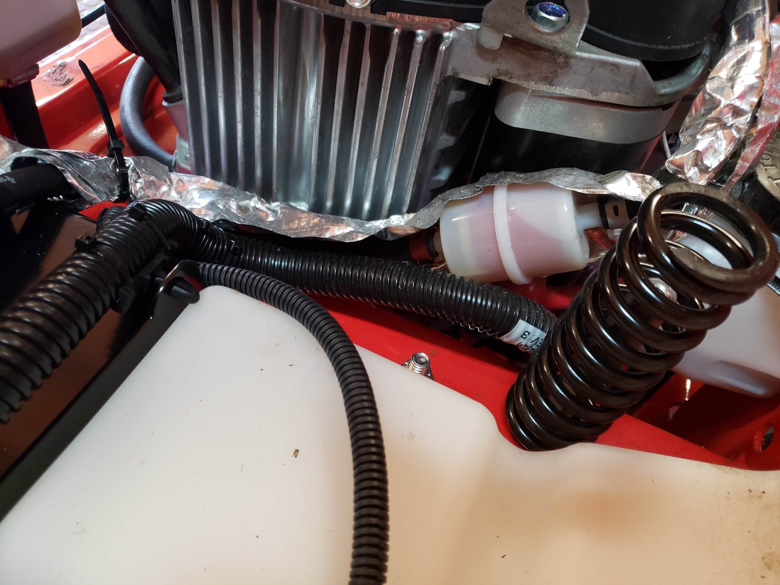

So far here is what to be considered small annoyances. The discharge chute has a hi-freq. buzz. Looks like the bushings used to eliminate the complaints of a loud rattle.
The second quick item is how close the fuel filter is to the rear of engine case. So I used a left over scrap piece of Attic Foil radiant barrier material and wrapped fuel line and filter.
So all the reviews appear to be on point about a large deck and rough pasture. The 48 cut right over the large dished out areas w/o scalping the land or straining the blade drive system At times could feel the deck raise foot pedal slightly move as the anti-scalping wheels did their thing.
The Kawi-Eng appears to be frugal with fuel. The Air filter no longer ships with the foam pre-filter, but the replacement filters do! Hmmm go figure.
The slopes in the back were no issues for machine other then my foam spitting pucker factor, sheesh I HATE that lean!!!
So, some part of slop I did a down hill cut and backed it up for next pass. No issues with climbing back up. At 870 lbs it's solid machine that once in motion it wants to run. Had to pull back on the sticks to slow it down.
This is my first ZT ever, never even owned a lawn tractor.
The lawn tractor was going to be used to pull a sprayer, but hey now that I have forks!!! Yeah
So the ZT was the final answer...Aaaand we all know...no pics nevah happened so here are a few for eye candy. No longer shiny...
Thanks for all the input and well just wanted to bring closure to this. Did not want to dead letter file....Take care Y'all....hope to drop in soon but the rains got me cleaning and limbing trees from last month. Also heavy rain run off reveals much drainage work.
