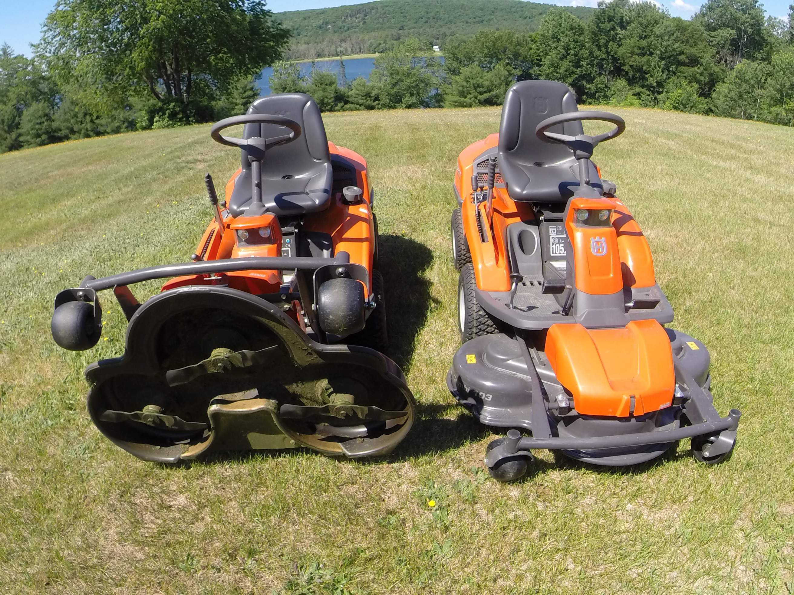

Like "Coyote machine", I also have the Husqvarna R322T AWD,
I needed more traction for the slopes on my property, and the AWD insures there is no traction loss.
Because of the articulating steering, maneuverability around object is much better with the R322T than my old Wheel Horse riding mowers use to be.
The feature I like the best, is the ease of putting the front mount deck in the service position (less than 30 seconds).
So after every mowing session, grass clipping from underneath the mower deck can be easily cleaned out, greatly extending deck life.
