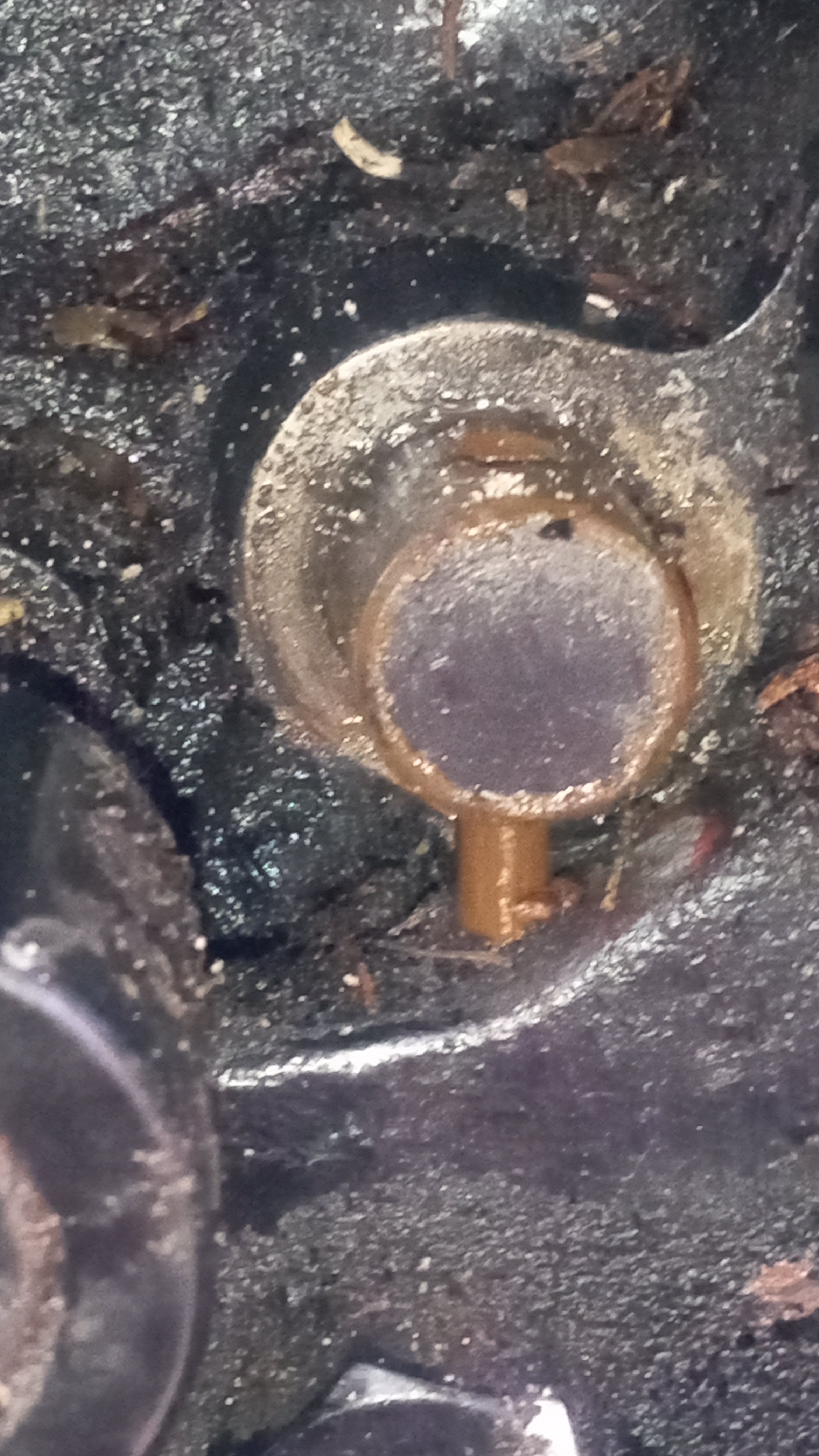

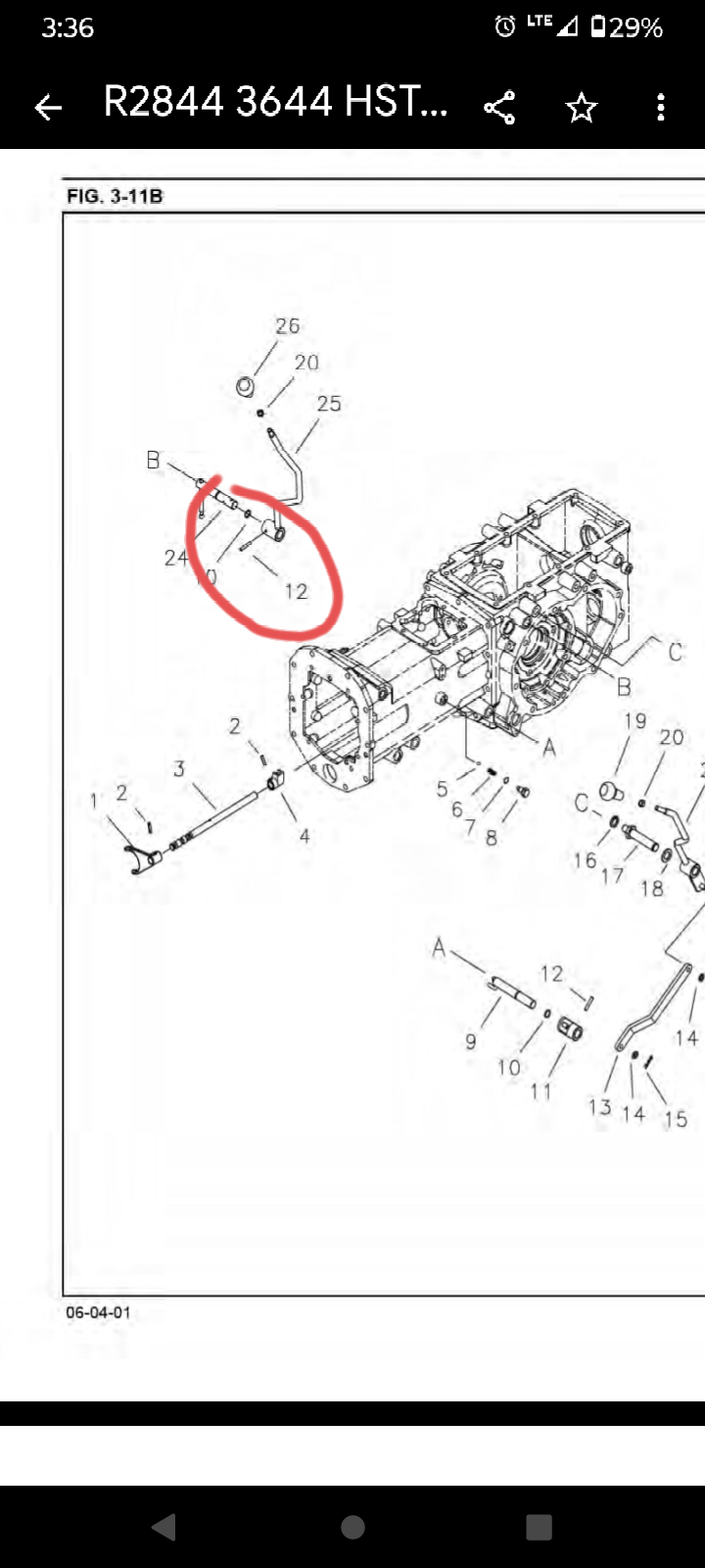

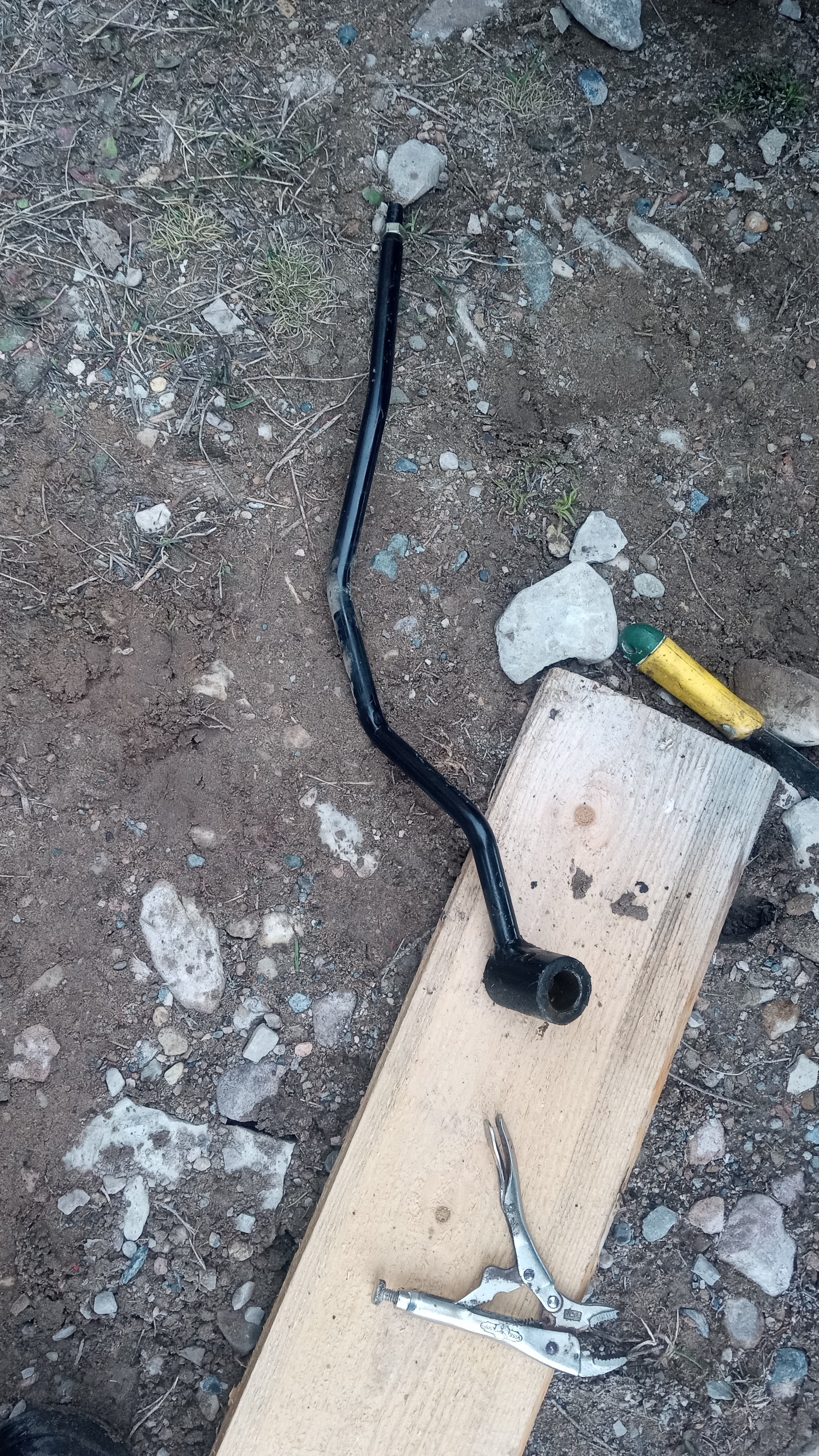

   / RESOLVED - Thanks - Montana 2844 HST Stuck in "M"
Thanks. It was a really tight spot and tough to see. The lever attaches on a shaft with a pin (sleeve). Turn out it had sheared or worn out. I had to take the back wheel off to get at it. There were a few problems getting the remains of the old pin out and putting the new one in, very little space to hammer or get vice grips in..... anyway.....it's fixed now
