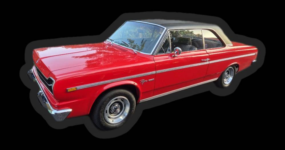

Last summer I bought this '69 Rambler Rogue.
What sold me was it's originality except for aftermarket stereo which I replaced with a factory radio. Except for ignition, headlights and starter, nothing electrical worked. After 100(?) hours now everything works.
Any gremlin like brake light on dimly I focused on. The light(s) of course is getting voltage somewhere. It's a time consuming pain, but so nice when everything works properly.

Nice looking Rambler, don't see many of those around any more. I always thought they were a nicely styled car.
