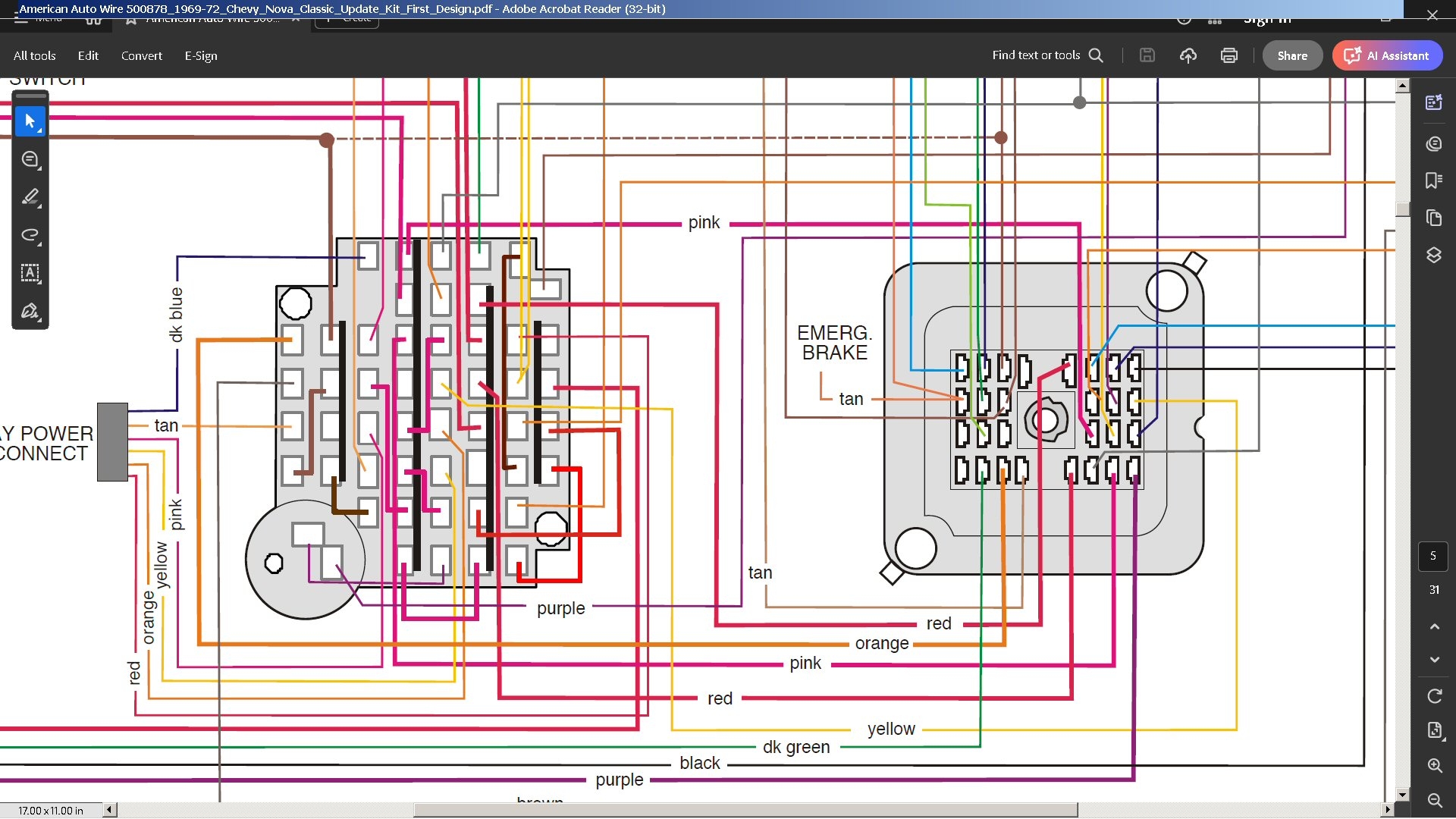

Okay, problem finally figured out and fixed. Fortunately, I guess, it wasn't my wiring error or something I did wrong.
After scanning the circuit diagram for the fuse block and bulkhead connector, I found a dashed line, the only one in all the wiring schematics, that was causing the problem backfeed.
Bear with me, I'll explain it. The accessory wire from the ignition switch goes to the fuse block to power a row of fuses that power accessory circuits. In the instrument cluster, one terminal of the the Generator light is connected to the normal ignition feed which powers the fuel gauge and other indicator lights, Water, Oil and Brake. The other terminal goes into the harness and into the bulkhead connector and then out in the underhood harness to the engine compartment, ending up next to the battery, but is not connected. However, for some reason the tech at American Auto Wire couldn't explain, there is a resistor wire connecting the accessory fuse bus to the generator wire. He couldn't explain why that was done, just that's the way they make them. The stock wire harness has no such connection, so I am at a loss for a reason they would do this, as it provides a direct path, albeit through a piece if resistor wire, between the accessory circuit and the normal ignition circuit. So, whenever the switch is in the accessory position current can feed from through that wire and the filament of the Generator light into the ignition circuit. Because of the resistor wire and the resistance of the Generator bulb, only a small amount of current can pass, just enough, around 2.5 to 3 volts, to make the MSD EFI display try to power up, fail and repeat the sequence every second or two making the screen flash on and off.
Once it figured this out, while the instrument cluster was out, with the ignition switch in the accessory position, on the cluster connector, I could connect the cluster power wire to the Generator light wire with a test light, and duplicate the problem.

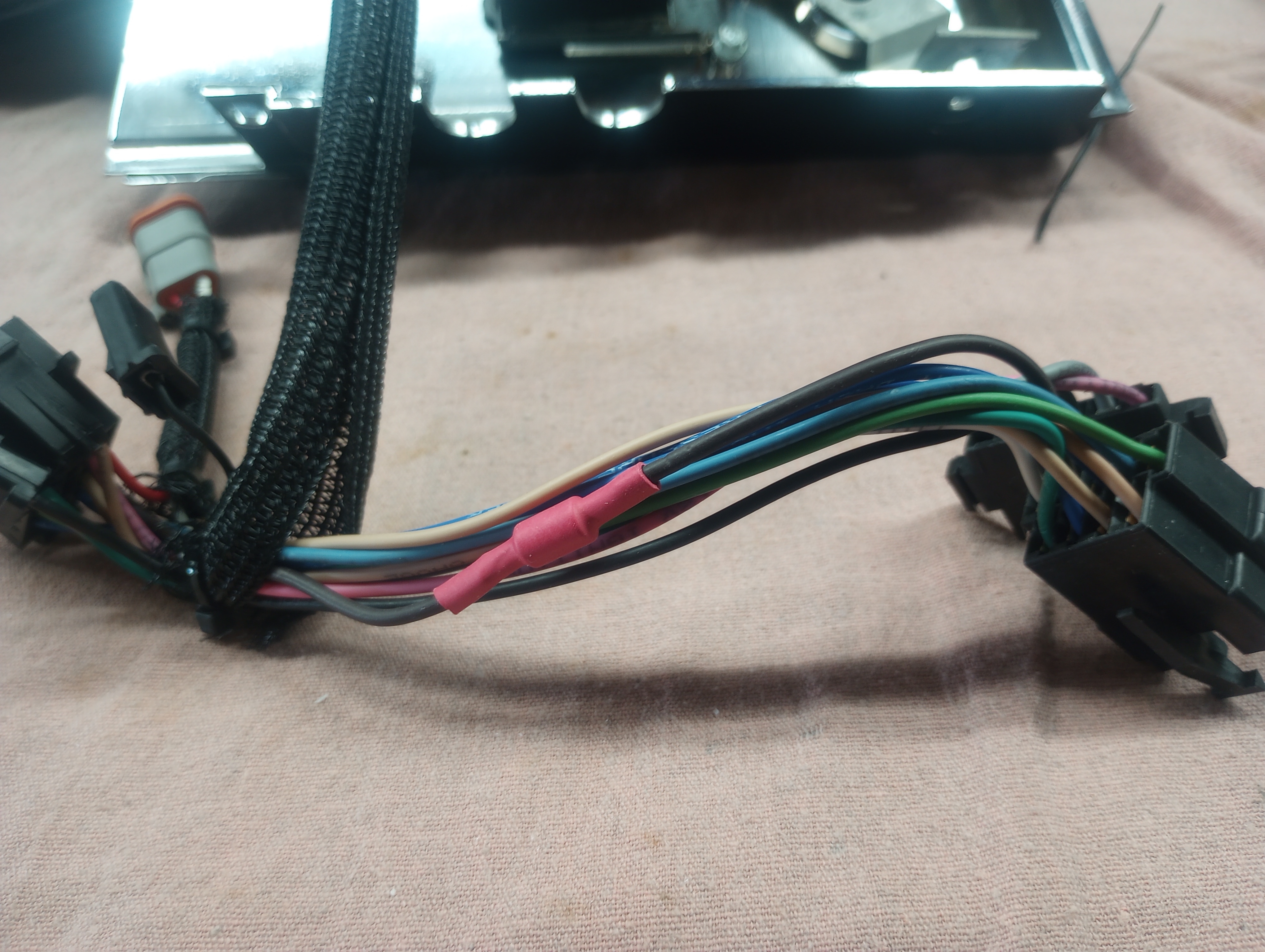

To fix it properly, would mean pulling the fuse block out, finding the resistor wire and cutting it out, but, that would be a nightmare working under the dash and having to pull the brake mater cylinder and booster to get access to the nuts holding the fuse block and bulkhead to the firewall. So, instead, I figured out that putting a diode in the circuit between the Generator light and the bulkhead connector would prevent any current bleeding over from the accessory circuit. There is a short harness from the main dash harness to the instrument cluster, so I installed the diode in that harness. I used a 10amp Schottky diode, as they have a lower forward bias voltage, ~.2 volts, versus ~.6 volts on a normal diode. While at this point, the wire isn't being used, if I do ever decide to use it, it will have sufficient current carrying capability and very little voltage drop.
I got the dash completely reassembled this afternoon, and everything works as it should, finally.

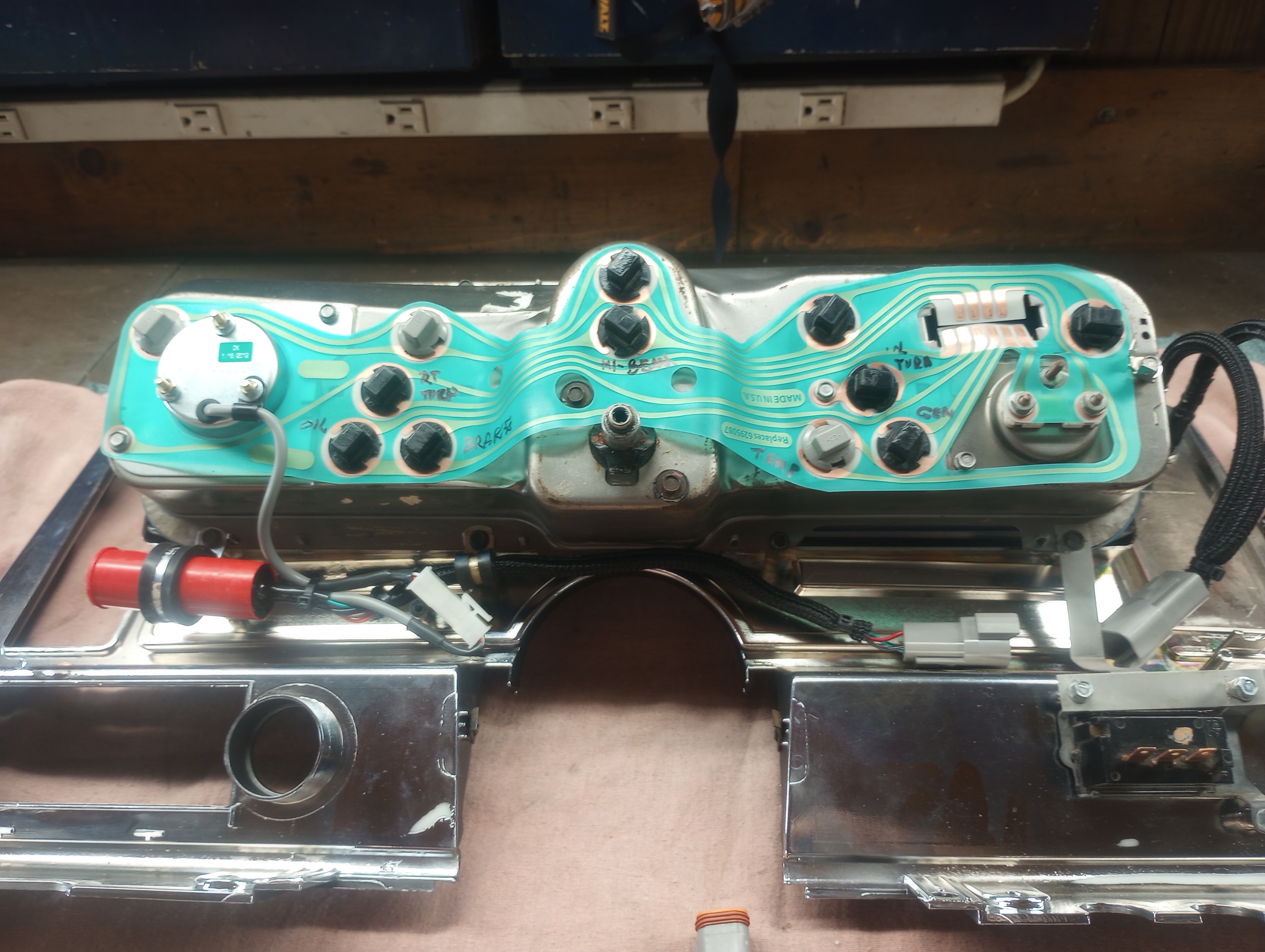

Before I had pulled it apart this time, the fuel gauge had stopped working, which I traced to a break in the printed circuit overlay on the back of the cluster, so I replaced that. I bench tested the gauge and all the indicator and backlighting lights, and everything worked. I also checked the circuit going to the level sensor in the gas tank, and since the tank is full, it read about 90 ohms, which is correct. The gauge shows right on the full mark now.
So, after a year of trying to figure out the problem, I finally have it solved and understand what caused it.

The dashed line above the fure block and the bulkhead connector is the culprit.
Diode installed in the harness.

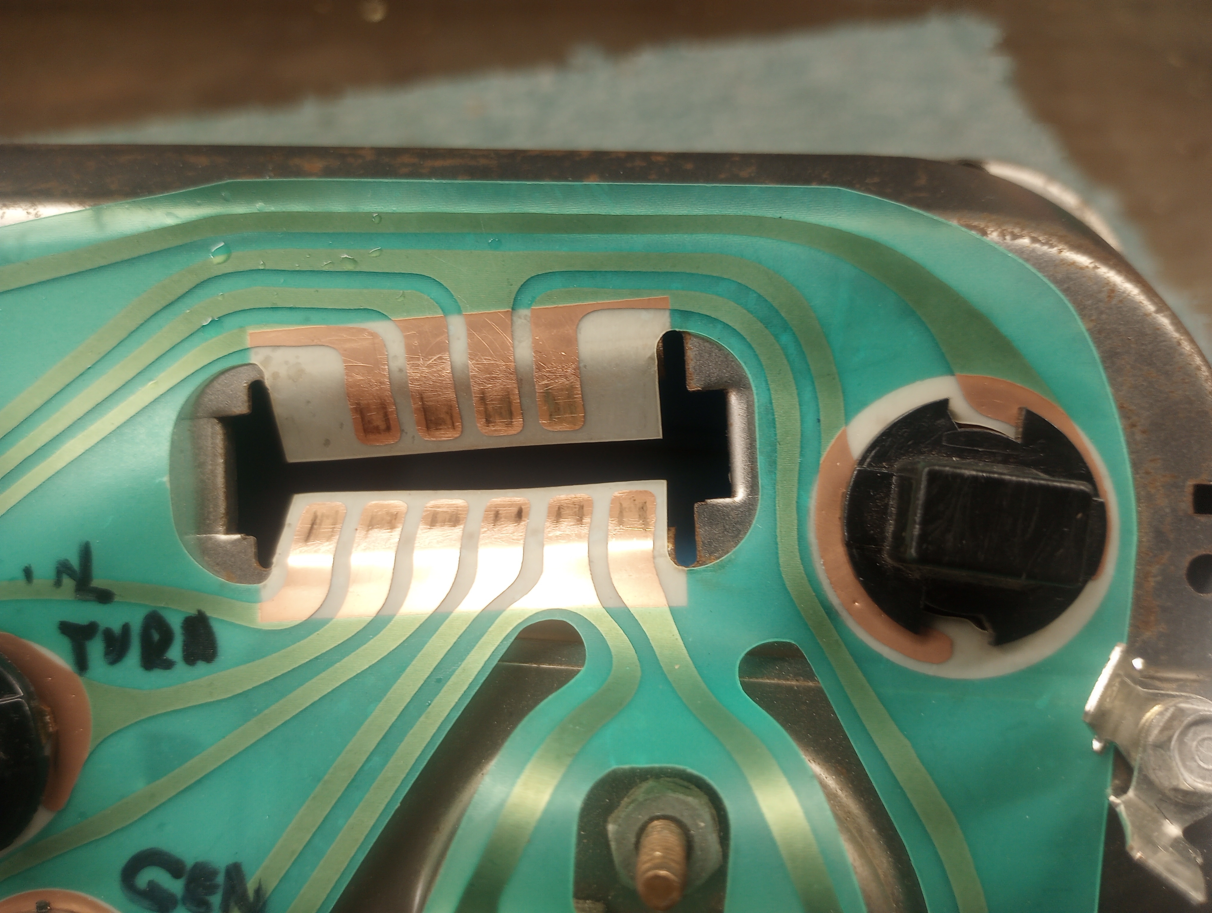

New printed circuit overlay.

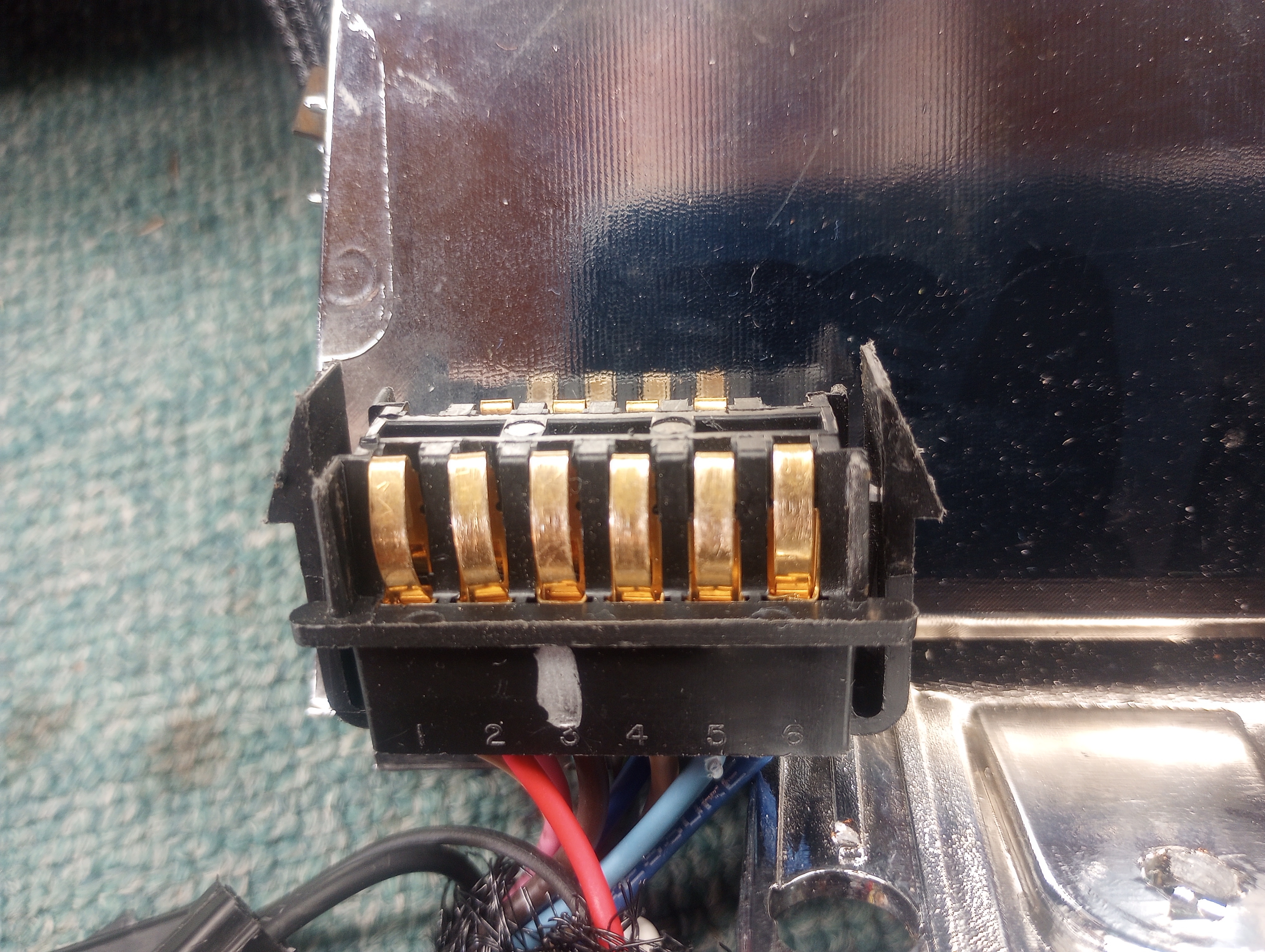

Well, I thought I had everything working when I put the dash back together, and I guess I did, sort of. But, the next time I drove it, I noticed that the left turn indicator and the high beam indicator weren't working. Well fudge! (Not exactly the words I used.)
After a couple more trips, my OCD kicked in and I had to figure out WTF the problem was. Today I pulled the driver's seat out so I could get under the dash to look at the wiring. I was able to get to the connector at the main harness and short connector cable going to the cluster, and power for both those lights was present. More cursing ensued. There is no way to get to the connector that plugs into the cluster to remove it, but using my fiberoptic scope I could see that all the wires were intact and none of the terminals had pulled out of the connector shell.

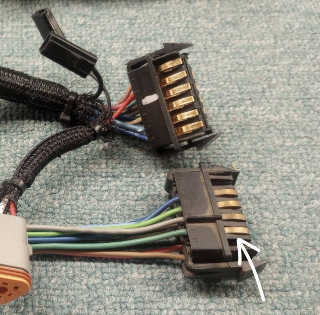

Now, I did check to make sure all the indicators and the fuel gauge worked before I reinstalled it, since I had replaced the plastic printed circuit and just wanted to make absolutely sure everything was working. However, I used the spare connector from the original harness, not the new one that is used in the car. So, after I disassembled the dash, again, with it on the bench, applying power to the connector failed to power the lights. Hmmmmm. Removed the connector from the cluster and when I touched the copper traces going to the indicators, sometimes they would light and sometimes they wouldn't. Although the copper looked clean, and there were marks that the terminals made on them, there was some coating or something else preventing a good connection. I plugged in the test plug, and all the indicators worked. plugged in the new connector and LT and HB didn't. I took a piece of emery cloth and polished up the traces on the printed circuit, also polished the terminals on the connector, and tweaked the terminals a little to ensure good contact whe installed. Now, everything works again. I wouldn't have believed it unless I saw in for myself, but that was the problem.
So, tomorrow, I'll put it back together, again. Hopefully for the last time. Shouldn't take too long, I have it down to a science now.

IMG_3799.jpeg get this and put a small amount on the connections
Eliminates the “fretting “ on pin and circut board Contacts

I have a can of Deoxit, I thought about using it, so I will take it to the shop today and give the connectors a spritz before I reinstall them.
Thanks for the suggestion, though.

Regular Deoxit is a cleaner and helps, the Deoxit Gold is a enhancer that improves the connection between contacts, its not cheap though

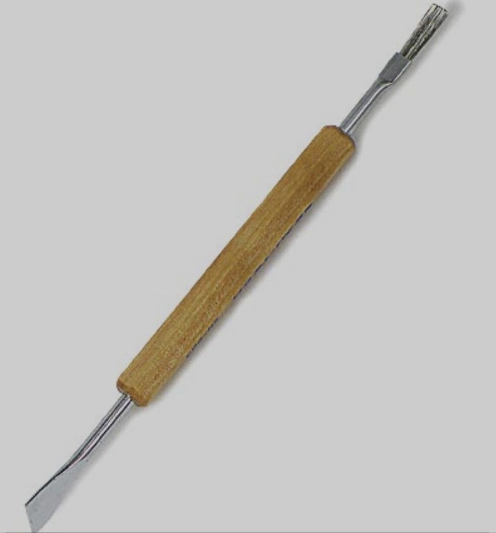

I used a tool like this a lot as an electronic technician. The chisel end to gently pry connector tabs up a little & wire brush to clean. Over time connector tabs lose tension and become corroded.
Contact cleaner spray is good afterwards.
