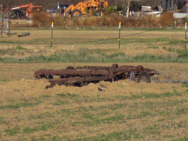

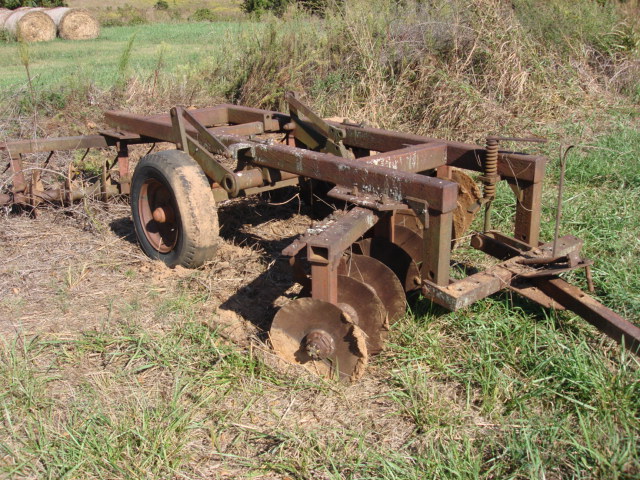

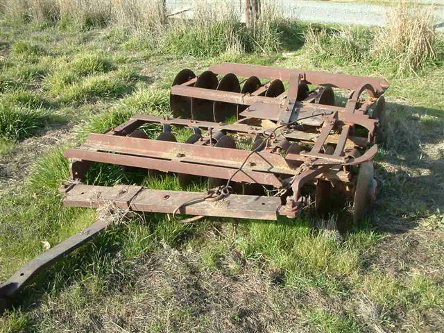

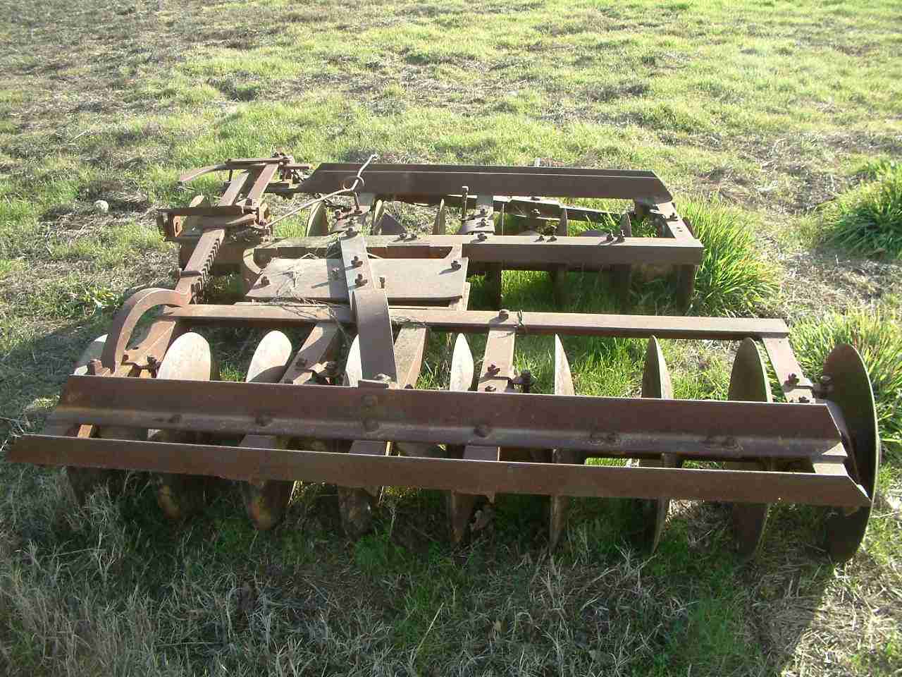

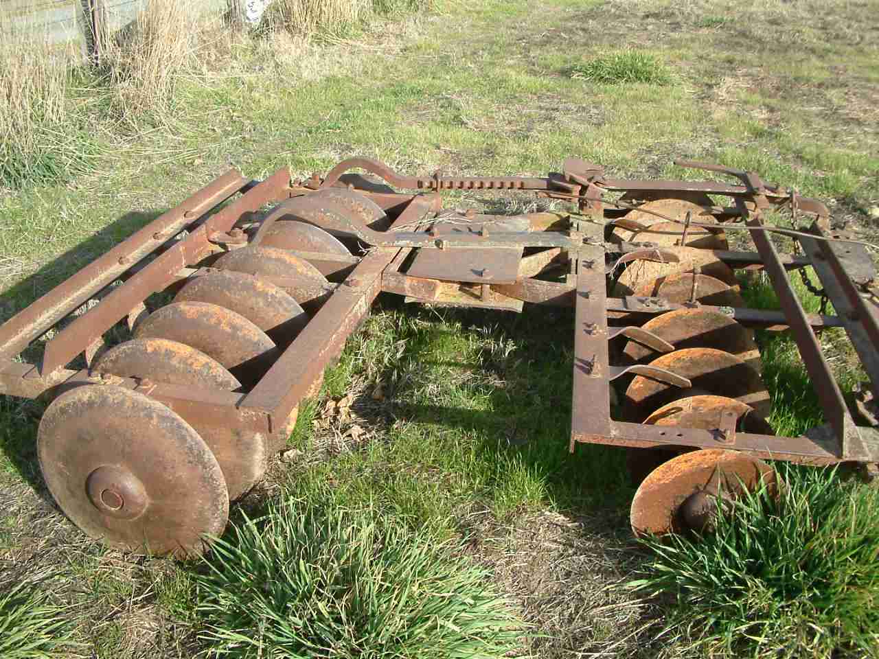

Here's an update. Got the Athens harrow disassembled and ready to sand blast and paint. Have new 24" smooth blades and new bearings ready to install. All is going well and it should be like new when it is finished. I expect to have about $2000 in its restoration, so probably not a bad price for a disc like this. I tend to get carried away in my restorations, and just can't do anything 1/2 way. Getting the bearings out got easier as I got experienced, and pressure washing helped a lot to get the decades old grit out of the bearing holders. All in all it is in very good shape. I can't believe how heavy it is compared to the Leinbach 20" x 20 3 point disc I have been using. I hope my tractor will pull this adequately! Here are some pix awaiting the blaster.

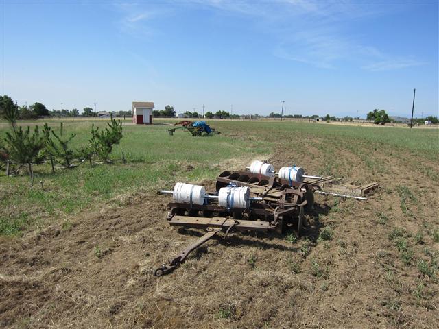

Here's my old 6.5 ft Towner offset disc (18 pans, 20" size). I get it going OK with my 55 hp 2WD Mahindra 5525 when I till my hayfield in Oct when it's pretty dry after 4 months of frequent triple digit summer temps.
In soft soil, I've been known to get this disc stuck pretty good. Then I have to chain it to the FEL bucket and lift it out.

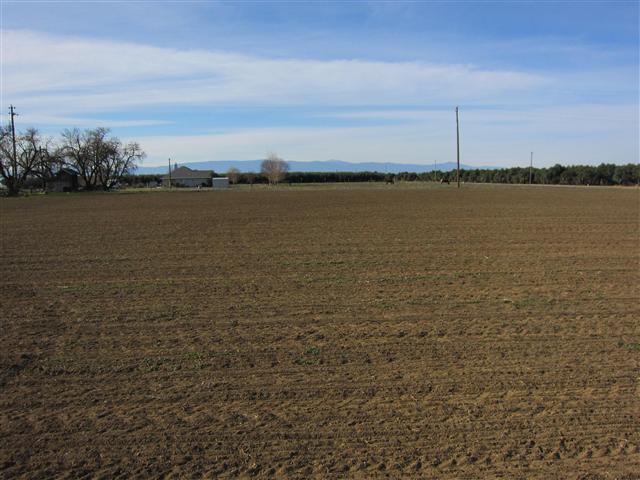

All in all, that old Towner does a pretty good job. This field was planted a few weeks ago with Austrian winter peas (plowed with the Towner plus a drag, seeded and then finished with my 10-ft cultipacker).

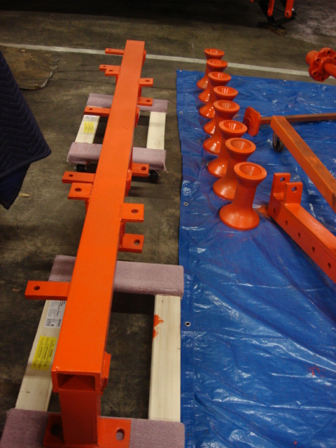

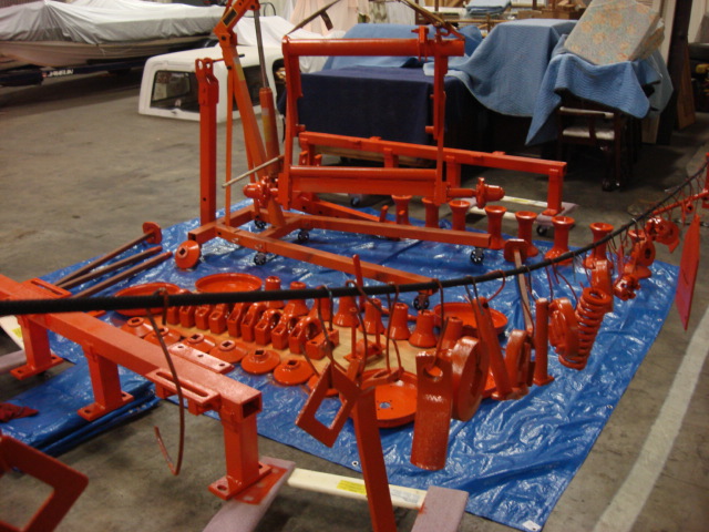

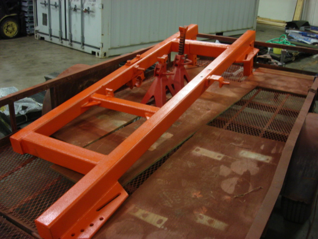

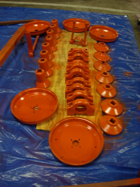

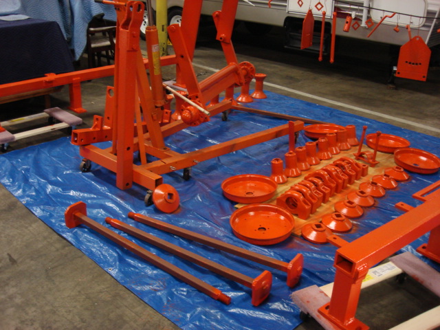

I've been hard at work getting this old disc restored. I sandblasted it and primed and painted it Allis Chalmers orange. It's now ready to reassemble! Got new 24" smooth 1/4" discs, new bearings, new hydraulics, new wheels and tires, fasteners, and fabricated several new steel parts that were broken. I also welded repairs on the tongue, and plan to repair the scrapers. Removing the bearings from the housings gave me fits, and now in retrospect, I probably could have not been so careful to salvage those. I broke one in my learning curve, but last night, after carefully cleaning them and placing new bearings, I discovered the new bearings were very loose in several of the housings, so loose, that the shaft would spin the whole bearing in the housing, not spinning internally as necessary. I conclude that the disc was used with bad or locked up bearings, resulting in extreme wear in the internal surface of the housing as the whole bearing spun in it. This system is dependent on a tight leakproof fit, which is necessary to be able to inject grease into the fittings. The loose fit interupts the pathway grease follows from the grease fitting to the balls. So unfortunately, I am having to replace 3 or 4 more housings (at $86 each). But at this point, I have no choice, so I am over budget at $2000 plus (I don't want to add it up!) But even so, when done, this will be like new and new discs like this are over 10 grand new. Athens Plow is even sending me some new decals for free!
