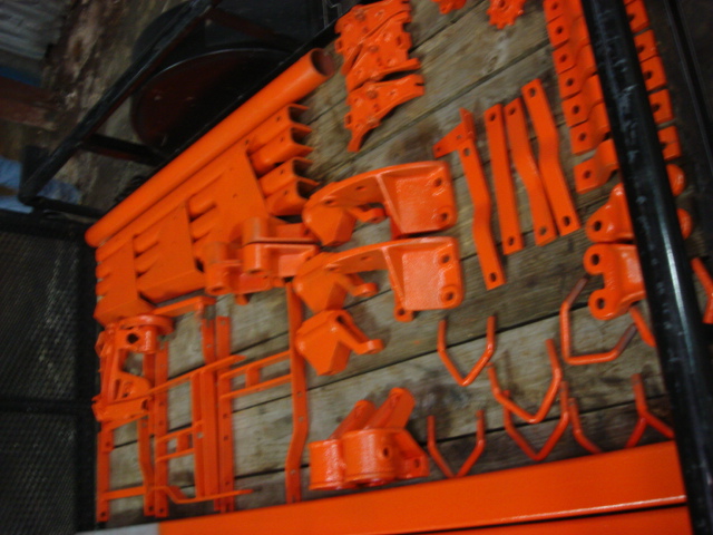

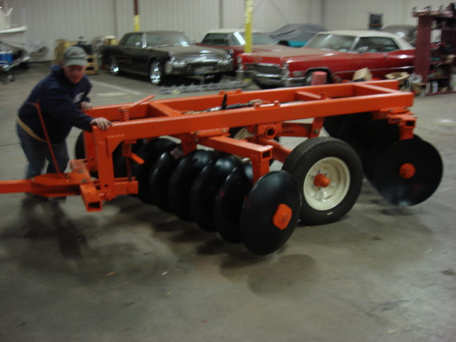

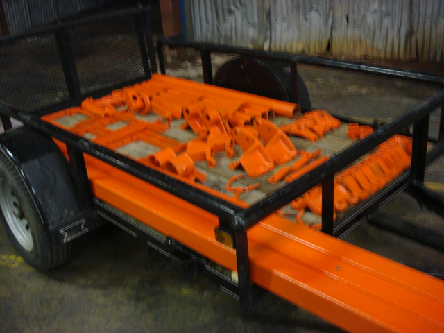

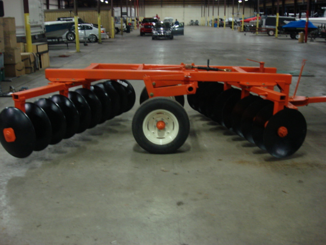

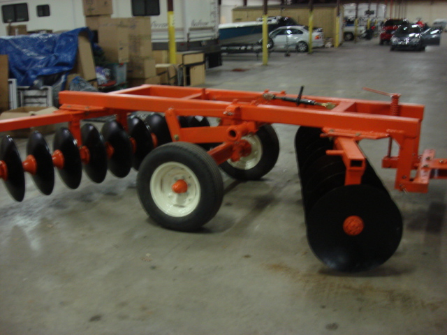

I've been hard at work getting this old disc restored. I sandblasted it and primed and painted it Allis Chalmers orange...... !
"Allis Chalmers orange" is actually "Persian orange" if you ever have to ask for it at the counter....BobG in VA
   / Restoration of an old Athens Offset Harrrow
#33
Thanks. I never want to see any more orange paint. I have been spraying all week, both this disc and a 4 row AC planter that I am also restoring. I took the planter completely apart, so there were about a zillion parts to spray.

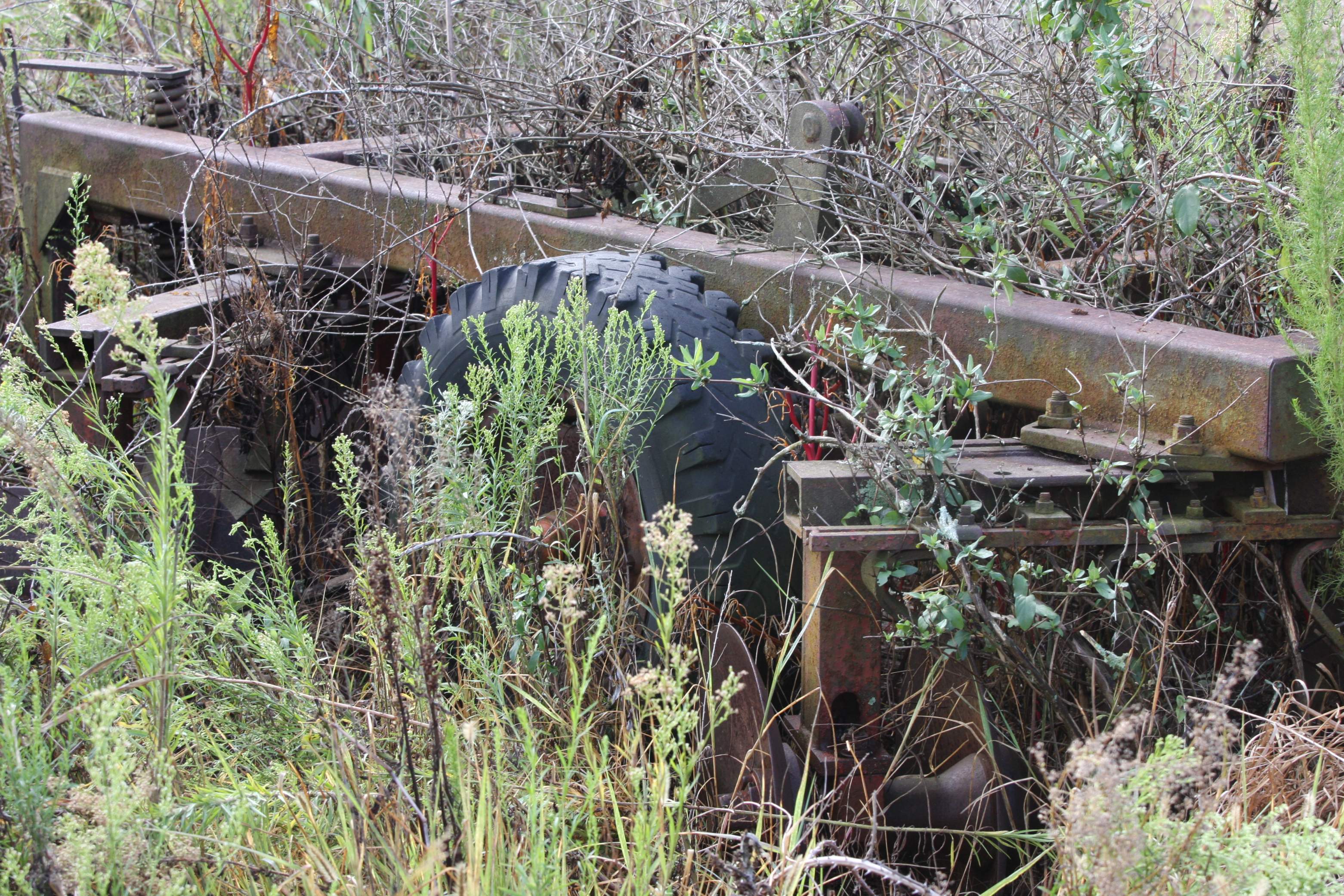

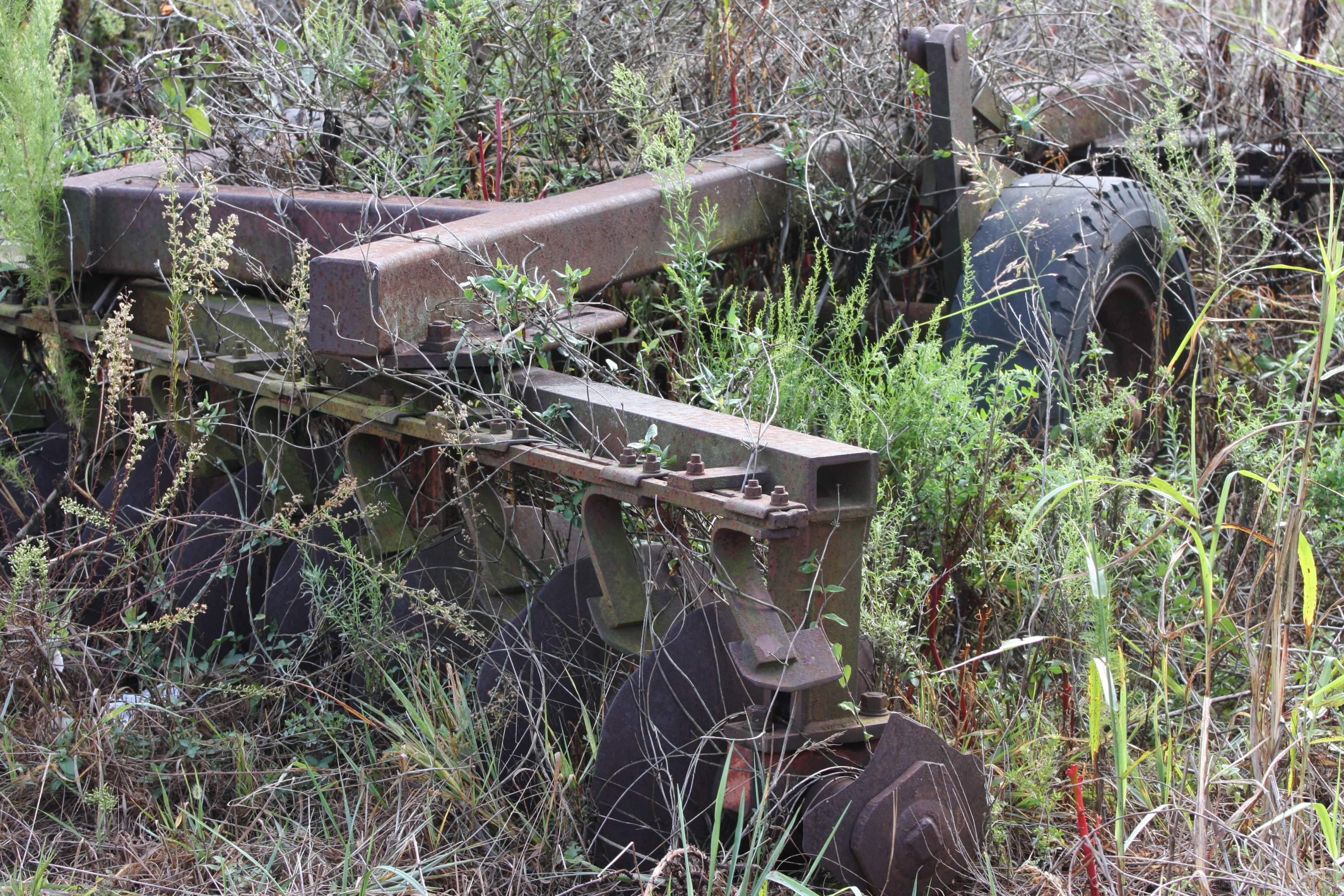

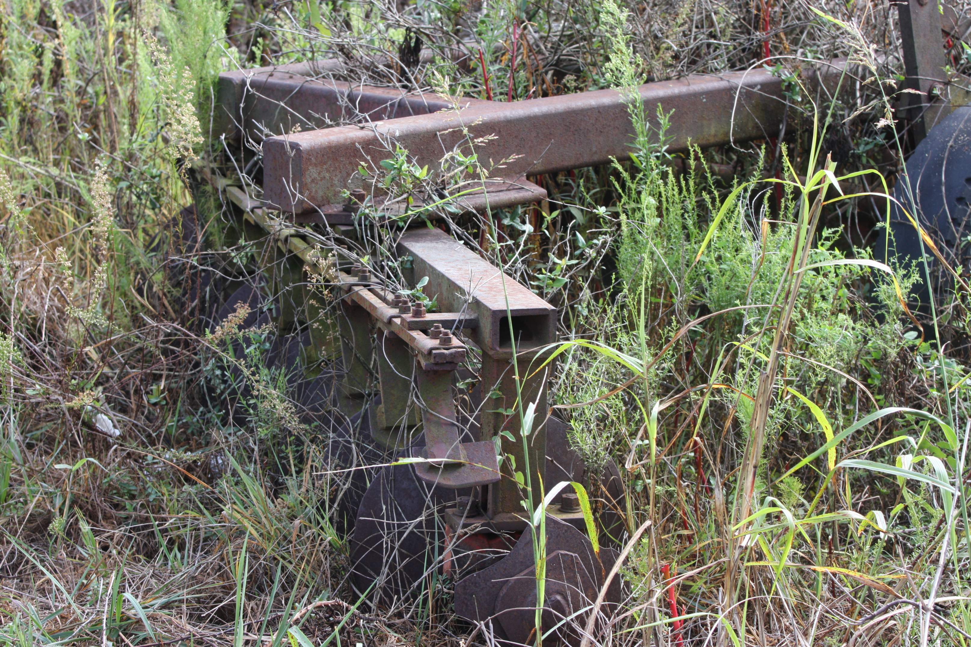

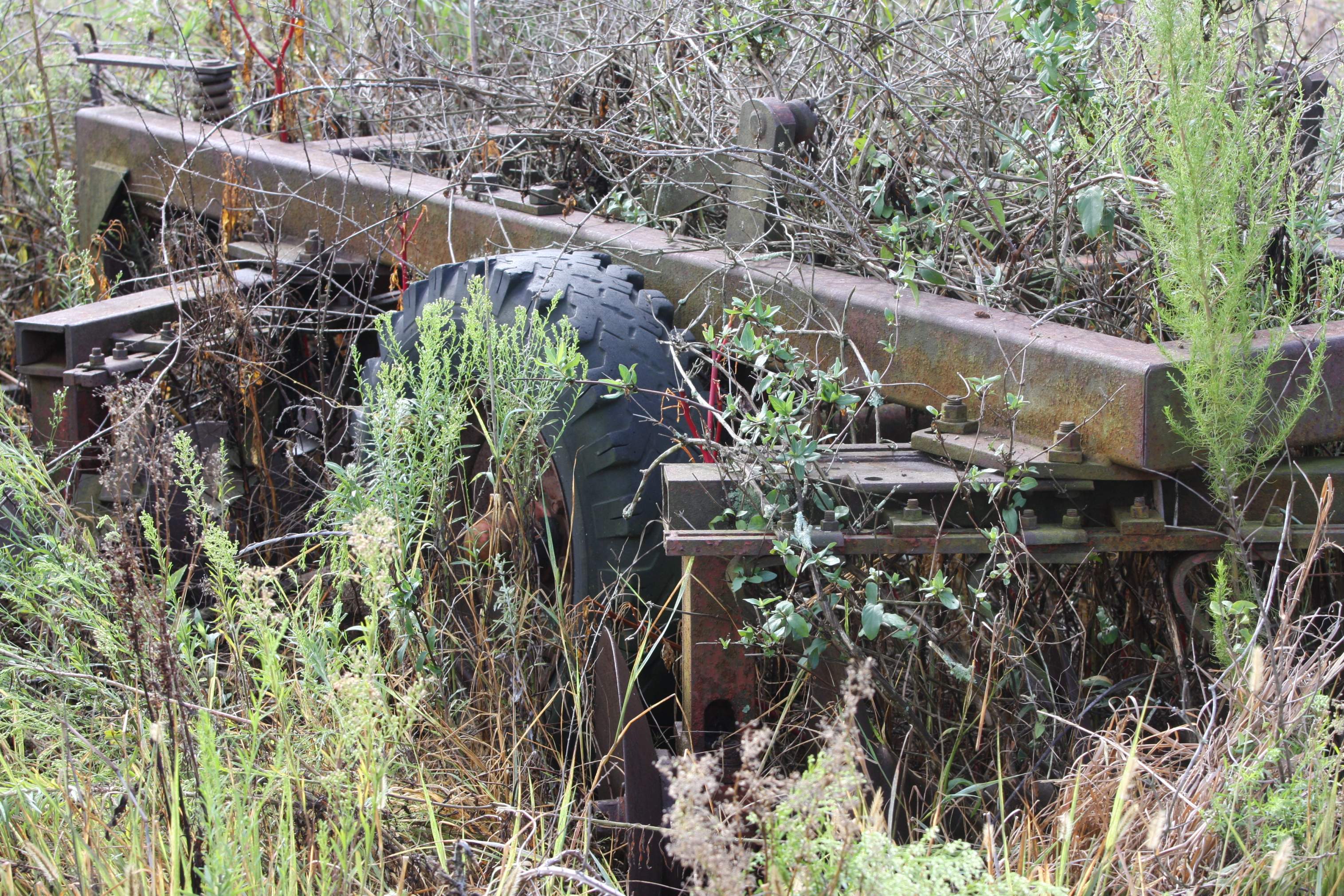

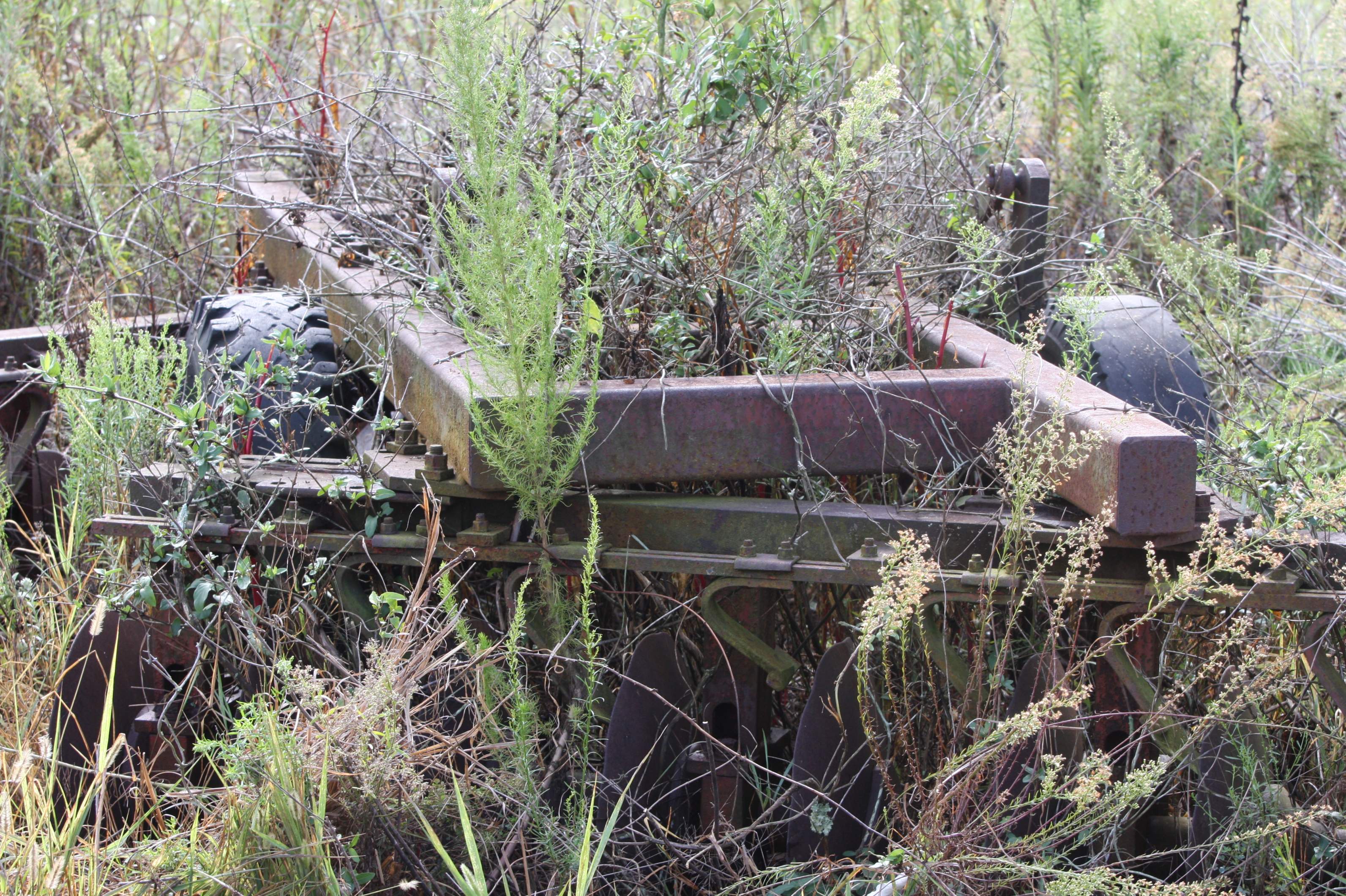

By the way, this is what it looked like where it sat for 20 years in a briar patch. I have not quite finished it, still have to add new decals and decide on the scrapers, but it is close. Can't wait to see if my tractor will pull it.
