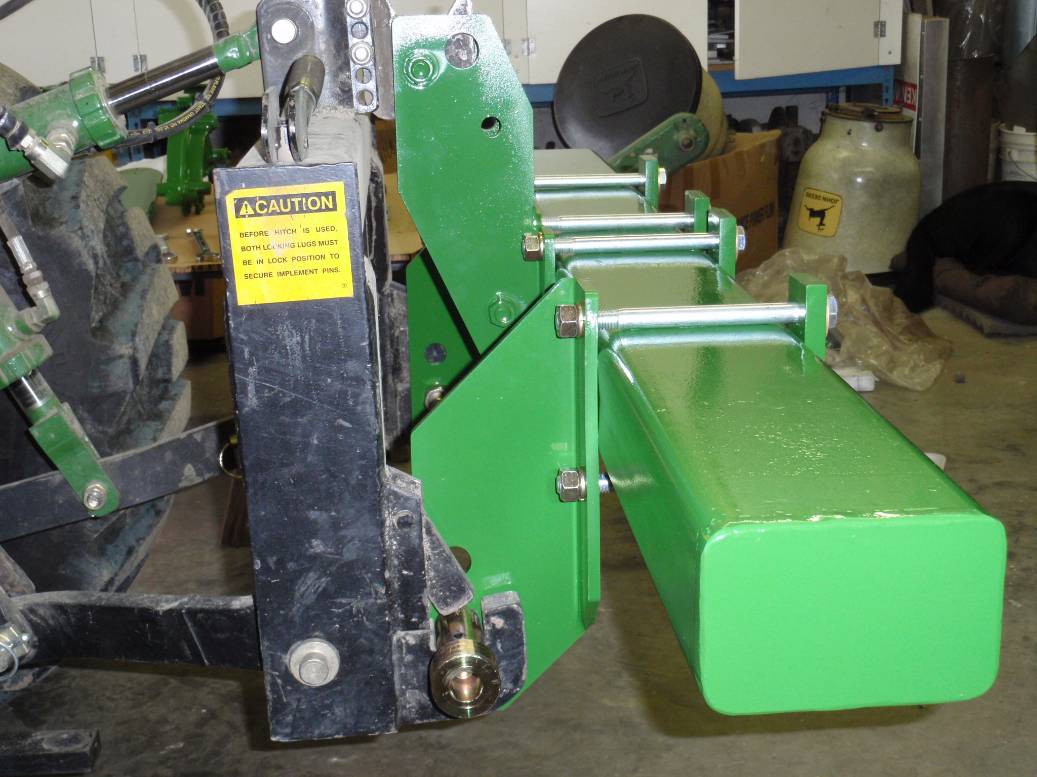

Another view of brackets, as requested.
   / Restoring a couple of JD 71 planter units to new condition. #22
Remarkable job and remarkable documentation. Great job.
So how well does it work and any commentary on how well you like or don't like it?
